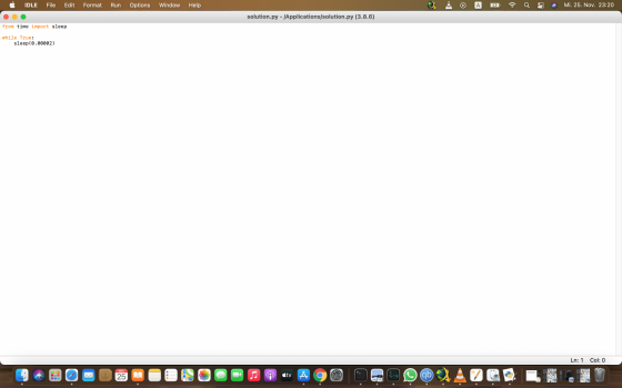

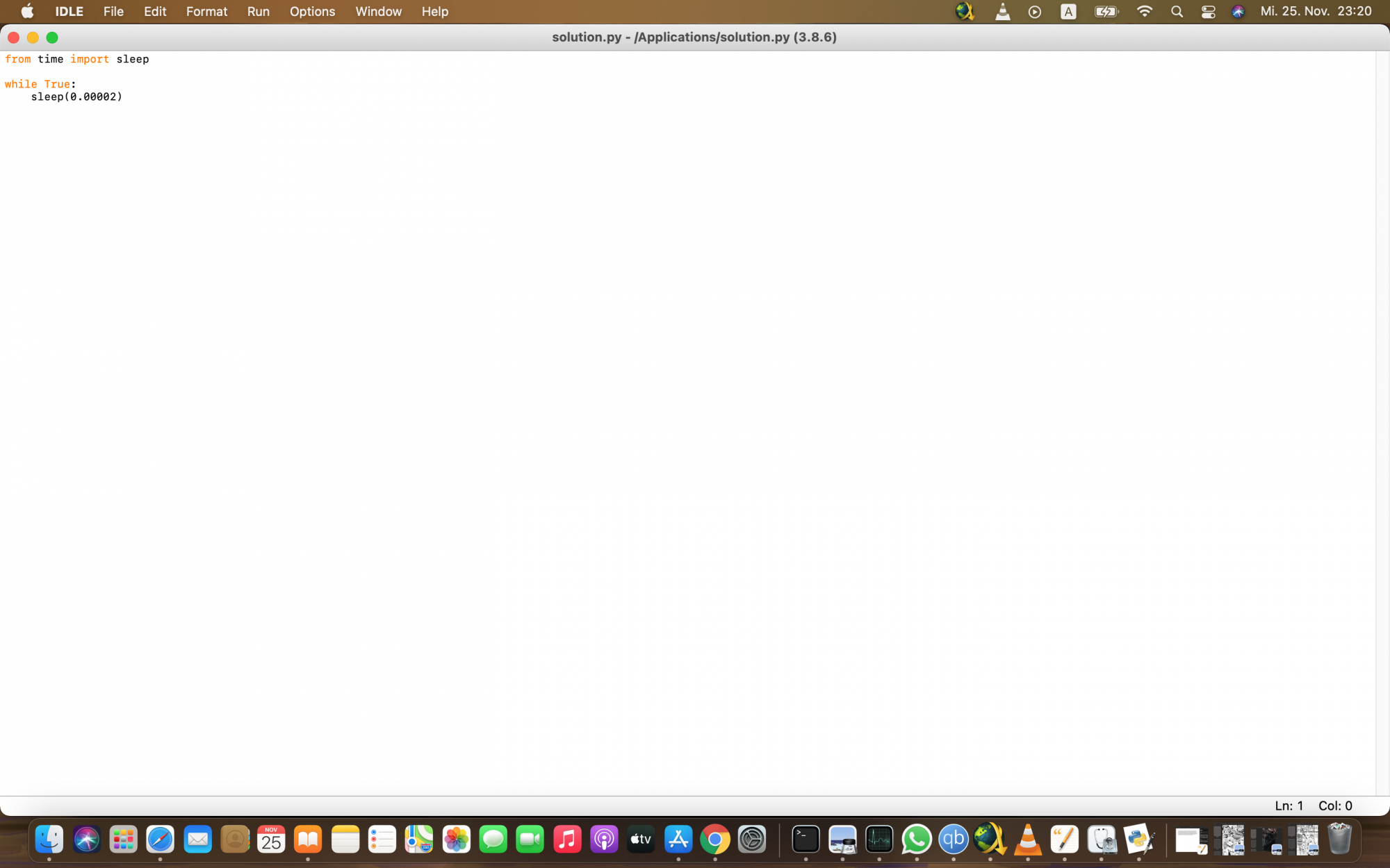

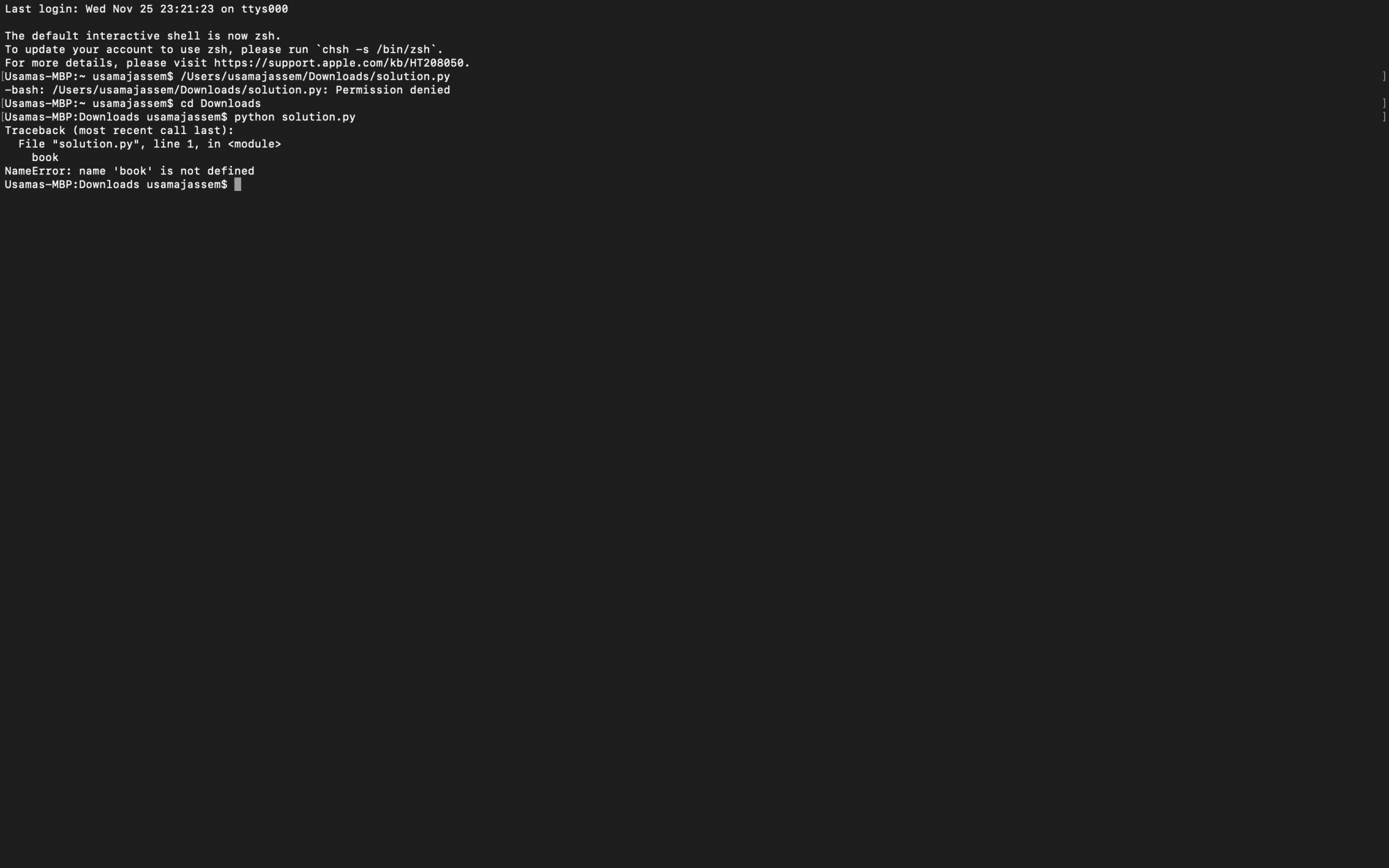

Guys how do I run the python script? Tried it with my terminal but I am getting a message (see attachment).
At first I just tried dragging the script into the terminal but wouldn't run. Then with commands still nothing.
Do I need to type something for "time" and "import" in line 1? If yes what?

Yeah without the space I am getting "unknown special file or file system /Volumes/Kaladin."
DO I need to use Kaladin - Data? If yes how?
1. Open Terminal
2. Enter python
3.
Enter import time
4. Press Enter
5. Enter:
while True:
time.sleep(0.00002)
6. Press TAB key one time
7. Press Enter

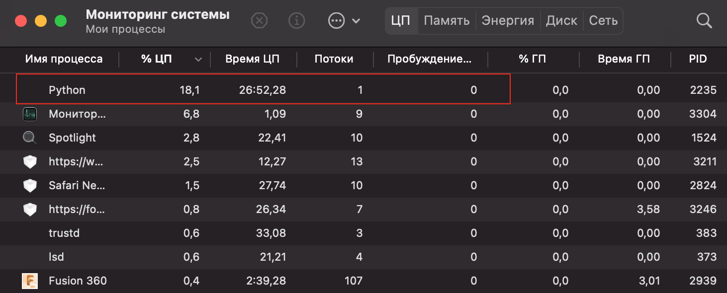

Minimize terminal and proceed working. Repeat this every time your reboot your mac. To control working of the script use Monitor. Look at the screenshot I attached.
I made this thing now too... Few hours no reboot, but later will see...

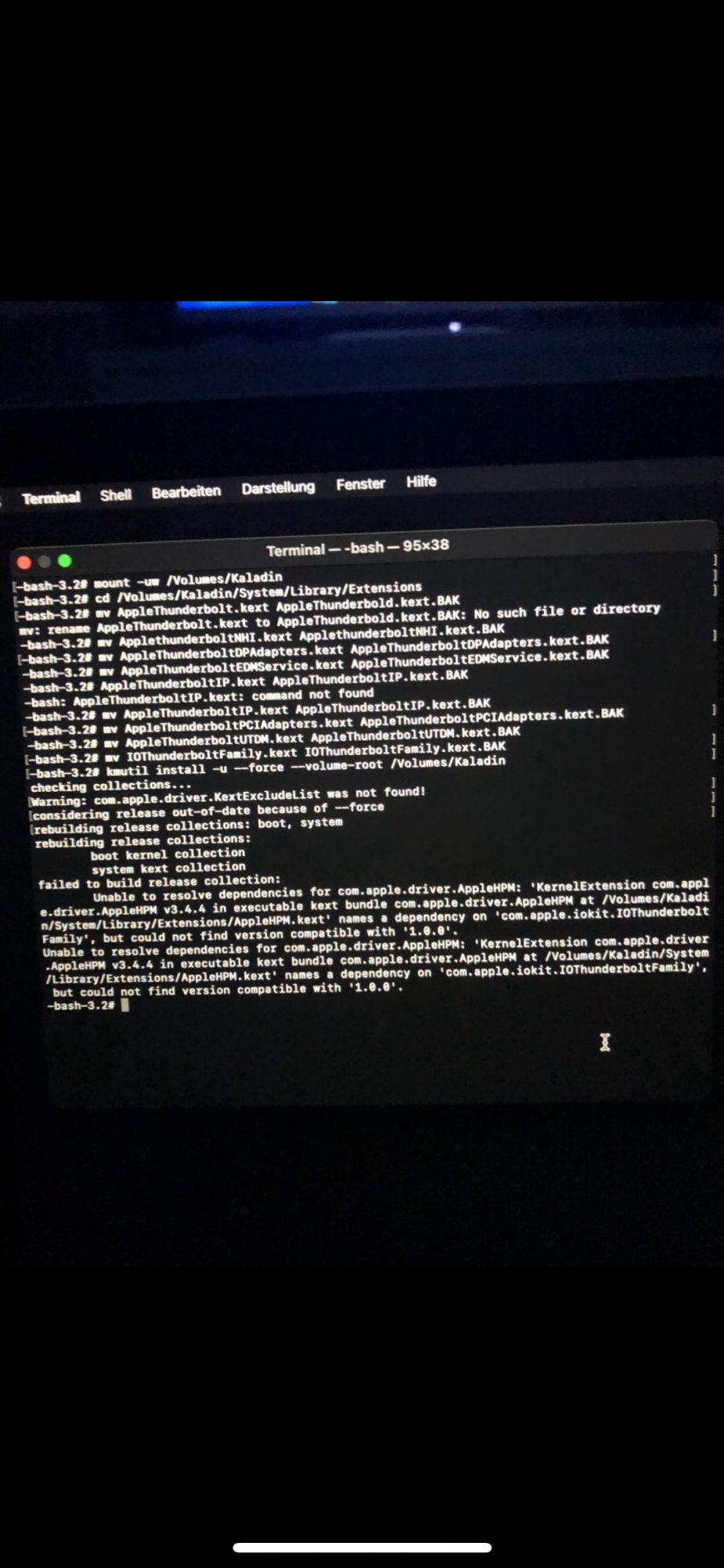

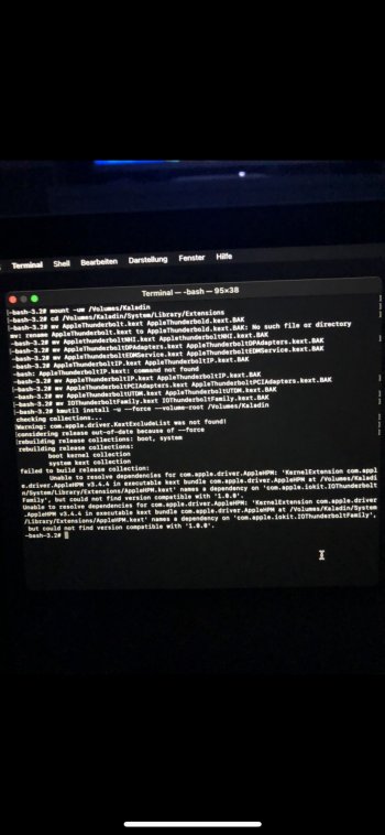

Here, up until kmutil everything worked, after that I don't really know ;(

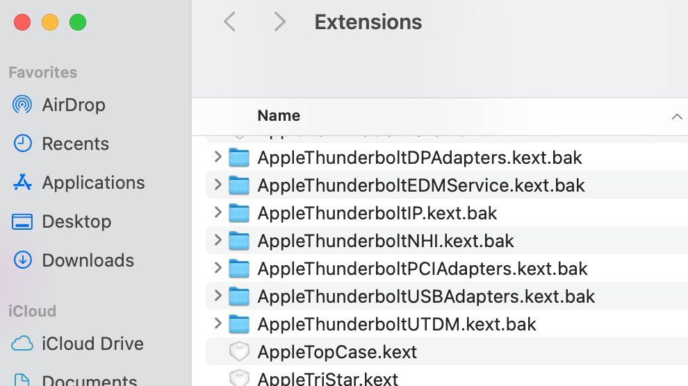

You are not following the tutorial, you renamed IOThunderboltFamily:
mv AllThunderboltKexts.kext AllThunderboltKexts.kext.bak (Except IOThunderboltFamily.kext)

Please, read all the related posts before doing anything, csrutil must not be enabled after applying the fix.
Approved!
Friends, just make everything that Naguzmans told! It's work! 5 hours on Big Sur on MP Pro 2014, 15". No shutdowns. The same work the day before without renaming Kexts was about 8 black screens.
Thanks to Naguzmans for this tip!
Reactions: nol2001
Did manage with disabling authenticated and rebooting, everything runs again. Still thank you. That IOThunderBolt renaming should't cause problems right? Or can I change just that one back?
You need to use mv command for everything this:
And don't touch IO at all!
