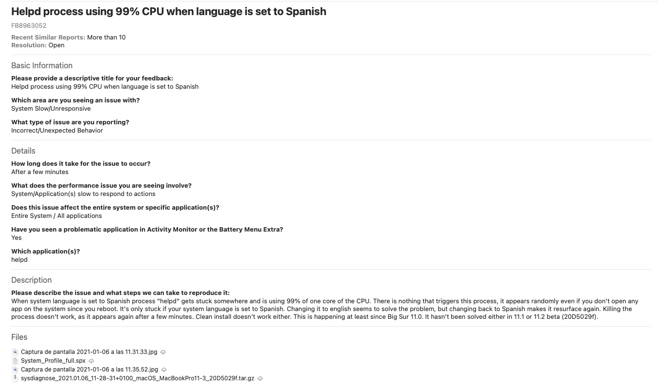

No solution thus far, lets hope next Big Sur update solves the problem.
It doesn't. I'm on the 11.2 beta (20D5029f) and the problem is still there. I have reported it in the Feedback Assistant and it says "Similar reports:more than 10. Resolution: Open."

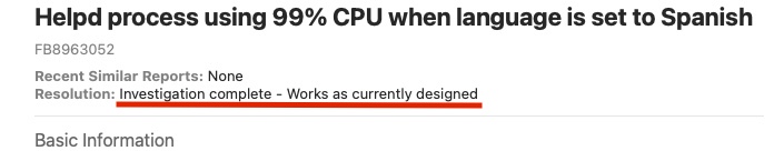

germanyague
macrumors newbie
May 7, 2016
4

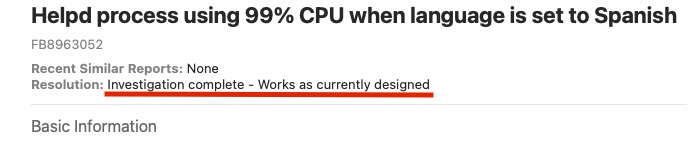

I don't understand if they've fixed something or if they haven't found any errors, but it says now:
Investigation complete - Works as currently designed.
  • Angry
Reactions: Populus

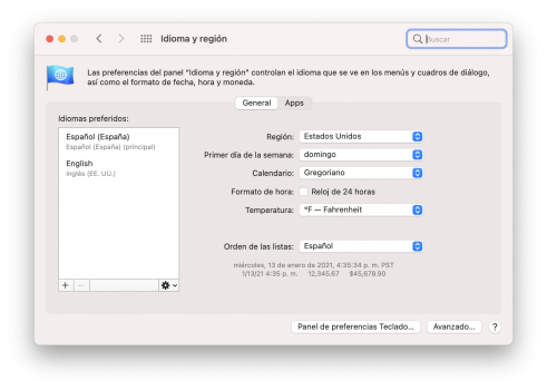

I updated my feedback report, which still shows Open/Similar None. They just aren't looking closely enough.
"Still fails in newest release macOS 11.2 RC 20D53. This only occurs using SPAIN SPANISH, other dialects work fine. Pay close attention to the screen shot included with System Preferences / Language & Region."
Hopefully this spells it out

germanyague
macrumors newbie
May 7, 2016
4
I must say. I'm currently on 11.2 (20D53) and after 24h the problem hasn't surfaced again. Seems fixed for me, but I'll keep an eye on it.
UPDATE 27/1/2021: Nop, still there. I've opened another ticket in Feedback Assistant with number FB8981644, this time specifying that is Spanish Spain and attaching everything I could think of. Meanwhile... Español latinoamericano it is.

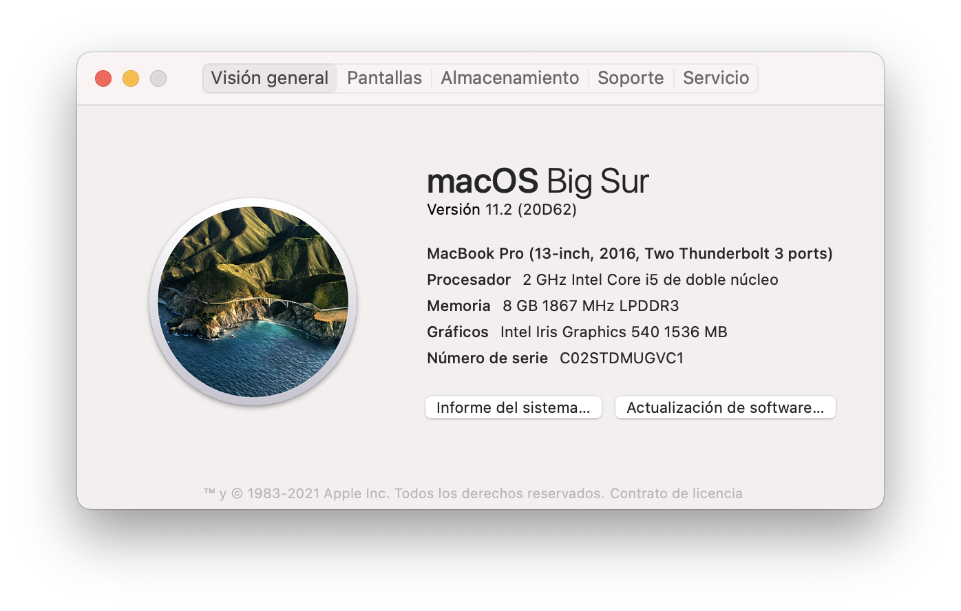

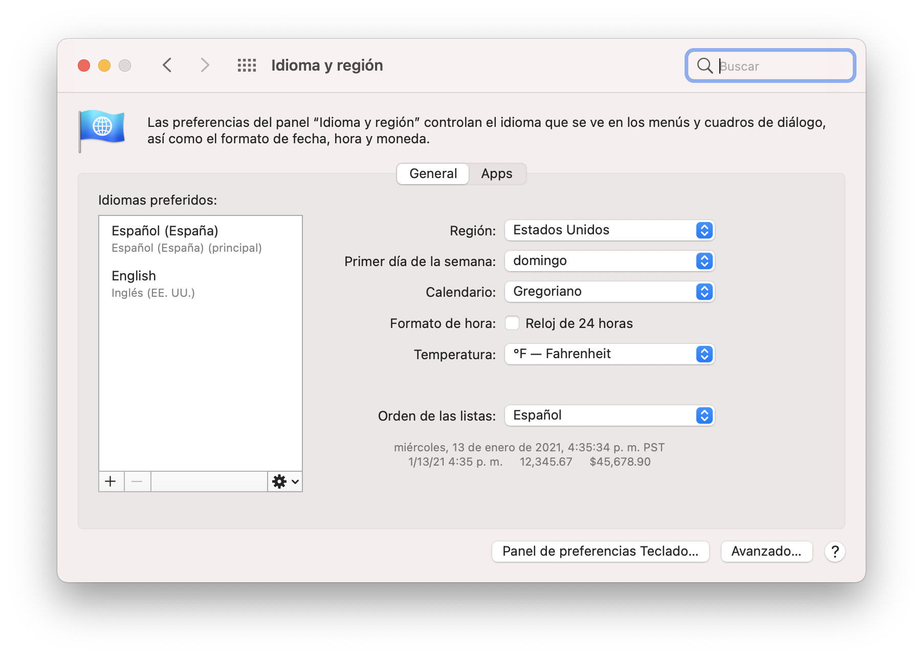

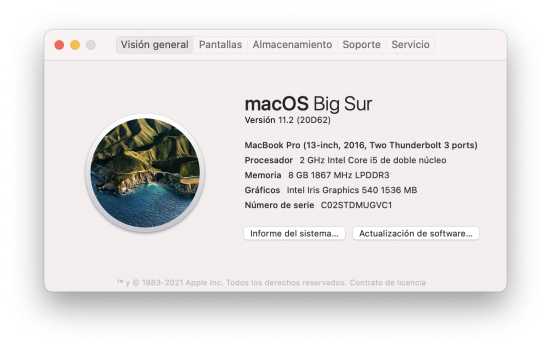

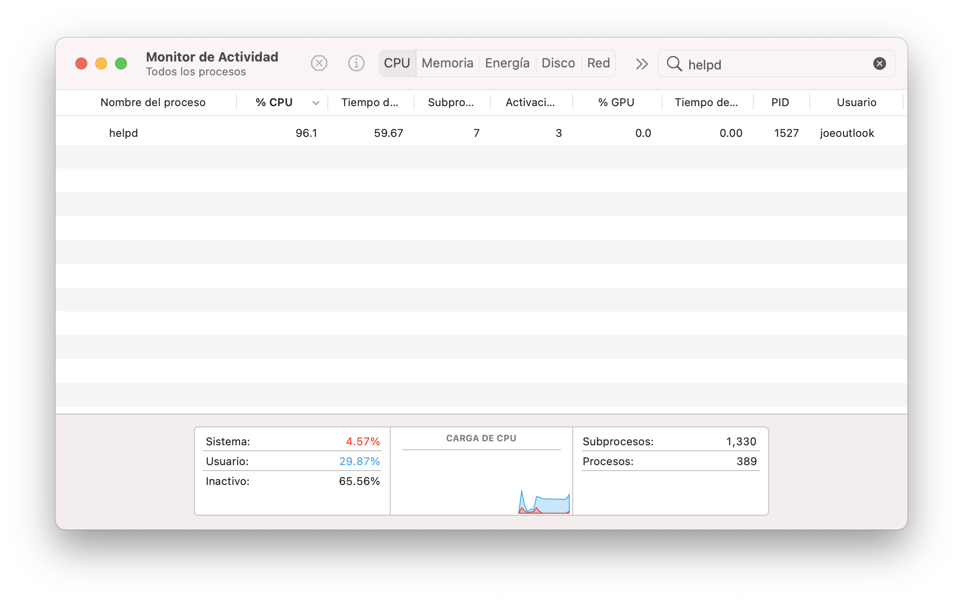

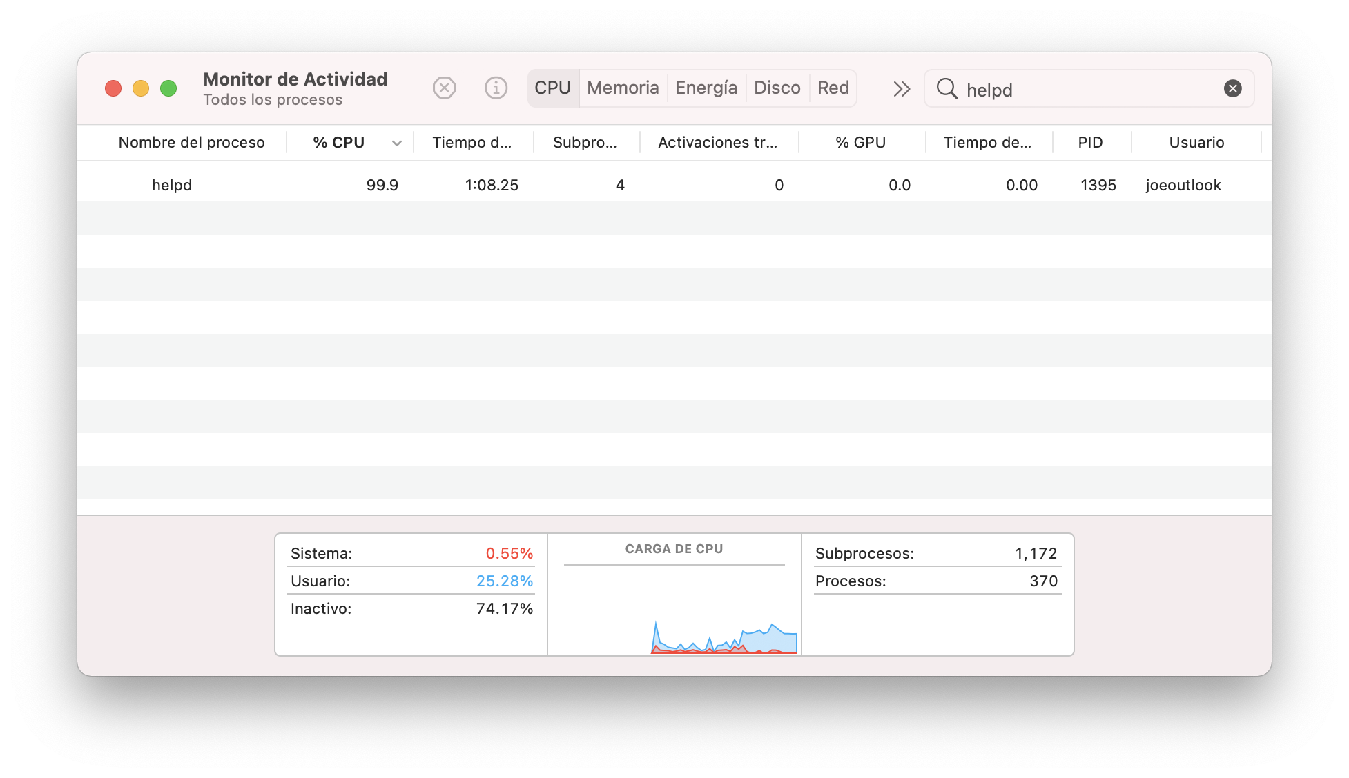

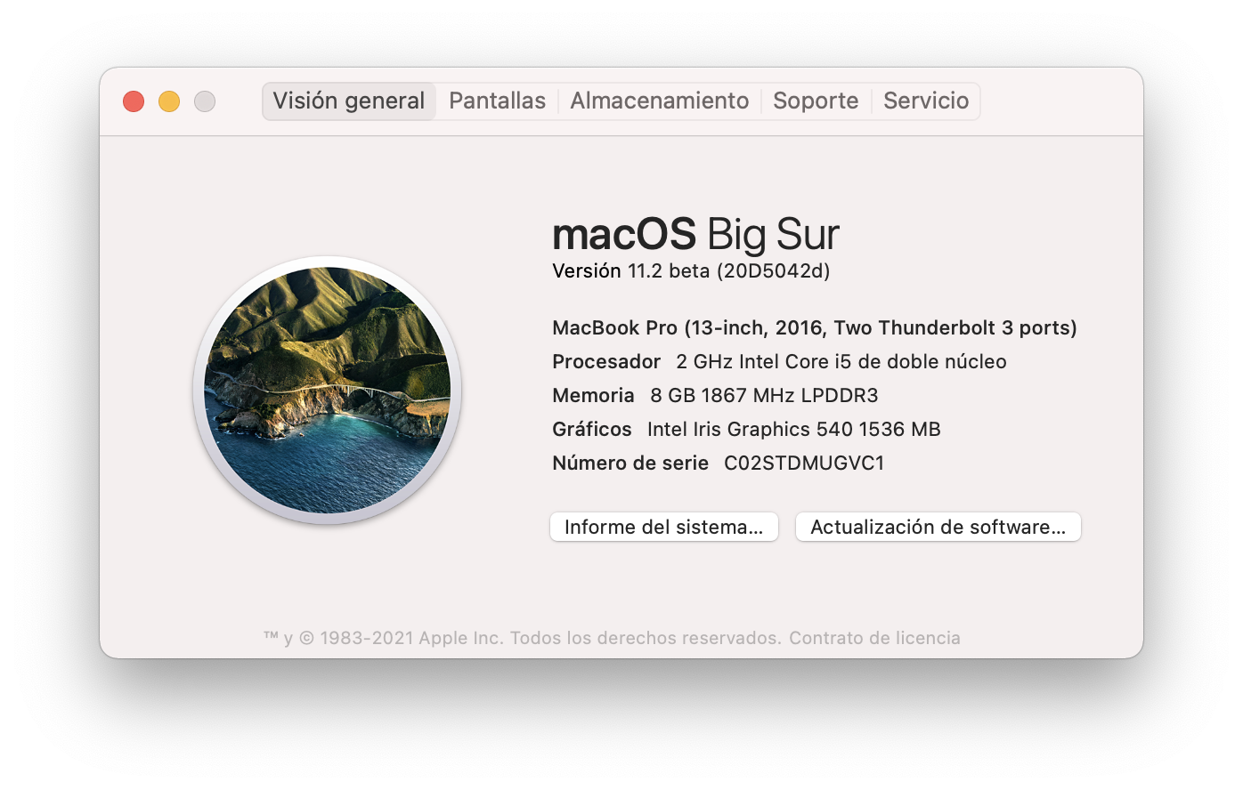

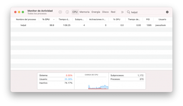

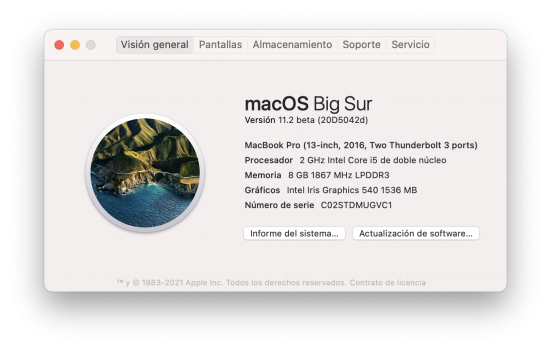

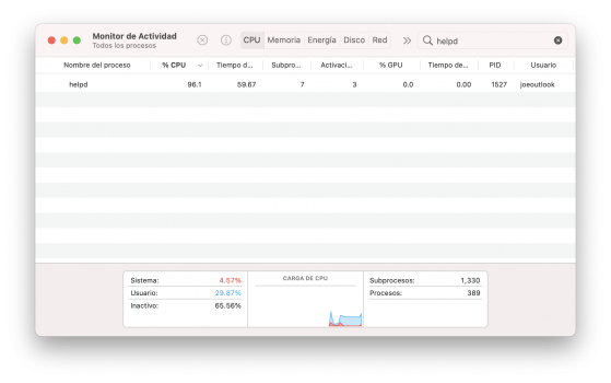

Anyone with the RC2 can see if this is still happening, even if you have to trigger it using the Help menu? Thank you.
I am currently installing RC2, I'll attach screen shots shortly. Hope for the best.
Not fixed. I did invoke Help to start helpd, after exiting help, I snapped the following.
Captura de pantalla 2021-01-25 a las 2.16.57 p. m..png Captura de pantalla 2021-01-25 a las 2.17.32 p. m..png Captura de pantalla 2021-01-25 a las 2.19.19 p. m..png
