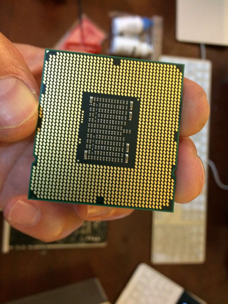

It is possible that the pins can be damaged while the CPU is out.

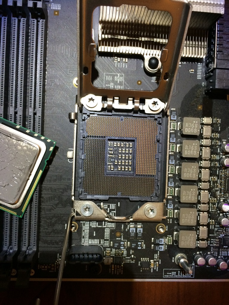

No luck...
Took the whole thing apart, check CPU and socket for damage, couldn't find any...
Put it back together, but the compute still thinks memory slot 1 is empty...
No bueno...
[doublepost=1487715919][/doublepost]Should I drop the W3520 (quad) back in to see if that one does detect slot 1?
The W3680 is a used CPU from StarMicro, could it be faulty?
Yes both the CPU and socket look good to me.
