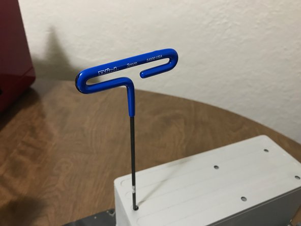

Sorry for digging up such an old thread, but I'm having issues with removing the left hand hex screw: It doesn't seem to be a 3mm?! All four others came out without problems. I even bought a new 3mm allen key in case it was just a bit rounded. The screw head looks fine and I haven't removed any of the screws before, so it's not rounded. Could it be an imperial hex head? Seems odd if all others are 3mm metric.
PjIF3ulAXeyAfP12.medium
it's a 3mm allen/hex head. be assured you have the right tool! getting the wrench into the bolt head can sometimes be a pain though and perhaps what some of your frustration may be? I used a flashlight to shine in and see the bolts better on the ones that it could help. I want to say that one in the photo is easily seen this way.
This is so weird! I've shone a light across and can clearly see the 3mm hex key freely spinning. All other four screws are absolutely fine. I'm really baffled. I haven't got a long enough 3.5mm key but will try that next.
