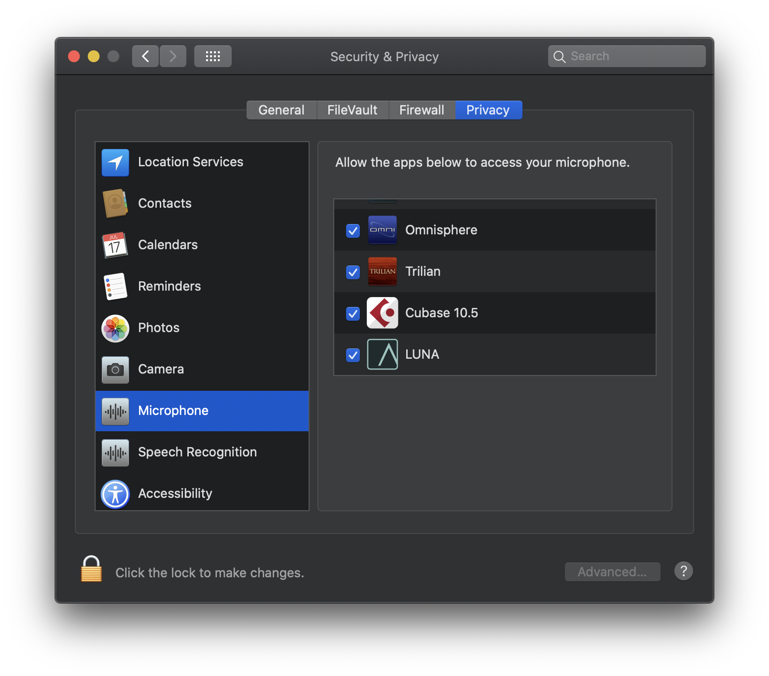

Just a thought - have you granted permission for your audio apps to use the Microphone? This is a requirement in Catalina - I'm wondering if that might fix your audio issue and the whole Highpoint thing might be a red herring. See screenshot below - you will need to click the padlock icon and enter your password to make changes.
I didn't know LUNA was available for download already! Thanks for that screenshot!
That was the trigger for the suggestion actually - when I installed Luna it asked me to grant permission for the microphone, which set me wondering... :)

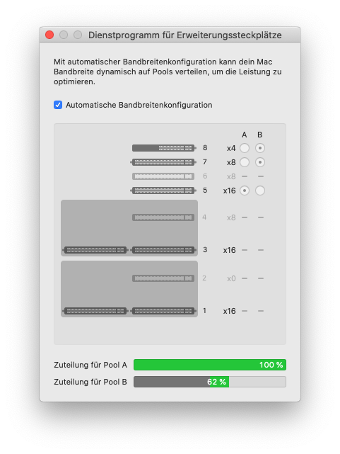

thanks for the information. But unfortunately I can only operate the HP in slot 5 because I have installed two 5700 MPX modules. Would the card also work in slot 6 there only x8?
Why not use the Expansion Slot Utility on MacOS and change slot 5 to use Pool A? That fixes the issue. The details on how to do that are right in the OWC article that was shared.

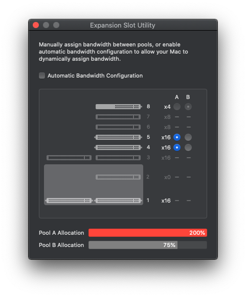

Just checking, have you tried just disabling sleep or changing the pool allocation of the card? I have two Mac Pro 7,1's both with the HighPoint 7101A cards, and not a single problem with either. In both cases I have the card in slot 5 and in both it's allocated to Pool A. Zero issues since late December 2019.
This is my current setting, which is less than ideal, since both Sonnet m.2 4x4 are overloading Pool A, but this allows me to avoid the panic-while-sleep issue. As long as I don't copy from one Sonnet to the other Sonnet, I am getting the speeds I expect, so it's workable for now.

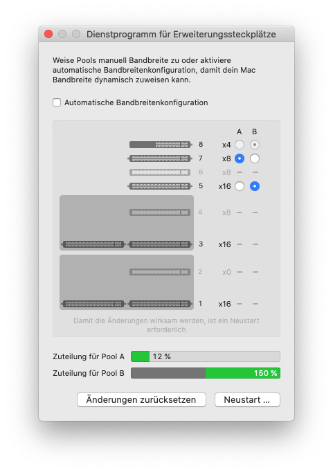

Even if I set my settings to pool B, I still have the panic error. Had even now removed an MPX module and operated the HP in slot 3. I also get the panic error here. I don't know. Wonder if another raid card (e.g. Sonnet) doesn't worry the same ...?
Sonnet uses the exactly same Broadcom PLX PEX 8747 PCIe switch and have the same problems waking from sleep.
OWC card uses a different one, ASMedia ASM2824, and still have the same problems.
It's a Mac Pro problem.

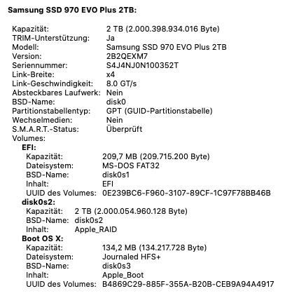

Hello, I have also installed a new Highpoint SSD7101A-1 card with four Samsung 970 EVO Plus for my MP 7.1. Again and again it is restarted because of a problem.
What is your Samsung 970 evo Plus's Firmware version ?
Look in " About This Mac"/ System info/NVMExpress/
