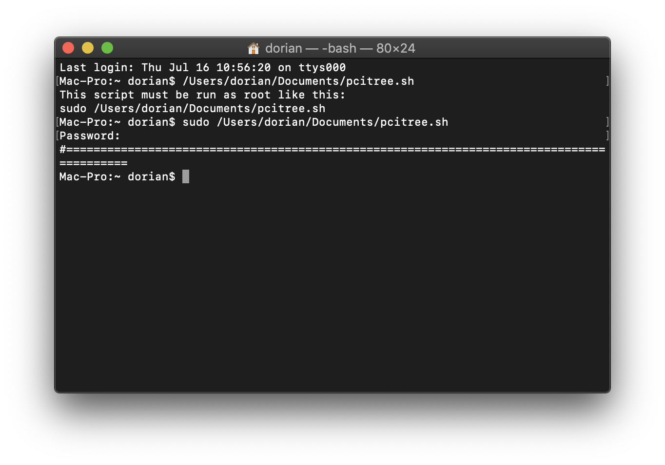

I tried and kept getting errors in terminal so i was never able to generate the pctree.sh thing (if that’s what it’s called). I’ll try again

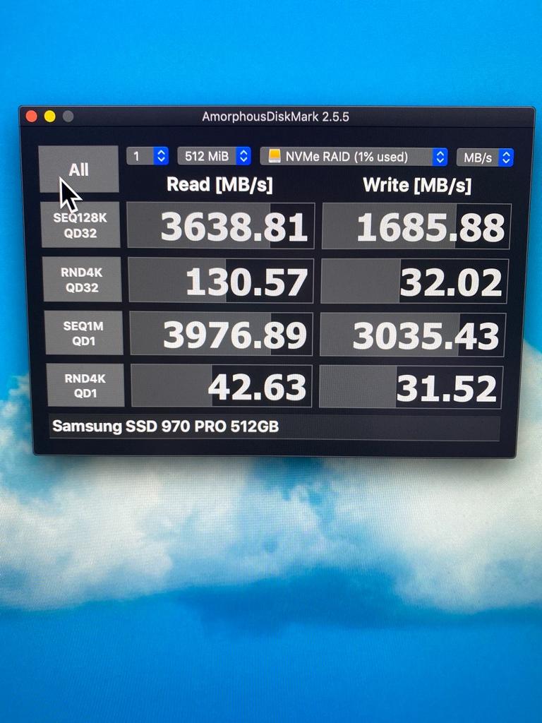

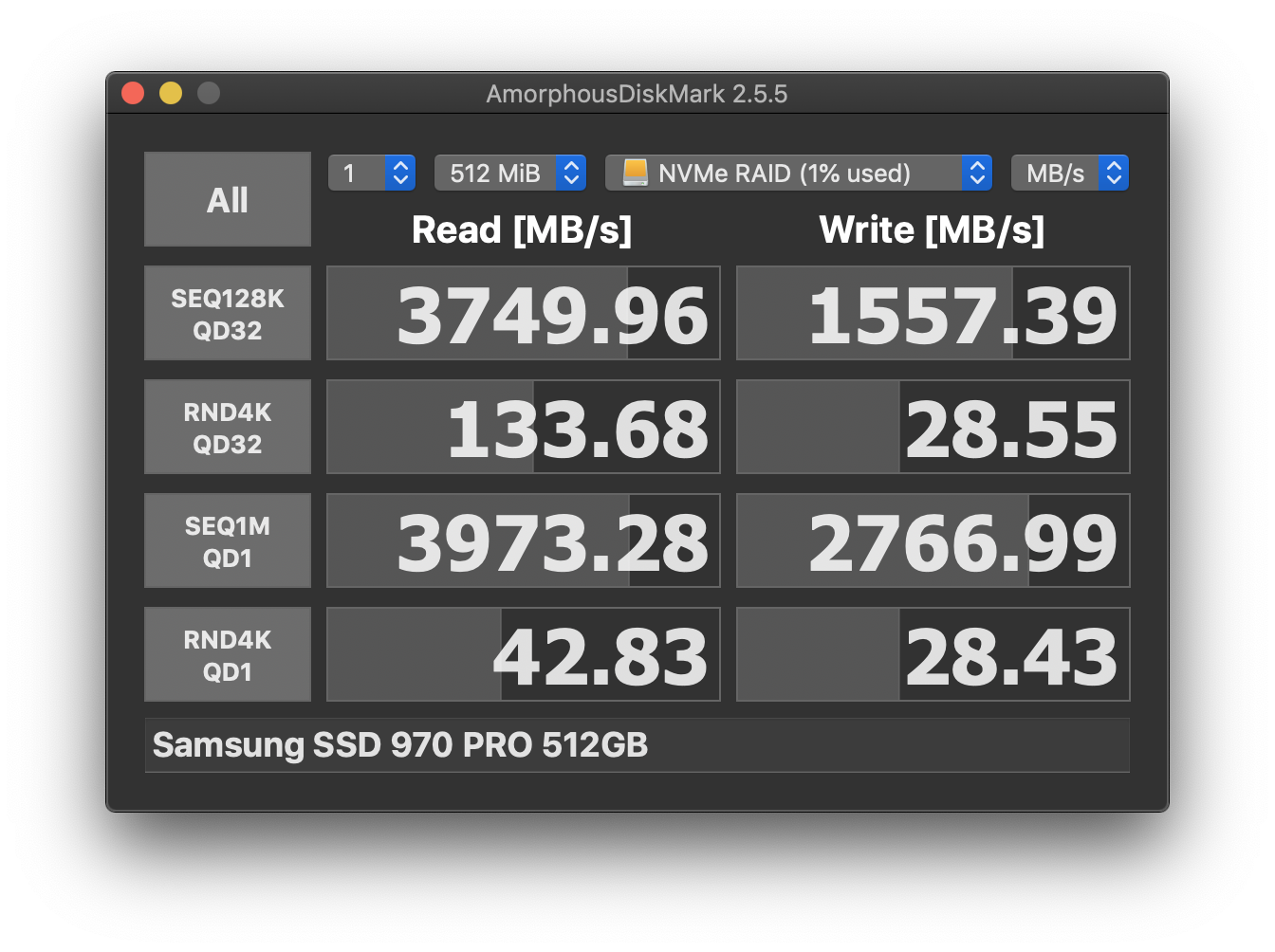

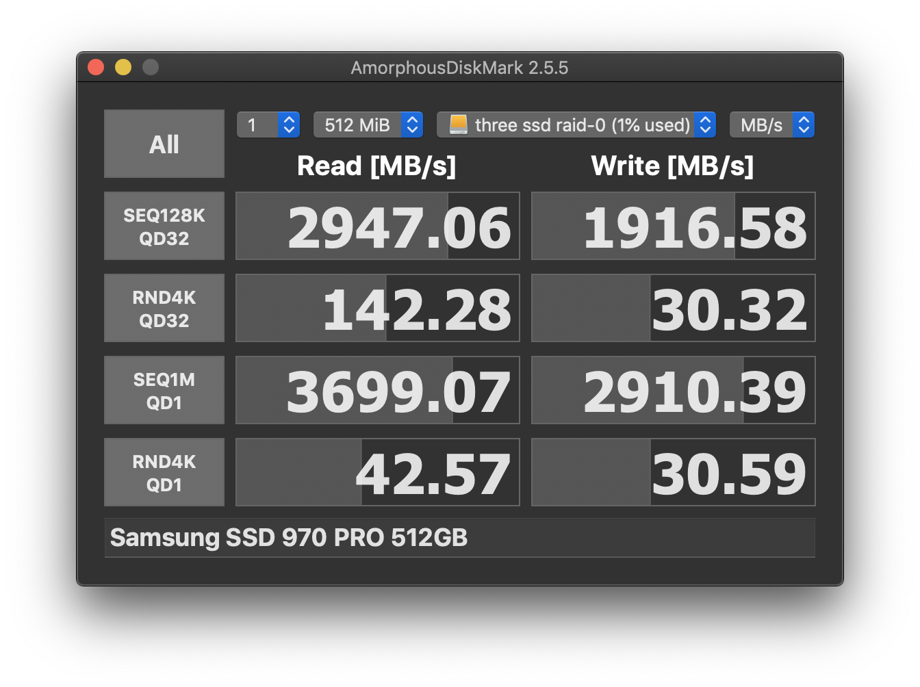

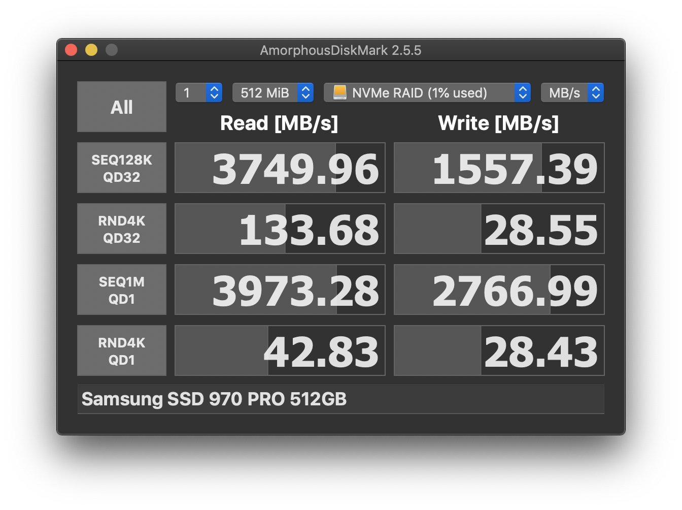

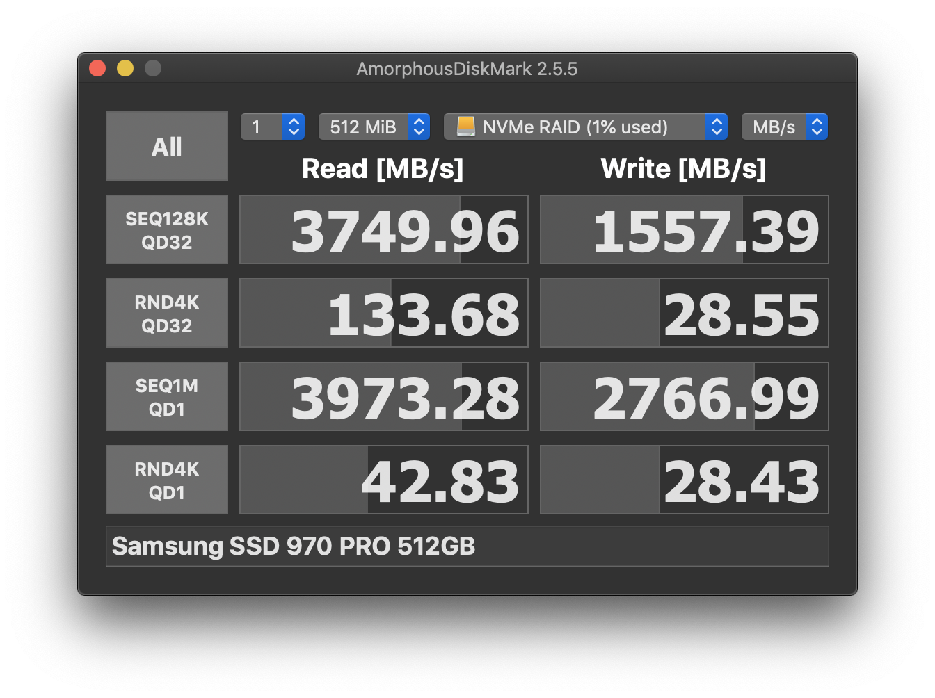

So I migrated my OS to a 860 Pro and set up the four 970 Pros in RAID-0 on my 7701 but the results are still poor. I don't know what else to do. Any additional thoughts/insight as to why this is happening? View attachment 934223
That's not supposed to happen.
Can you try 2 more tests with raid-0 3 and 2 disk setups?

Something is very wrong with @dorianclive hardware setup and it’s not BootROM related, I’ve reconstructed it recently with 144.0.0.0.0. Four 970PRO blades in a RAID0 array should get the full bandwidth of the x16 connection, he is getting the same lowball results as 3.

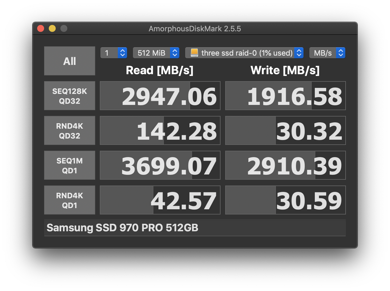

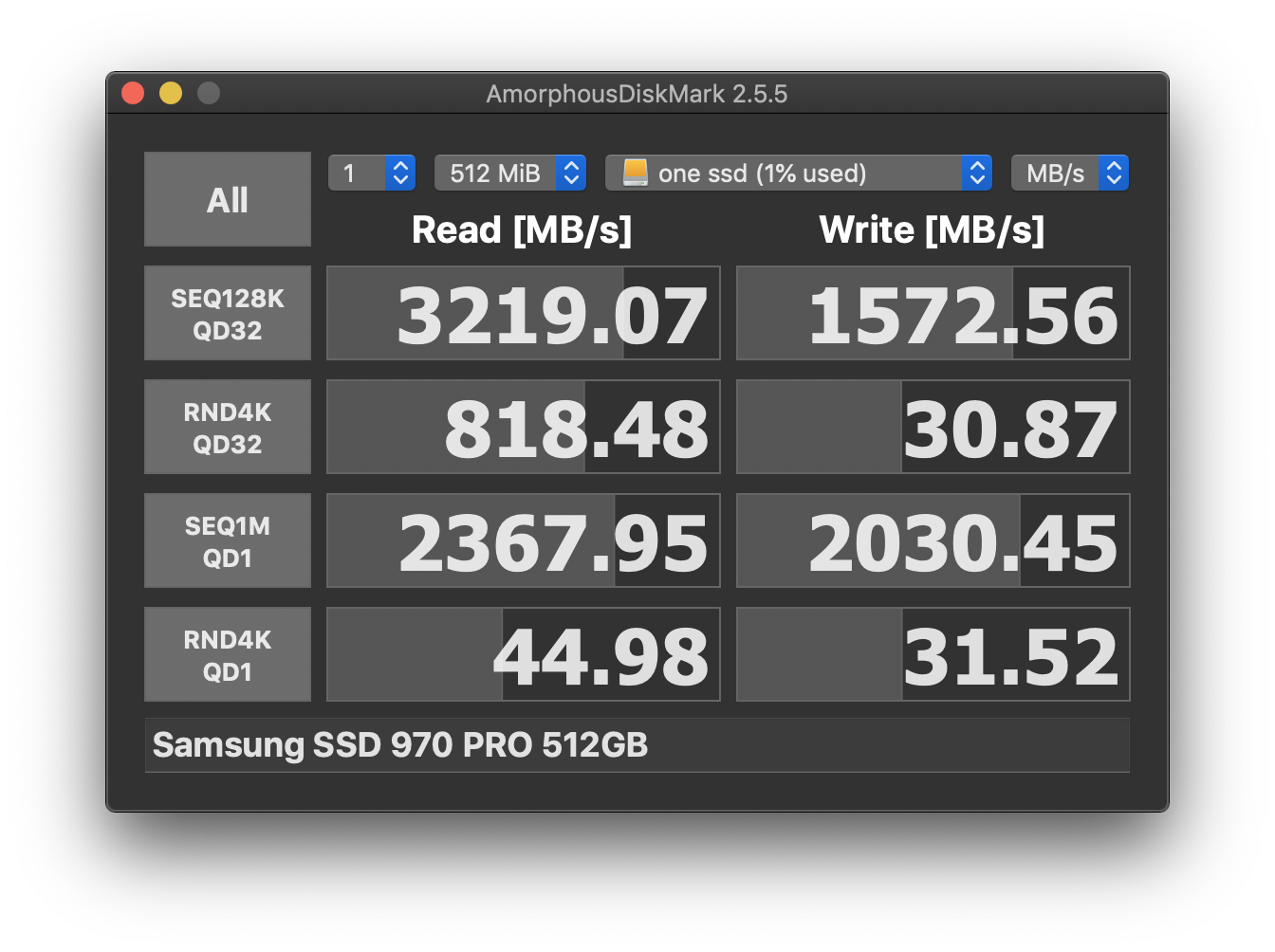

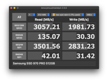

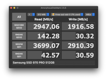

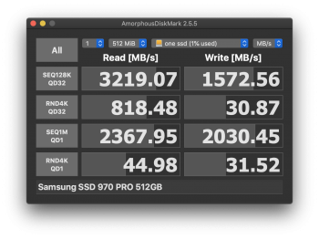

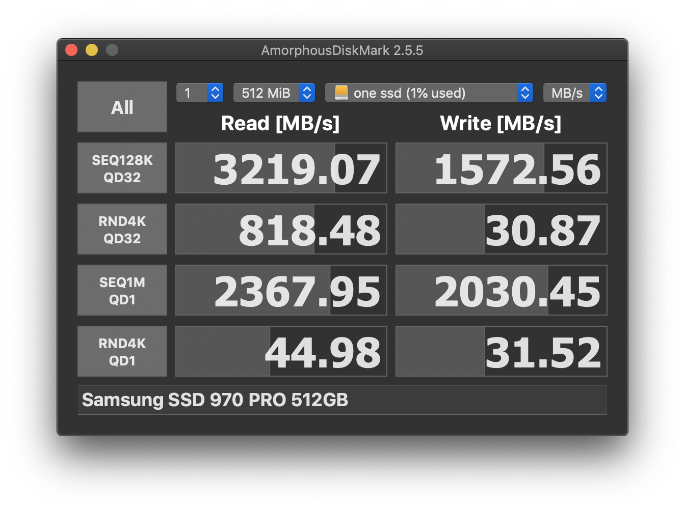

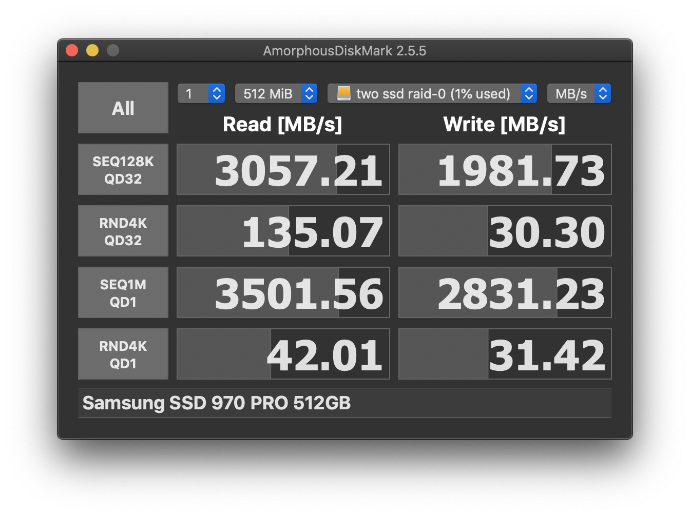

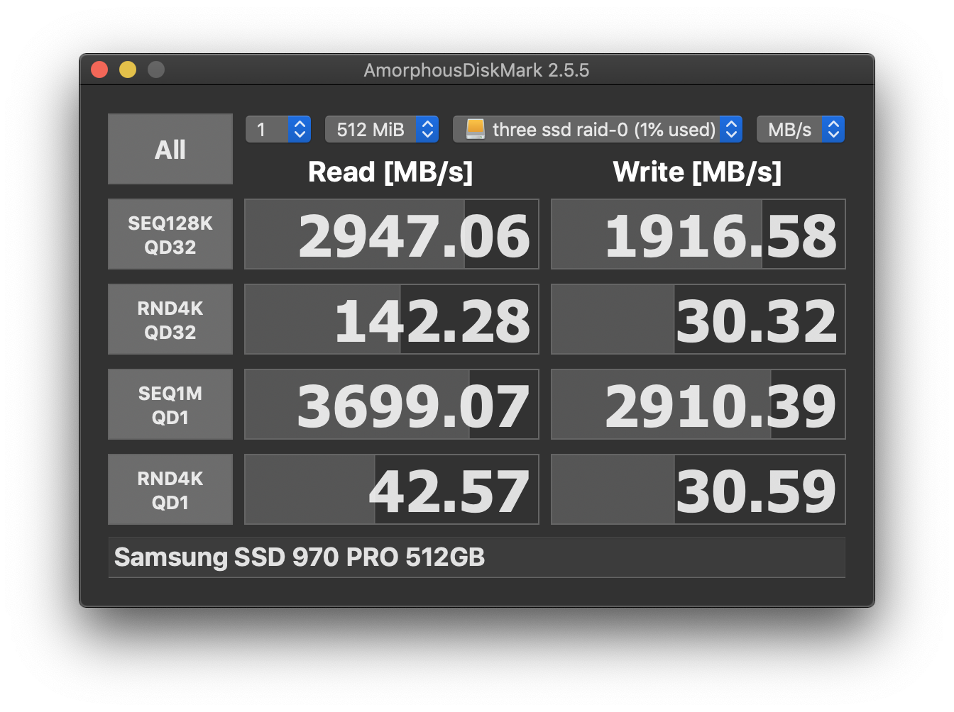

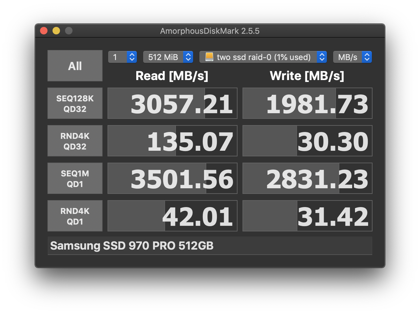

Here's my results:
One SSD HFS Journaled
Two SSDs HFS Journaled - 64k stripe size
Three SSDs HFS Journaled - 64k stripe size
My CPU setup is 2 x 3.46 GHz 6-Core Xeon

The one blade test is from a 970PRO? This is a too low result, get setpci working and let's se what is really wrong.

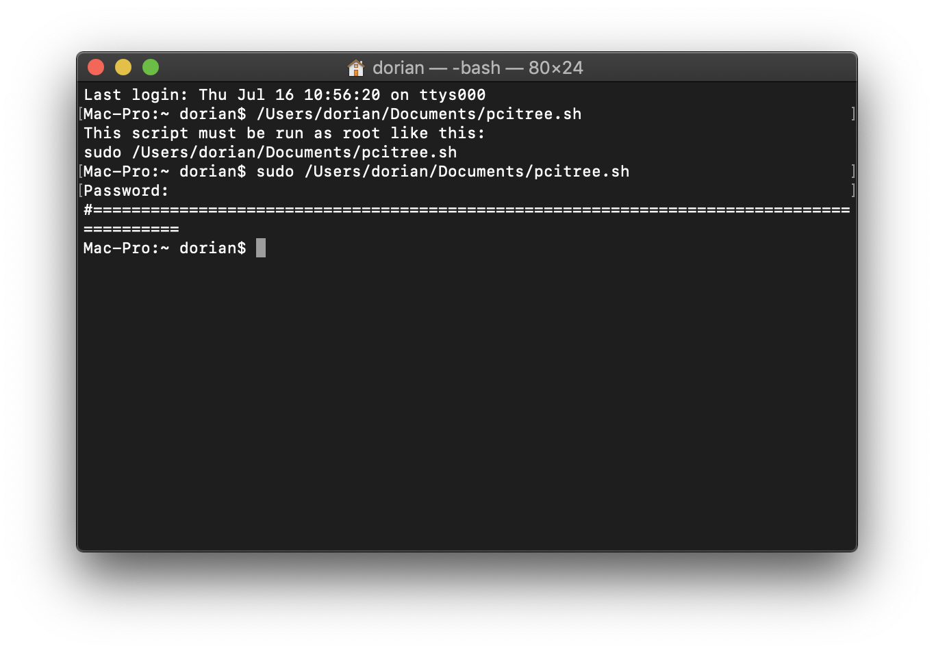

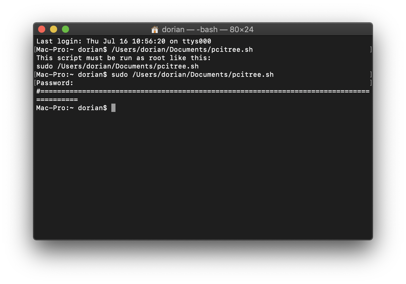

This is what I'm getting to this point. When I run the pcitree.sh, it's not reading out any results.
I'm at work and can't help you now - did you install pciutils? You need pciutils working to run the script.
Edited to remove the pciutils homebrew tap link, it's not working anymore.
