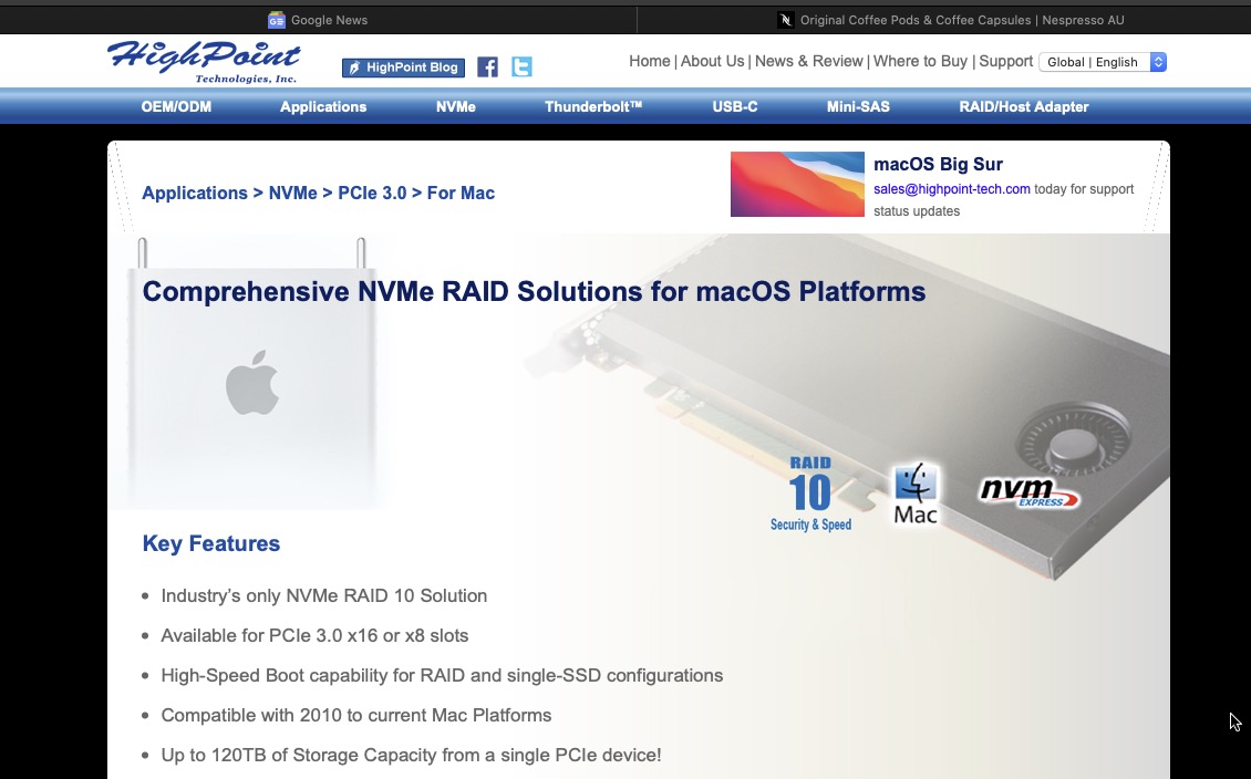

This is on their web page now, a link to email sales for status updates (top right corner).
Yes it is odd behaviour.
My first thought is the drivers are still in beta.
I've sent an email requesting a status update but no reply yet.
This is the reply I received from support yesterday 30th Nov:
