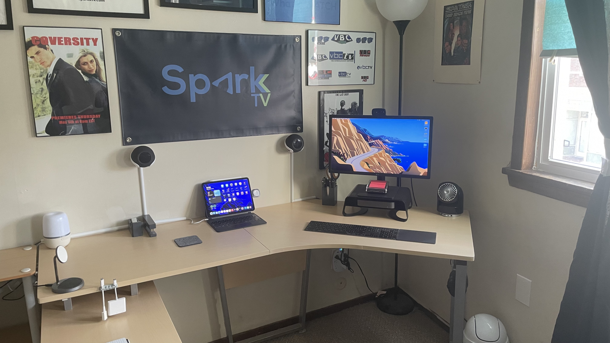

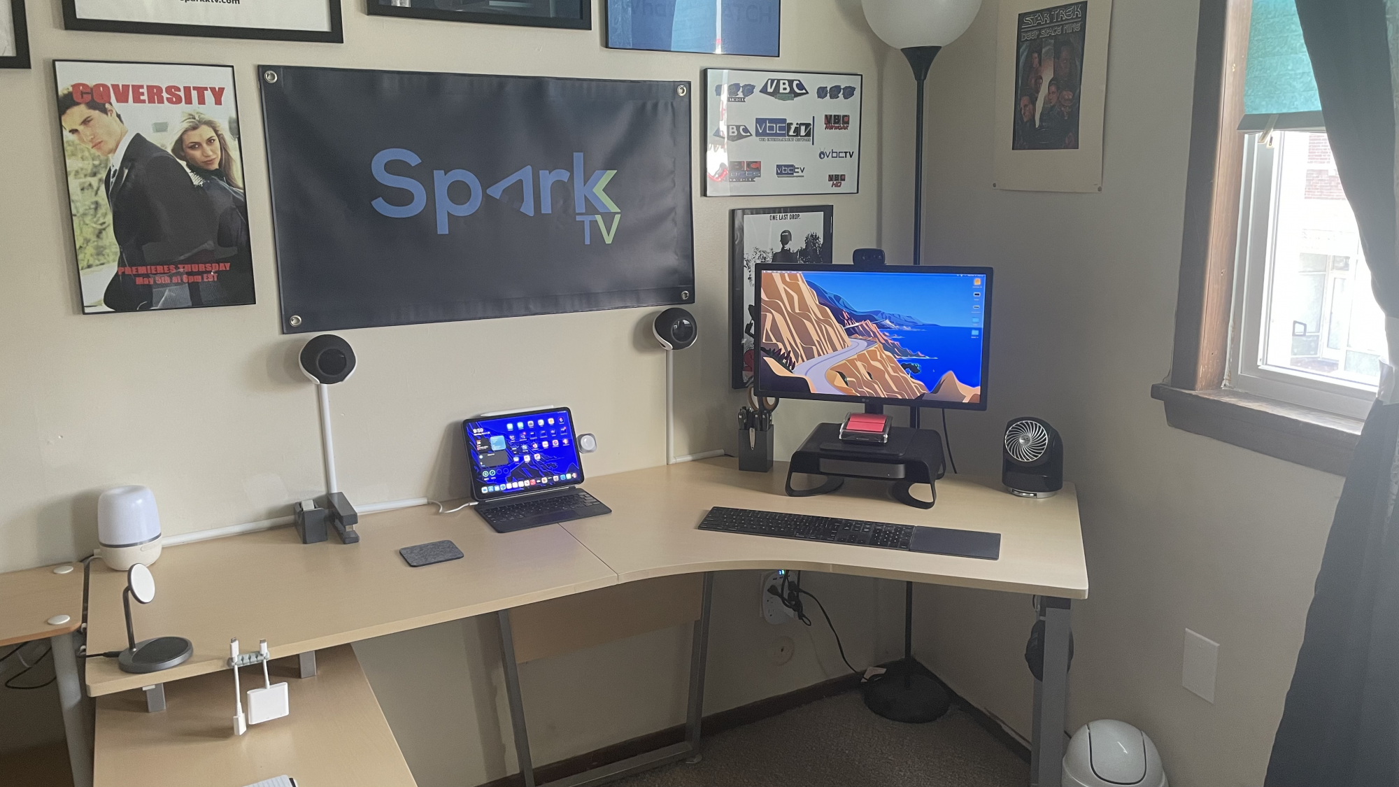

Been using the HomePod mini as a stereo pair on my 2020(2018) Mac mini i5 since the macOS 11.3 beta. Loving it. As you can see in the picture, I wall-mounted them above my iPad so I can use them with my iPad Pro or Mac mini. I have zero issues with them, except the lag when hitting pause/play, other than that everything is in sync and they work great. I would recommend the Mini's Stereo pair as desktop speakers for anyone...
Glad it’s working well for you. But question: have you used them for video/audio editing or anything that requires zero lag response?
I use the built-in speakers on my LG Ultrafine or my AirPods Pro when using Final Cut Pro. That is the only issue I've had with the HomePods. But it's small solvable issue that isn't a deal-breaker for me. I have no issue if using LumaFusion on my iPad Pro. If they would ever upgrade the system AirPlay from 1 to 2 on the Macs, that issue would go away. Assuming it will come to macOS 12 or 13 since they finally brought stereo pairs on macOS 11.3
Ah ok. You use wireless speakers with your iPad for lumafusion? As far as I know there is no truly lag-less wireless audio, not good enough for things like audio editing. They might be able to do it if they lower the bandwidth/quality.
