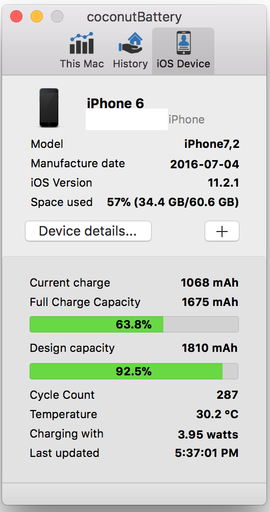

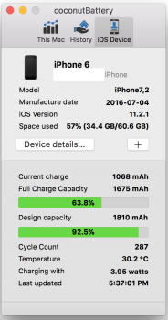

Using coconut battery, not as good a reading as previous. But still seems OK. As you can see, 2.5 years old.
To recap, I have 40-50% battery left over at the end of each day. If I am reading/understanding this right, I have a battery that has had 297 cycles, and is capable of 90-plus% charge capacity. Performance is miserable. At least in my case, I don't see the connection between this battery and poor performance.

Battery seems pretty good. BTW, your phone is only 1.5 years old.
