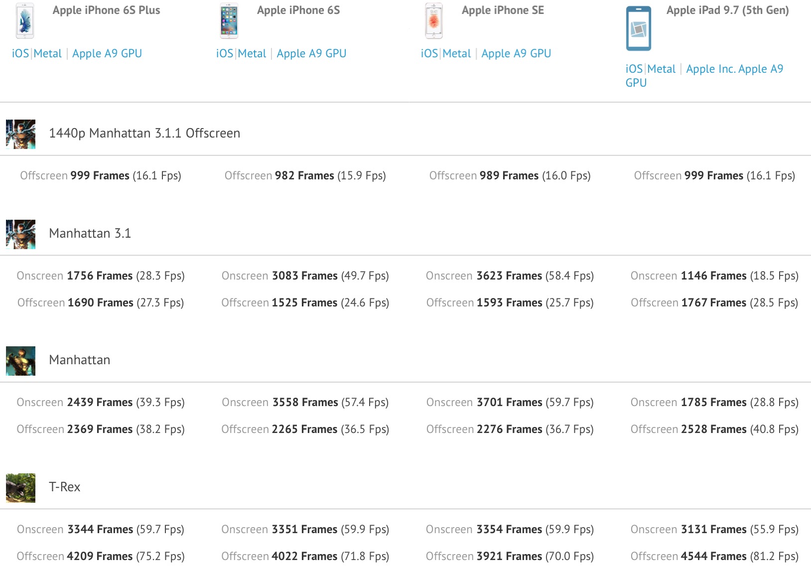

As a point of comparison:
If you just want to see raw performance, you can look at the offscreen FPS. That test runs at 1920*1080 regardless of device display resolution. Comparing the offscreen with the onscreen results gives an idea how much harder the GPU needs to work at higher resolutions.

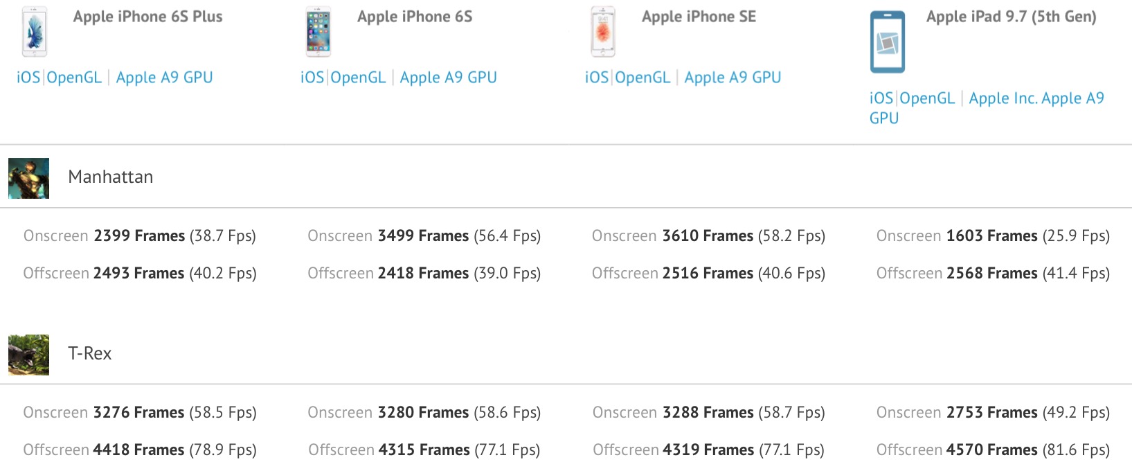

From the online results database (Apple A9 across different resolutions):
OpenGL
Metal
