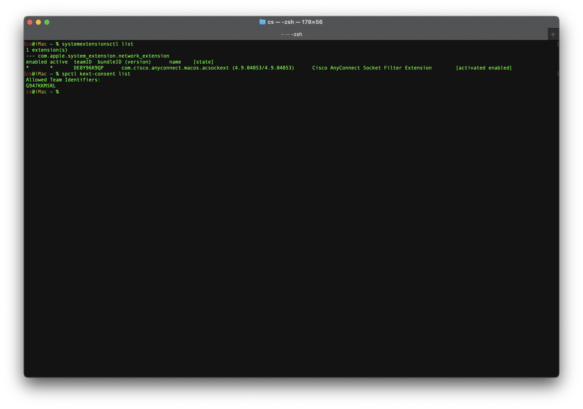

kmutil showloaded
maybe systemextensionsctl list is a bit easier, as it just shows your loaded extensions?
Getting rid of extensions with big sur is a big pain. You can't just delete them from the folder. The accepted way is to delete the application which installed the extension. When that doesn't work you can do a sudo systemextensionsctl uninstall (extension name) in recovery mode with SIP off.
casperes1996
macrumors 604
Jan 26, 2014
7,487
5,650
Horsens, Denmark
systemextensionctl list is not the same thing. It will list different extensions.
Allow me to demonstrate
I have the Cisco any connect system extension as you can see, with the TeamID DE8Y96K90QP, but I also have the Xbox360controller driver which is a traditional kext, with team ID G947KKM5RL.
The 360 driver is also not installed with an application. It was installed from a pkg installer which you can't even do with system extensions. They need to be bundled with apps. It had its own uninstaller in its System Preferences pane however, that deletes everything for it, and an uninstall script on the GitHub in case the other method fails

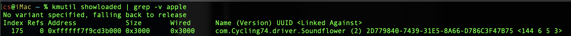

Interestingly though, the kext-consent doesn't show SoundFlower, even though it is a currently loaded kext not from Apple (though currently loaded shouldn't matter for kext-consent, just that consent has been given)
That one is also not a system extension, btw, and thus does not show with systemextensionctl list :)

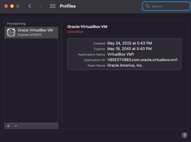

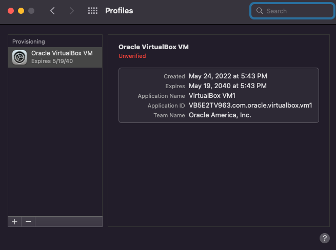

@bogdanw Fantastic. Were you able to extract this on your machine or from their source code? If the former, would love to know how!
Ok, I see that you pasted the entitlements from the embedded.provisionprofile in the main app. Chrome has that file in its bundle as well, but it doesn't show in Preferences/Profiles as in the attached picture. So I'm not sure if this Provisioning Profile is something more than just the embedded.provisionprofile or not.

Same UUID
Code:
security cms -D -i /Applications/VirtualBox.app/Contents/embedded.provisionprofile -o ~/Desktop/embedded.provisionprofile.plist
defaults read ~/Desktop/embedded.provisionprofile.plist UUID
/usr/bin/profiles -cv
TN3125: Inside Code Signing: Provisioning Profiles https://developer.apple.com/documentation/technotes/tn3125-inside-code-signing-provisioning-profiles

The UUID from the command `profiles list -type provisioning` does indeed match the UUID of embedded.provisionprofile in the app's bundle: `grep -A 1 -a UUID /Applications/VirtualBox.app/Contents/embedded.provisionprofile`.
Thanks again.

Do you know how to get all the hashes in a Provisioning Profile?
(The hashes of the executables that would benefit from the entitlements in that profile.)
Lastly, would that mean MacOS calculates hash of any executable before running it?!
I'm asking this since I didn't see extended attributes for VBox CLI tools, so I assume they can only rely on a hashing mechanism to be identified.
bogdanw
macrumors 603
Mar 10, 2009
5,719
2,751
TN3126: Inside Code Signing: Hashes
"Look inside a code signature to see how it uses hashes to protect the code’s executable pages, resources, and metadata from tampering."
https://developer.apple.com/documentation/technotes/tn3126-inside-code-signing-hashes
As far as I can tell, there are no hashes in the provisionprofile and the decoded DER-Encoded-Profile looks like this
Code:
SET
 SEQUENCE
  UTF8STRING        :Version
  INTEGER           :01
 SEQUENCE
  UTF8STRING        :TimeToLive
  INTEGER           :19AA
 SEQUENCE
  UTF8STRING        :Platform
  SEQUENCE
   UTF8STRING        :OSX
 SEQUENCE
  UTF8STRING        :IsXcodeManaged
  BOOLEAN           :0
 SEQUENCE
  UTF8STRING        :ProvisionsAllDevices
  BOOLEAN           :255
 SEQUENCE
  UTF8STRING        :AppIDName
  UTF8STRING        :VirtualBox VM1
 SEQUENCE
  UTF8STRING        :Name
  UTF8STRING        :Oracle VirtualBox VM
 SEQUENCE
  UTF8STRING        :CreationDate
  UTCTIME           :220524134334Z
 SEQUENCE
  UTF8STRING        :TeamIdentifier
  SEQUENCE
   UTF8STRING        :VB5E2TV963
 SEQUENCE
  UTF8STRING        :ExpirationDate
  UTCTIME           :400519134334Z
 SEQUENCE
  UTF8STRING        :TeamName
  UTF8STRING        :Oracle America, Inc.
 SEQUENCE
  UTF8STRING        :ProfileDistributionType
  UTF8STRING        :DIRECT
 SEQUENCE
  UTF8STRING        :ApplicationIdentifierPrefix
  SEQUENCE
 SEQUENCE
  UTF8STRING        :UUID
  UTF8STRING        :b911524e-b426-4502-b050-8a5bd0bf7ab9
 SEQUENCE
  UTF8STRING        :DeveloperCertificates
  SEQUENCE
   OCTET STRING      [HEX DUMP]:31053B63156B75A02C7D80E7943F0517C0C35BCF14B399B646492304AE6CE5CD
 SEQUENCE
  UTF8STRING        :Entitlements
  appl [ 16 ]
   INTEGER           :01
   cont [ 16 ]
    SEQUENCE
     UTF8STRING        :com.apple.application-identifier
     UTF8STRING        :VB5E2TV963.com.oracle.virtualbox.vm1
    SEQUENCE
     UTF8STRING        :com.apple.developer.team-identifier
    SEQUENCE
     UTF8STRING        :com.apple.vm.device-access
     BOOLEAN           :255
    SEQUENCE
     UTF8STRING        :com.apple.vm.hypervisor
     BOOLEAN           :255
    SEQUENCE
     UTF8STRING        :com.apple.vm.networking
     BOOLEAN           :255
    SEQUENCE
     UTF8STRING        :keychain-access-groups
     SEQUENCE
      UTF8STRING        :VB5E2TV963.*
Reactions: Unknownnnn
Unknownnnn
macrumors newbie
Dec 24, 2023
10
Thank you very much.
Then how do you think VBoxManage or VBoxHeadless benefit from that Profile?! (And hopefully not non-Oracle executables.)
`otool -l` doesn't work on them either. 🤔
