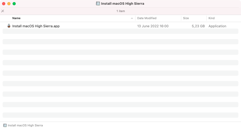

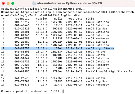

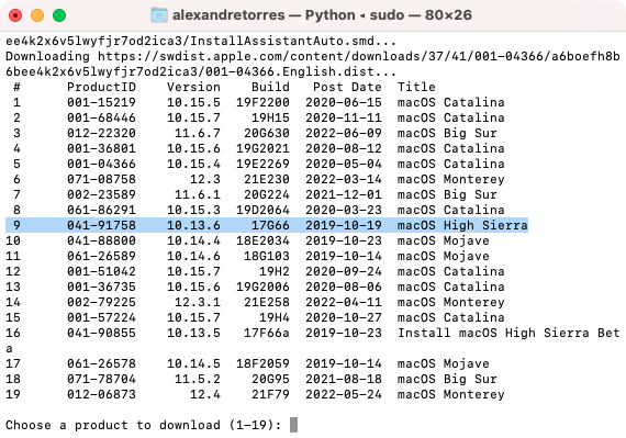

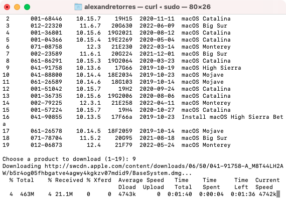

Btw, Apple still offers High Sierra full installer for download, just checked with installinstallmacos.py and is downloading:

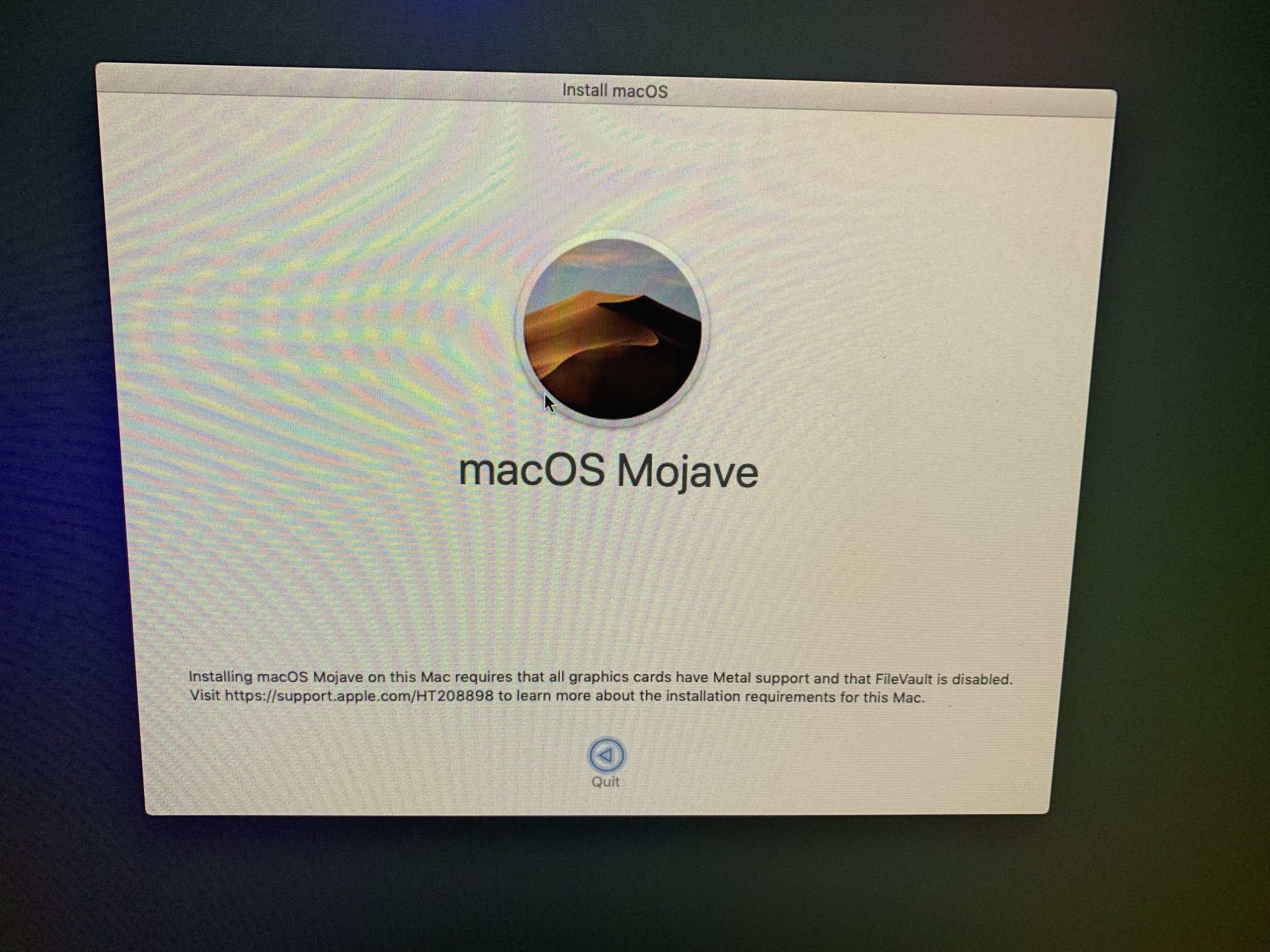

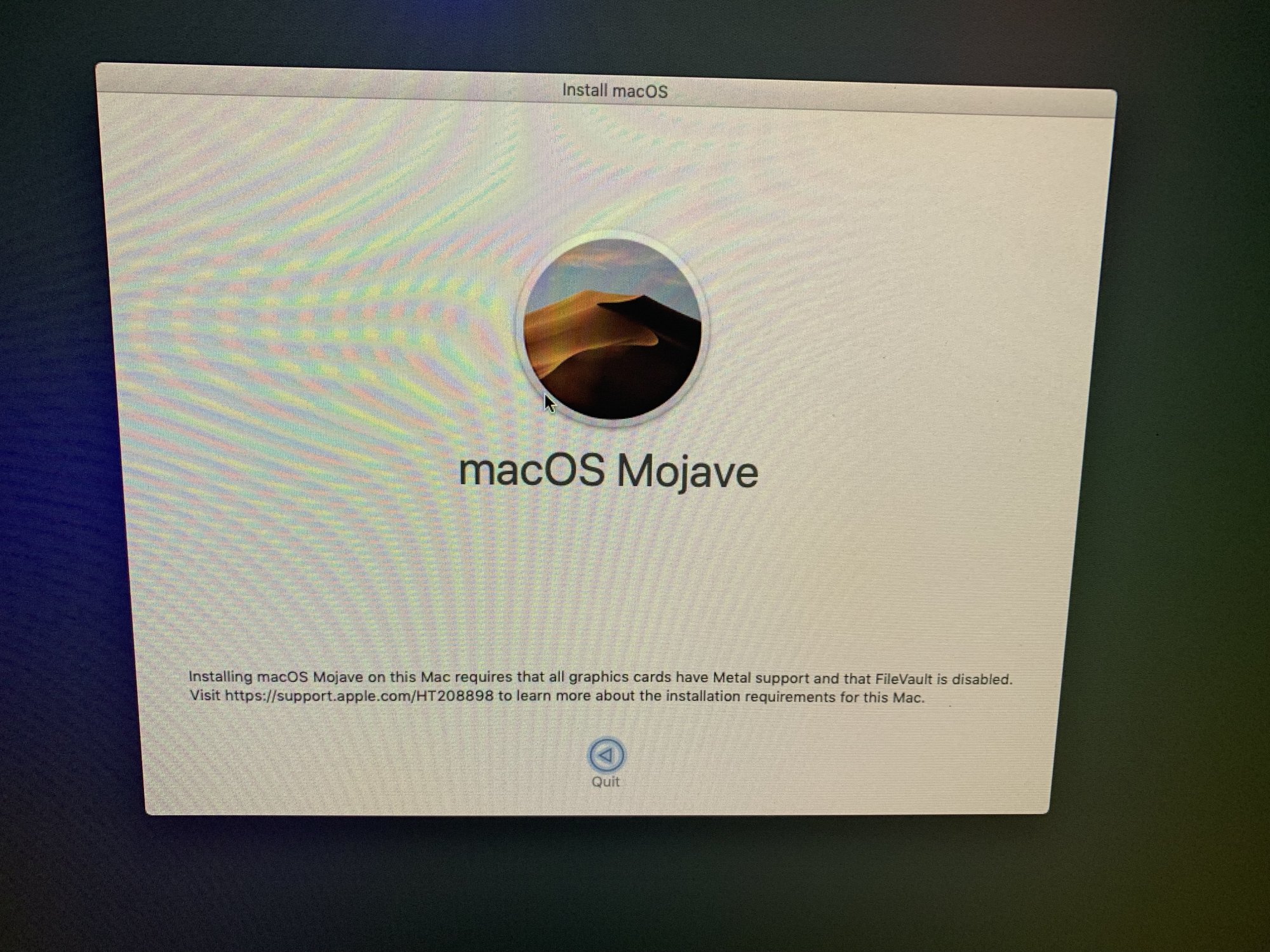

Well this morning 'Install macOS' actually DID do something. I haven't a clue what changed overnight but that's what happened. So now I'm running High Sierra and I've put the GTX 680 back in. I assume I need to do this as Mojave requires Metal GPU support. I tried the Mojave bootable install disk I made yesterday but that wouldn't work (back to the ''Install macOS' doesn't do anything' thing again. This is a legit upgrade now so I'd have thought it would possible to install it from the desktop but it seems no you just get the dreaded beach ball of death.
I found the original installer for Mojave in my archives but that wouldn't work either. Looks like it must the GTX 680 to blame.

Got a solid high Sierra install now but Mojave install is impossible because of the GT680. I have a SAPPHIRE Radeon PULSE RX 580 8 GB in one of my other Mac Pros, would that work with the Mojave install do you think? If not what would?
While booting a createinstallmedia USB installer fo Mojave don't work with Nvidia GPUs, if you run the installer from HighSierra to do a clean install to another disk it will work fine.

I tried formatting a disk to AFPS in Disk Utility but same 'No Metal Support' error. I must be missing something. What's the secret?

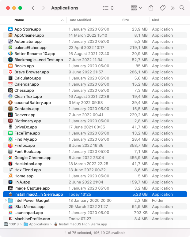

Why you are still saying this? I've showed, and tested, two days ago that Apple still offers High Sierra for download and you can download it by multiple ways.
Btw, Apple still offers for download all past macOS releases since Yosemite.

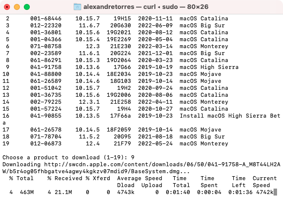

You can use installinstallmacos.py:
screen-shot-2022-06-13-at-15-29-19-png.2018693

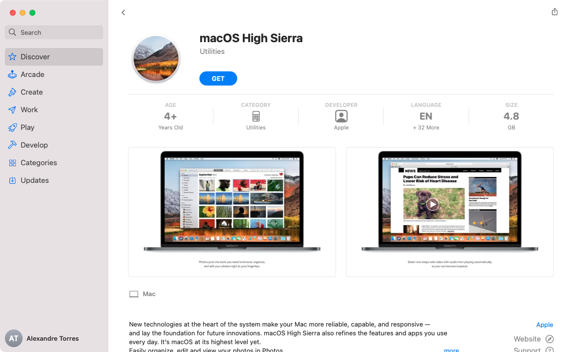

Or you can also download from Apple Support via browser/App Store, following the Apple Support instructions below:

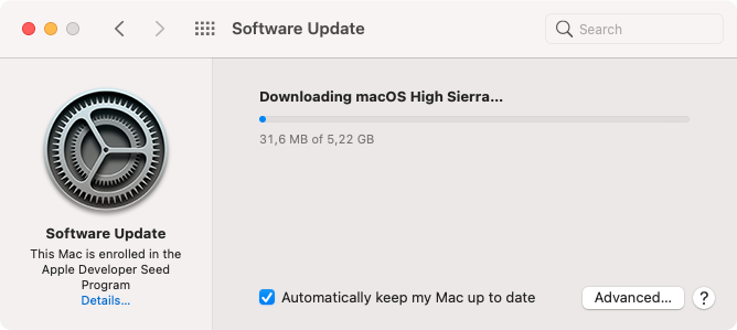

Just confirmed that you can successfully get High Sierra today:

The GTX680-is-no-metal-message is an error. All Kepler GPUs will be ignored by the Mojave installer Boot Stick (so called createinstallmedia stick (as the cli tool inside the installer is called so).

But with Mojave you are forced to run the MacOs Installer App thru High Sierra - because of the installer flaw with Kepler GPUs.
