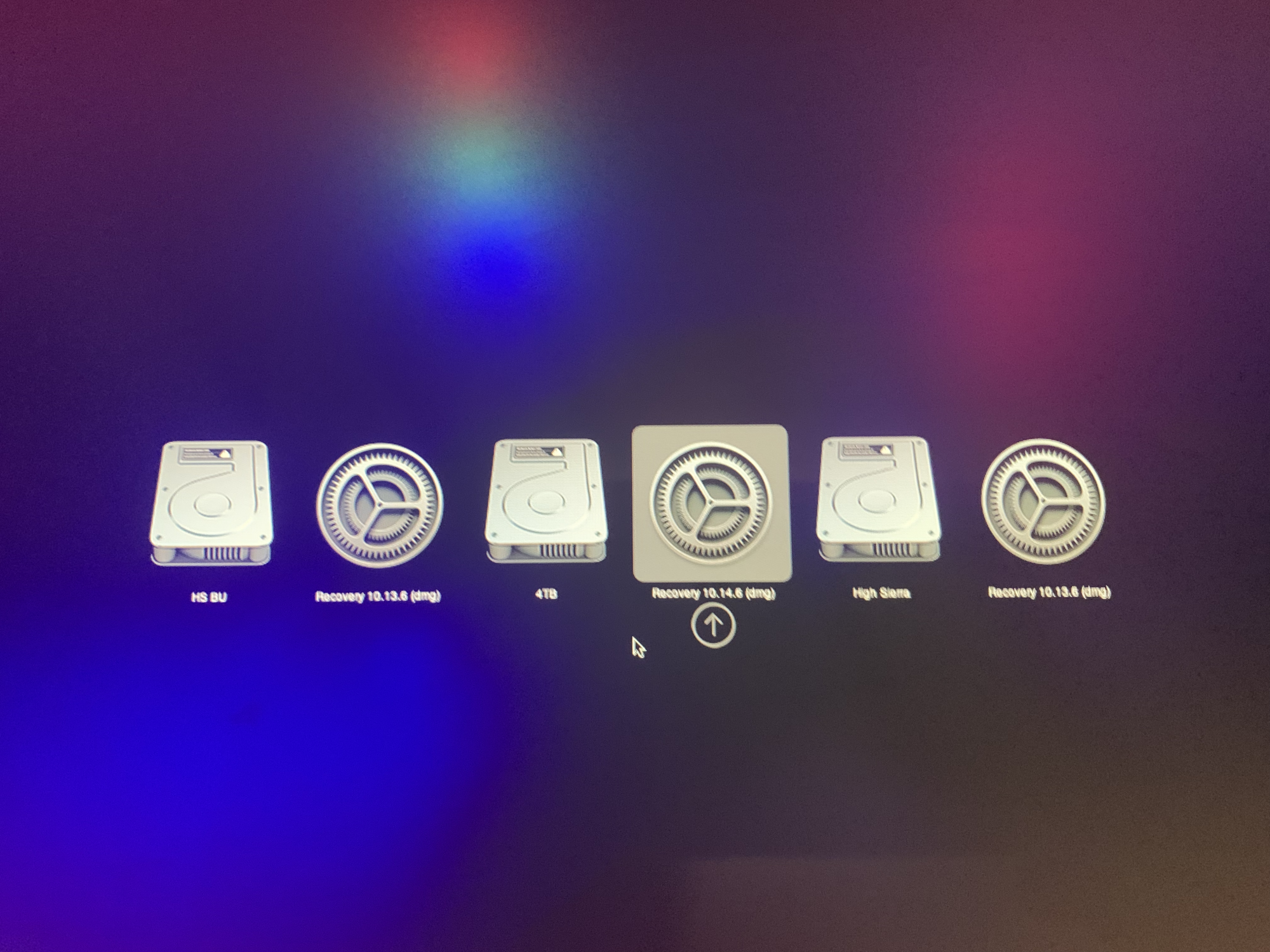

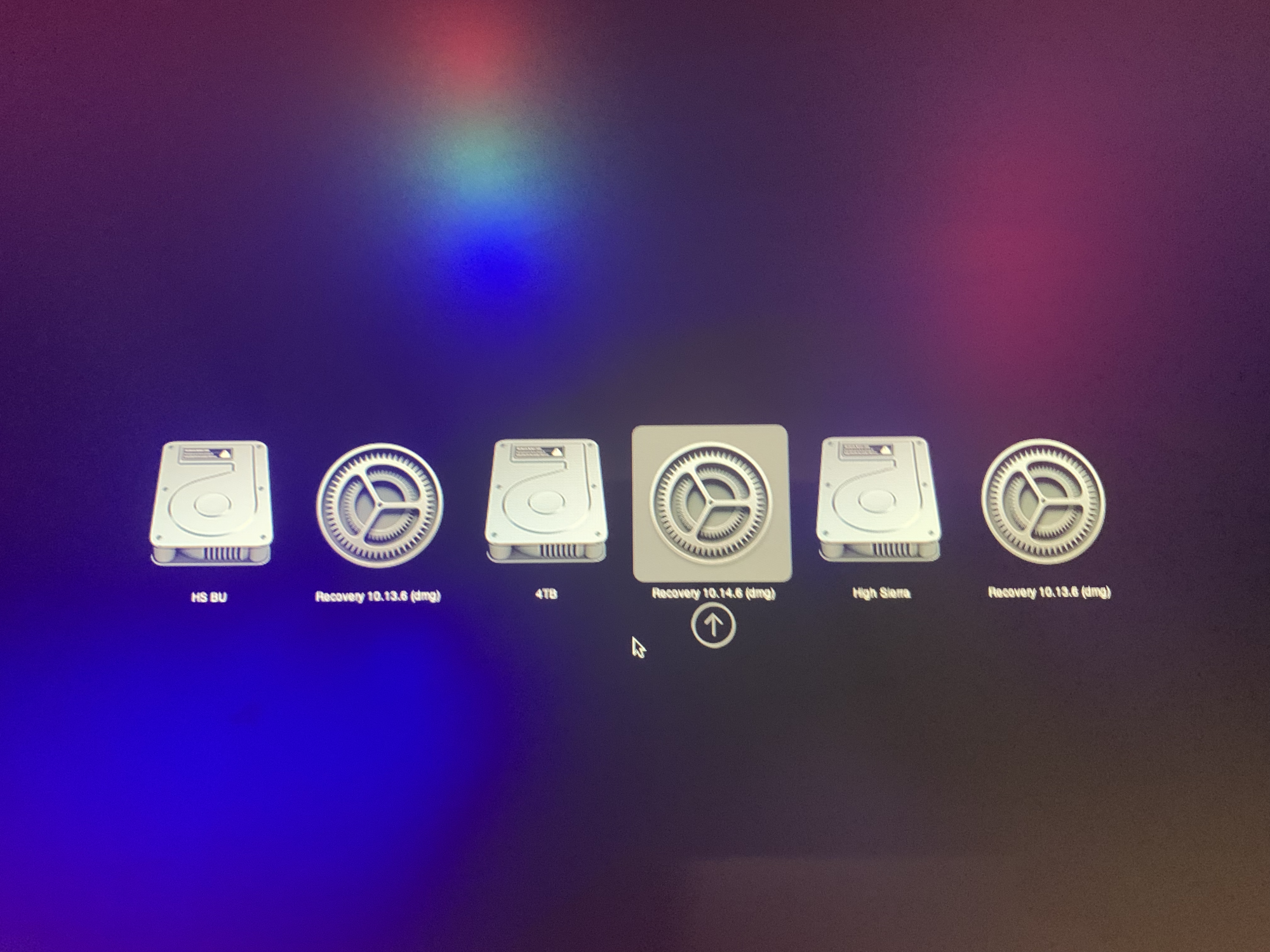

and was not taken to OpenCore but to this screen and back to square 1...
and since it doesn't contain the drive I put the ESP on do I assume it should have gone on a system drive?
The location of the ESP shouldn't matter. OC should automatically detect all healthy macOS installations—patched (dosdude1) installations being problematic.
Actually, that screen is the OpenCore boot picker.
Just to be clear: I should be selecting Recovery 10.4.6. even though it''s not the disk I created in the ESP on, yes?
And do I need to go through the whole procedure a third time or is the ESP still there but just not visible?
As described in the guide, if you've set LauncherOption=Full, then OC will automatically be blessed after starting at least once. So no need to enter Recovery to bless it if that's the case.
However, if you haven't set LauncherOption=Full, then you'll still need to bless OC, but you can't do it from an OC booted system (with RequestBootVarRouting=true): you'll need to do it from a natively booted installation of Mojave. See Maintenance > Disabling OpenCore in the guide.
To answer your questions:
  1. It doesn't matter that your Mojave installation is not on the same disk as your ESP. You can still use its Recovery environment (booted natively) to bless OC.
  2. Unlike the native boot picker, the OC boot picker will not show the ESP on which it is installed.

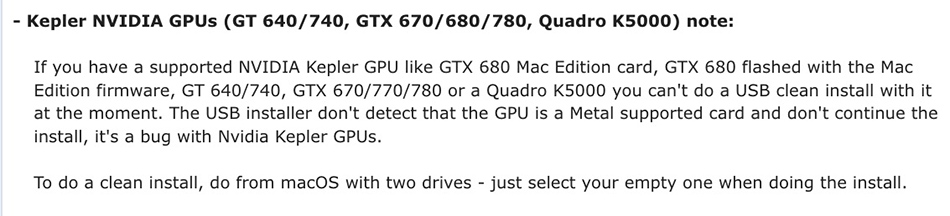

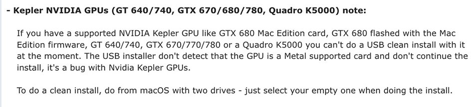

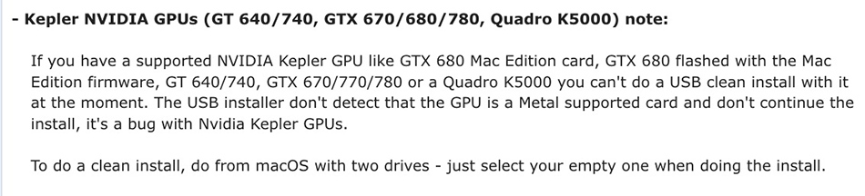

Well this morning 'Install macOS' actually DID do something. I haven't a clue what changed overnight but that's what happened. So now I'm running High Sierra and I've put the GTX 680 back in. I assume I need to do this as Mojave requires Metal GPU support. I tried the Mojave bootable install disk I made yesterday but that wouldn't work (back to the ''Install macOS' doesn't do anything' thing again. This is a legit upgrade now so I'd have thought it would possible to install it from the desktop but it seems no you just get the dreaded beach ball of death.
On Nvidia cards not being recognized by the Mojave installer is a known bug. This was mentioned in the guide created by @tsialex on upgrading to Mojave. It’s an excellent guide posted by Tsialex. The alternate solution mentioned is to use 2 SSD drives to install Mojave. Drive A will have the Mojave installer and Drive B as the target drive for Mojave to be installed. This process worked well for me using Nvidia Kepler GPUs. I removed all other drives before installing. I have Nvidia 680GTX, Quadro K5000 and 770GTX and was able to install Mojave.
After installing Open Core by Martin Lo, this time I successfully installed Mojave via the flash drive createinstallmedia using Nvidia GPUs. I learned about this from a post in the FB Opencore group. Key is doing extensive research and reading various blogs or other sources about Open Core.
