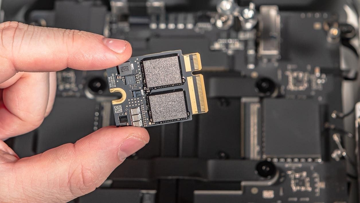

The Studio's RAM NAND is removable - 2 sticks like the iMac Pro/Mac Pro.
But the controller is in the M1 SoC. So needs Apple's Configurator voodoo to deal with any changes.
Data is encrypted and the key is in the Secure Enclave.
So take it to Apple.

Seems to me that the Mac Studio DOES have a "removable" drive "card" inside (it actually has 2 slots, generally with only one slot populated).
You could:
1. open it
2. remove the card (which would then have to be destroyed, I doubt there's any way to recover data from "just the card")
... but then the computer would be unusable without Apple repair.

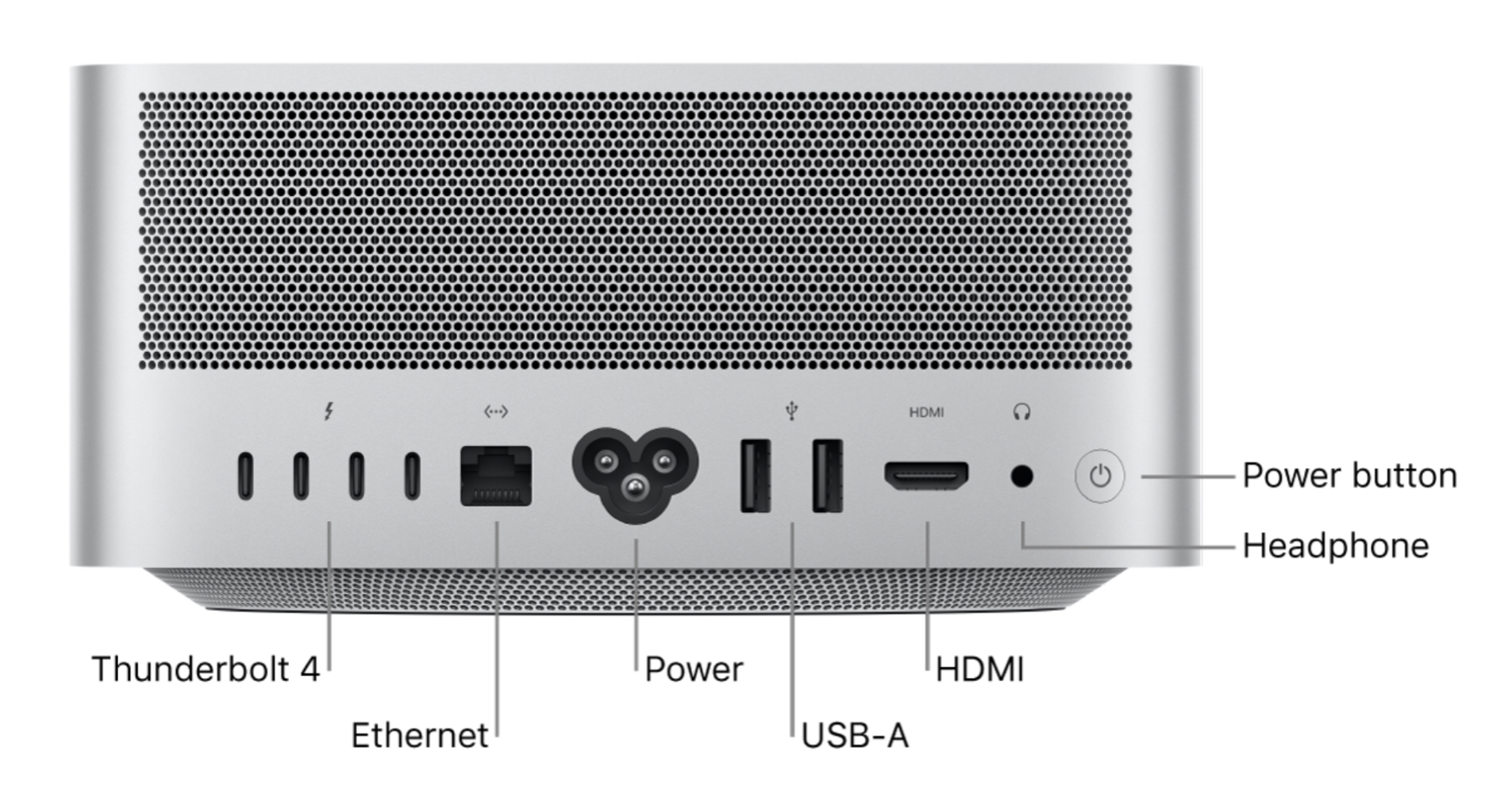

Maybe a daft suggestion, but is there a fuse in the power cable....?
I don't want to unplug mine to check.....:p
Reactions: kat.hayes
For UK version there definitely is a fuse. I'm not sure for the rest of the world including the US, the plug must be 3 prong but doesn't look like there is space for a fuse.
Either way I think the OP should try to find another cable to test, the socket / plug are standard IEC C5/C6.
It is standard, but has a tri-connector to the Mac.
As suggested by others, take it to Apple Store, at least they can check another power cable.
