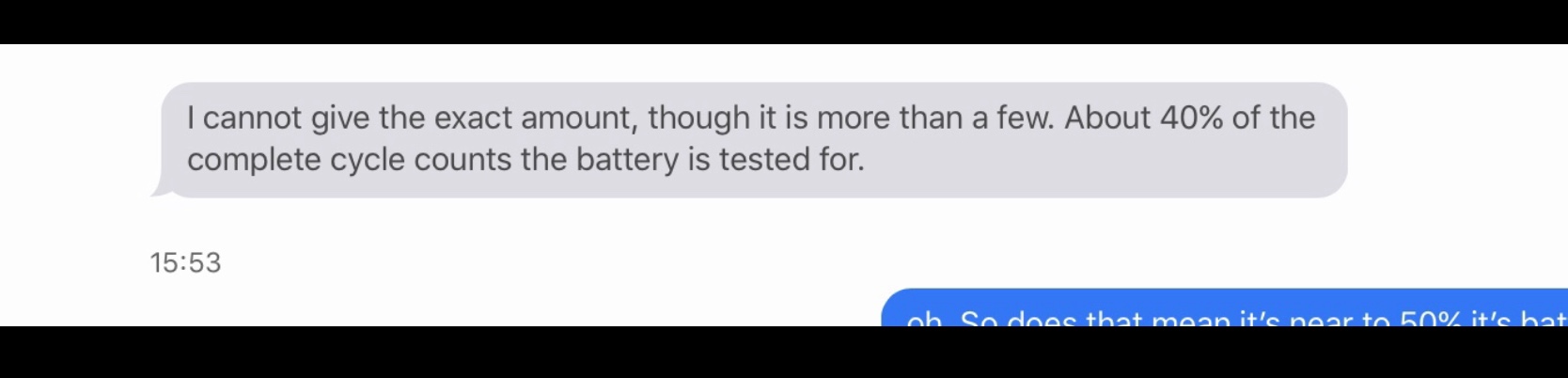

I had Apple run a diagnostic on mine. They wouldn’t give me specifics but when I asked about cycle counts as I wanted to see if they correlated with imazing’s result they told me that the battery “looked good” but had reached something like 40% the limit of cycles it’s tested for.
I assume he was meaning the 500 cycles = two years which would be somewhere in line with the 263 figure I got from imazing but imazing is showing its closer to 50+%..if that makes sense?
Tbh, I wish Apple support were more forthcoming with the battery info..I’ve no idea why he was being so elusive with the diagnostic result, other than saying it was “looking good”
I assume he was meaning the 500 cycles = two years which would be somewhere in line with the 263 figure I got from imazing but imazing is showing nearer to 50%..if that makes sense?
edit: When asking for info on the batteries cycle count I was given the following quite confusing response from Apple.

Nah, other than saying the battery was currently looking good he was quite reluctant to be specific when I attempted to push for more info.

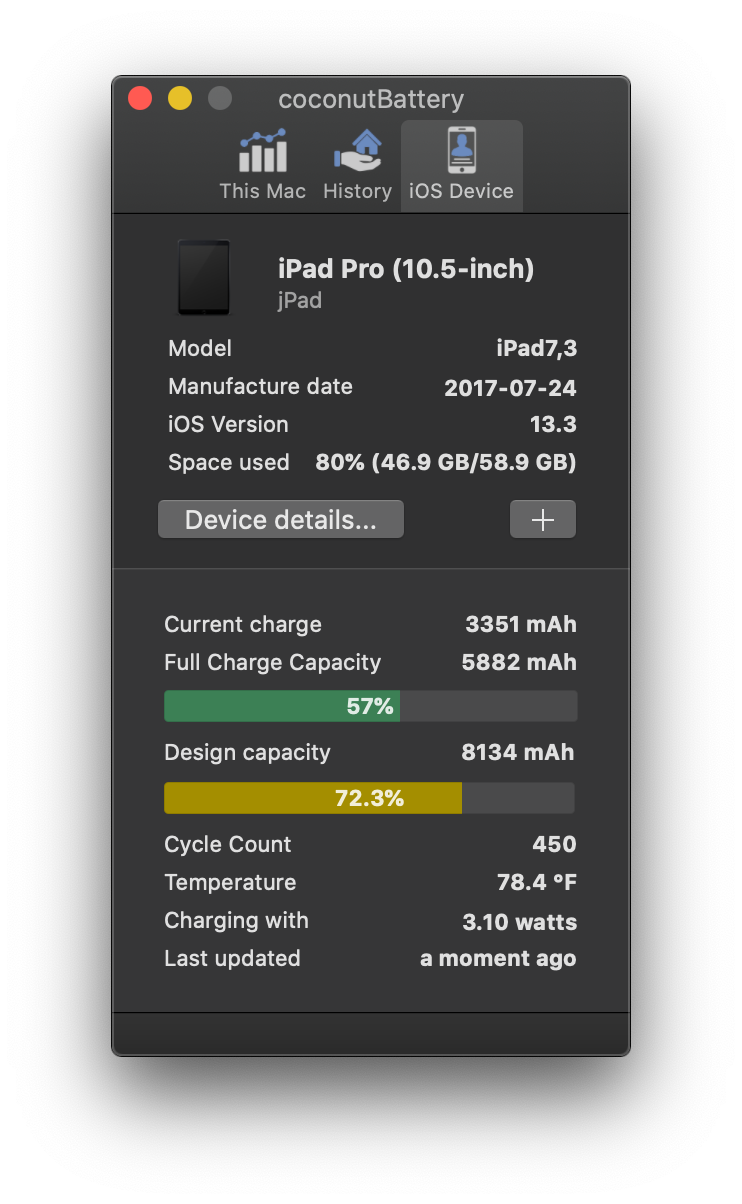

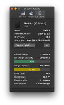

I have certainly noticed a difference in battery not lasting as long under iOS 13. During the day it used to be 50+% by evening or 10 hours use. Today it is down to 55% at midday and was charged fully by 10pm yesterday.
Granted my iPad Pro 10.5" is a bit dated (2.5 years old now), I've noticed the battery life is much much worse than it was even a year ago. You can see the Coconut Battery reading below. If I'm reading it correctly, I still have 80% of my maximum capacity, but I can promise you I only get about 60% of the run time.
Were the 2018 Pros supposed to offer any improvement over the 2017?

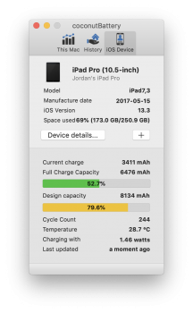

mines looking pretty bad now too. this is definitely the worst battery life I’ve seen on an iOS device. wonder What Apple would say if I took it in? Shame I don’t live anywhere near one!
If Apple's diagnosis confirms the capacity reading, you'd be getting a replacement under warranty, but given its manufacturing date your iPad is probably out of warranty?

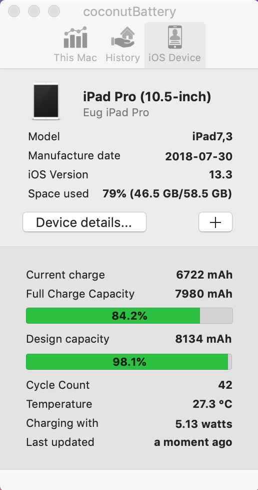

So I've had my iPad Pro replaced again, due to an issue unrelated to the battery..
The replacement unit was manufactured 43 days ago, came charged to about 80 % and with 0 cycles of course. When I first plugged it into my Mac, coconutbattery read the capacity as 7914 mAh which is 97 % of the design capacity. Now one cycle later it's at 94 % capacity, supposedly. Very curious.
I really doubt the batteries are all bad, at least not chemically. It must be something misreporting the capacity, either the battery itself, this iPad model's charge management hardware, or iOS. I'd vote for the second.
