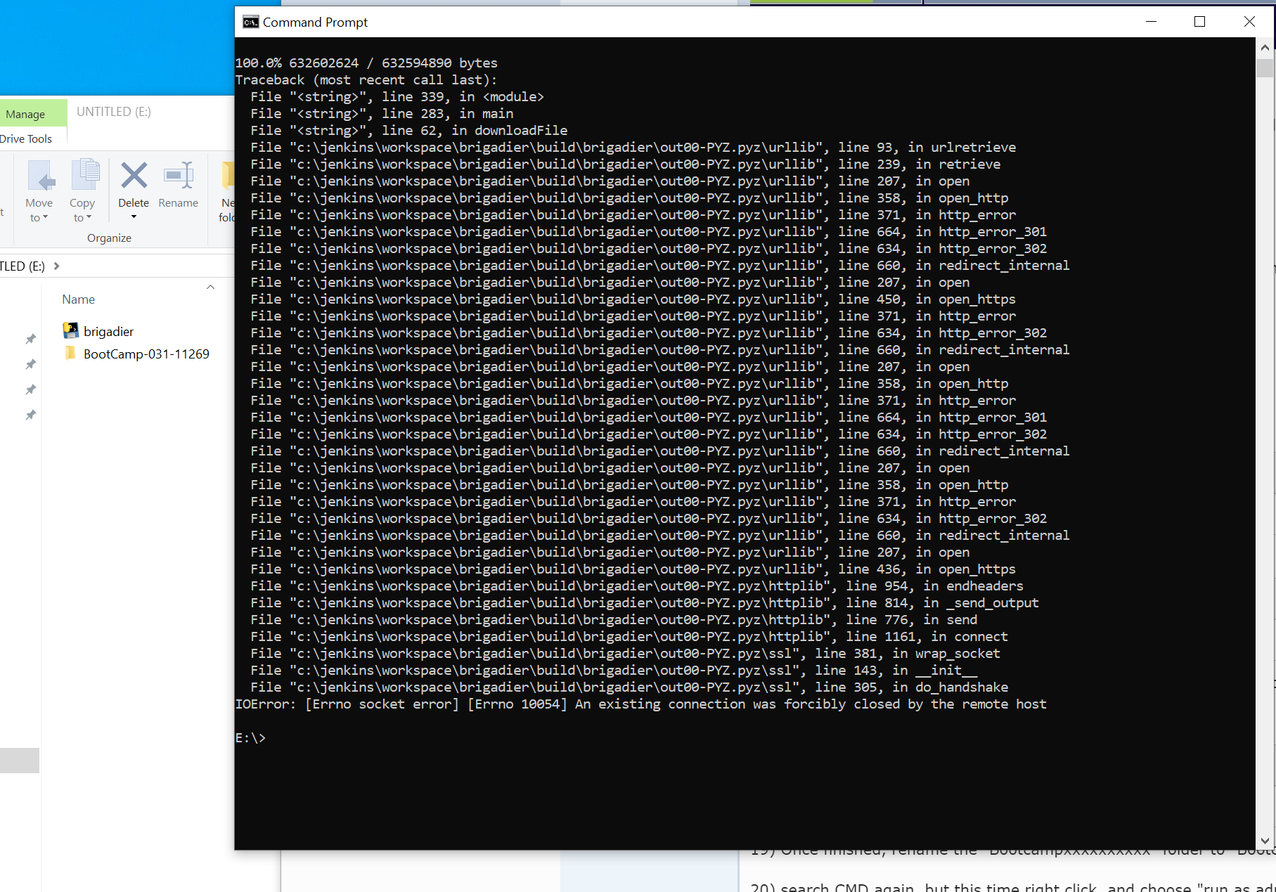

Maybe this also helps. I deleted all the temp files and tried again. You can see the folder it created on the USB drive and it's empty...

I got SO close to finishing the setup! I got to step 22 “cd Bootcamp5/Bootcamp/Drivers/Apple” and hit return and all I get is “The system cannot find the path specified”. I’m assuming in the steps before when he says to change the folder name “Bootcamp xxxxxx” he’s referring to the ones that are created on the USB? I looked inside both and they were empty. (In my case the path I used was d: since that’s where my USB is). Any ideas, or perhaps you might know how I can download these drivers manually? Thanks!

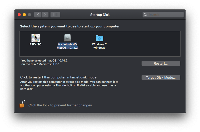

While I still can't use the Option key blind at boot, I found that the "Startup Disk" preference panel works just fine. That's not as convenient as choosing the boot drive at startup, but it's more practical than keeping a Windows 10 boot DVD in the SuperDrive at all times.
@greg97 I had a similar problem. IIRC, the path changed a little bit in the latest release of the Bootcamp drivers. Try using Windows Explorer to drill down through some of the Bootcamp5 subfolders. I think I had to actually right click on "setup.exe" in Bootcamp5 and/or Bootcamp61, and then select "Run as administrator."
Thanks for the inspiration @imrazor! I was actually able to follow the instructions from here:
NEVERMIND! I did is the hard way... dug into the temp files and put the files where they needed to go - it helped using this: https://www.crystalidea.com/blog/classic-mac-pro-and-windows
Everything went flawlessly...not sure why, since those instructions aren't too much different from post # 214 which are very similar? Anyways, now that I have Windows on my Mac for the first time, just curious if anyone is using any virus protection for Win10? (I used to use Avast on the Mac side, but was told to get rid of it since Macs don't really need it!). Thanks again!

OK in case it helps other I'm posting these notes. I followed the instructions in this thread and now have Windows 10 on a new SSD but did have and am seeing some issues.
The first was that downloading the latest release it wouldn't fit on a DVD (it was 5.6GB whichever version I picked it seemed). Thankfully I had an old DVD I had burnt of an earlier release when considering doing this before and that worked but, not until I put the SSD in bay 1. For some reason the installer said no disks existed when I tired in bay 4. I had already removed all my MacOS drives.
Once Windows was installed I followed the instructions for Brigadier and the Bootcamp drivers. At first I was getting 7-Zip errors but found after a search that running with admin rights would solve this and it did.
Windows had already installed some AMD software for my RX580 and offered to install the Logitech software for my mouse. The Mac Pro 5.1 Bootcamp drivers wouldn't install saying I needed Windows 7. The iMac Pro ones did however install and I could then see the bootcamp option to change startup disk (still to actually try once my Mac disk were back in the machine). Being an old version I ran the Windows updates and eventually got all those installed. I noticed it is the home version so can only see one processor. I've not activated it yet but assume if I buy a Pro key I can get both seen? Probably not too important for games but might be worthwhile if I find other software I need to run. I also double checked it was installed as legacy boot.

Does the disk show as bootable in MacOS in the startup disk pane of system preferences?

It looks like your Mac does think the DVD is bootable if it appears there so if you are wanting to start fresh you could erase the existing Windows drive (perhaps make a clone else where first in case you need to restore it) and remove the Mac disk from the machine. Then try again booting from the optical drive by holding down "C".

Yeah I'm using a 4,1 flashed to a 5,1; since holding C doesn't really seem to work I assume I can try setting the disk as startup? resetting pram resets it to macOS anyways
Edit: I formatted the windows SSD (exFat/mbr, I assume it doesn't matter since the windows installer formats as ntfs?), Set the installer disc as startup, turned off the mac, and booted. (I forgot to take out the macOS ssd) the installer did show up in around 5 minutes or so after booting, so I now know it works; but I had to turn the mac back off to take out the macOS SSD.
