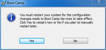

So after pressing the "Finish" button from the Bootcamp installer I'm told the computer will reboot, so I allow that.

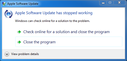

So something must have gone right, but then this message pops up:
I don't know what this means, so I choose "Check online for a solution and close the program", but the error message reappears. I also try clicking on "Apple software update" which appears to start looking for updates, but the same error message comes up again.
So, a few error messages during the installation....

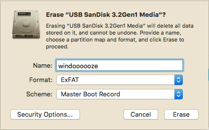

When you give some advice on formatting a drive, you might also want to tell what partition scheme you used?
I believe it was "ExFAT" that I used. Note that this isn't to prepare the disk for Windows (I believe they use NTFS which isn't an option in Disk Utility anyway), but rather to make the drive recognizable within the Windows installer.
That installer will later take care of the actual formatting, doing it the right way.
(within MacOS) do this:
  • open Disk Utility
  • select the drive you want to install Windows on (don't make any mistakes here!)
  • press the "Erase" button, a new window with several options comes up:
    • Enter a unique name for the drive (so you can easily recognize it again when you're in the Windows installer
    • Choose "ExFAT" as the format, and "Master Boot Record" as the scheme
    • Press the "Erase" button to perform the task
So when that's done you can follow the abovementioned guide (link found in a couple of postings back) where you boot from the Windows installer-DVD and so on, and just look for a drive named "windoooooze" to erase/format.

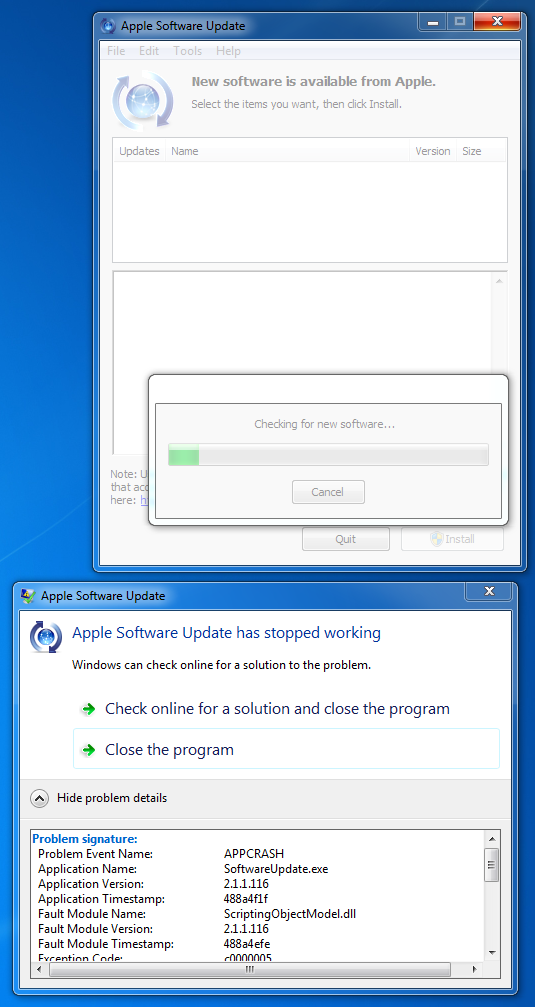

Can someone make sense of all this and tell me what to expect after having installed it all?
My understanding is that the Apple related software (which is usually a part of the Bootcamp installation) is installed using the process described earlier, using the Brigadier Windows app, but like I said, the Apple Software Update app (found in the Windows "Start" menu) doesn't work, and I have no idea where the rest of the Apple related software should be found (I've searched in all control panels etc.). Shouldn't there be an option for rebooting back into MacOS again?
And what about the error messages during the installation (KeyAgent and Mac HAL), posted in my previous posting? Obviously something hasn't been installed, but I don't know how to fix it.

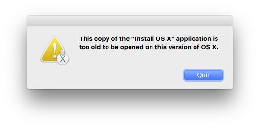

Since my main OS now is 10.13.6 (High Sierra) I think I'll install 10.9 (Mavericks) on that (physically separate) hard drive (different MacOS version to avoid confusion), and when done I'll just run Bootcamp Assistant from MacOS 10.9 and install Windows 7 the standard way. I hope that should work without any issues.
Apparently, MacOS 10.13.6 won't allow me to run the MacOS 10.9.4 installer, so I believe I have to create a USB installer from it, and boot from that USB flash drive.
Nothing's supposed to be easy, right?

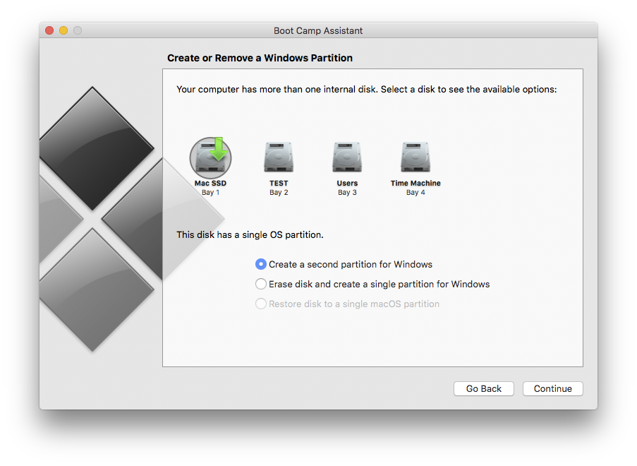

Anyway I ended up doing a reboot in recovery mode (hold CMD-R while booting) which allowed me to create a brand new MacOS 10.13 High Sierra on that separate drive (I realized that in addition to the MacOS version you can also see the startup drive's name when going to System preferences-Startup drive).
When that was done I booted into that drive's MacoS 10.13 High Sierra and ran Bootcamp Assistant along with a Windows 7 installation DVD and a newly (FAT) formatted USB flash drive as instructed in Bootcamp. Everything fine so far. The computer rebooted into the Windows installer and when I got to the part which shows the various drives (where to install Windows?) I chose the "BOOTCAMP" drive followed by "Format". This resulted in an error message:
Windows is unable to install to the selection location. Error: 0x80300024
I looked this error message up online but couldn't find any clear explanation. But from one forum discussion I gathered that I should remove any unnecessary drives, so I powered off the Mac, removed all drives but the new one (with the new MacOS 10.13 along with Bootcamp), restarted and continued with the Windows installation. This time it worked and I booted fine into Windows.

After having installed MacOS 10.13 High Sierra on the separate drive, then running Bootcamp Assistant to add Windows to the same physical drive I found something interesting which I can't remember having seen before (the second option):
Obviously I didn't want to erase my normal boot drive, and I don't think it would allow me to erase the same drive I booted from ("test"), but this would be interesting to try out some time and see if it would actually install all the Bootcamp stuff in addition to having Windows on a separate drive.
Also, would it allow for formatting within the Windows installer without any error message (0x80300024)?
