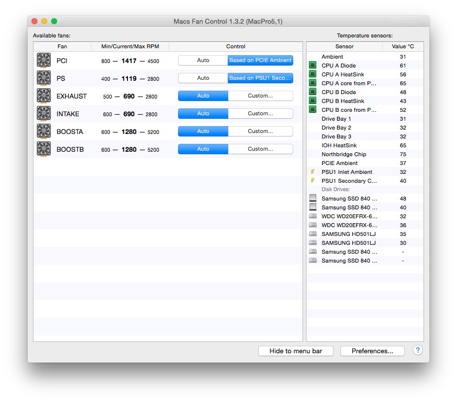

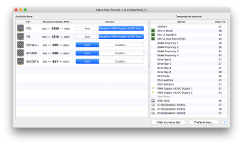

@SteveJobzniak here's another update! (BOLD = changed)
My room temperature seems to be ~4*C higher than yours.
1. PCI - Sensor-based value -> PCI Ambient: 30*C <-> 60*C
2. PS - Sensor-based value -> PSU1 Secondary Component: 30*C <-> 60*C
3-6. Auto
The last two 840 EVO SSD's (RAID0) are in an USB 3.0 enclosure, so no readings from them.
Not having any loud fan noises!
Cheers

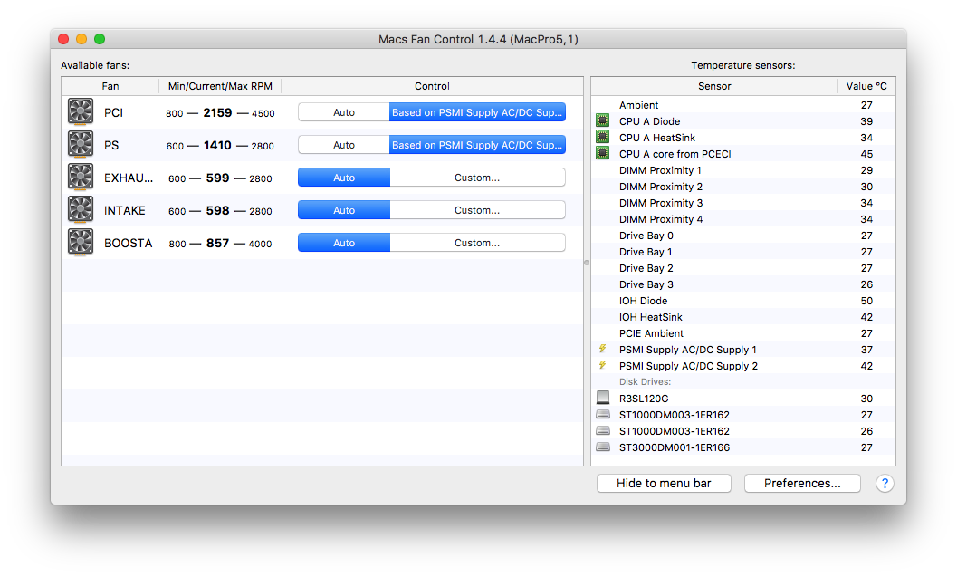

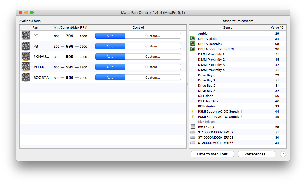

Im also suffering from this weird fan behavior.
The title and some posts mention non-EFI GPUs as a possible source for the higher RPMs. But I have ab R9 280X in my Mac Pro which I've EFI-flashed (boot screen is showing up). So I would call that an EFI-based graphics card (which shouldn't caus those problems?).
Someone mentioned already the idea of an automated 3D application like OpenGL Extensions Viewer that would just rev up the fans after startup in order to call the whole system down. It would be great if there would exists such a "hack". Manually starting something like OpenGL Extensions Viewer and then starting the tests seems a little tedious.
Actually I'm thinking about automating ffmpeg to do this job -- dunno if ffmpeg does also the trick but it's worth trying.
I have an automatic solution that runs a CUDA stress test (a modification of gnu_burn) for 30 seconds after boot up. Everything happens in the background. The fans ramp up and then settle down to normal (PCI to 800 and PS to 600 RPM).
Since CUDA is just for NVIDIA GPUs, a solution like the one that you propose would be even better. Let us know if it works.

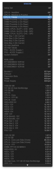

I have tested my Mac Pro 2 days with a 5770 to find out when the fans going faster, so i found this setup. On high load the system is a bit cooler than the standard SMC setup.
Room temperature 20°C (but this is not really important)
1. PCI - Sensor-based value -> PCI Ambient: 35°C <-> 57°C
2. PS - Sensor-based value -> PSU Secondary Component: 44°C <-> 65°C
Could you guys post your PSU First and Secondary temps? Mine are always above the aformentioned and recommended 35C. Mostly over 40C running towards 50C.
What's you ambient temperature?
Did you put anything in the optical bay?
Is your PSU clean (not dusty)?
I assume you are talking about idle temperature, right?
My ambient temp is around 30C.
Yes, the optical bay has a SuperDrive and an SSD installed.
I assume that my PSU is clean. Since I can't open it I think so. How do clean it?
Yes, idle temperatur is what I meant.
To clean it properly. It's recommended to take the PSU out. However, if you don't want to take the risk. I would recommend:
1) shutdown the Mac
2) open the side panel
3) remove the optical bay cage
4) Apply compressed air from the back of the PSU
If the PSU is dusty, you should able to clearly see some dust coming out from the PSU fan.

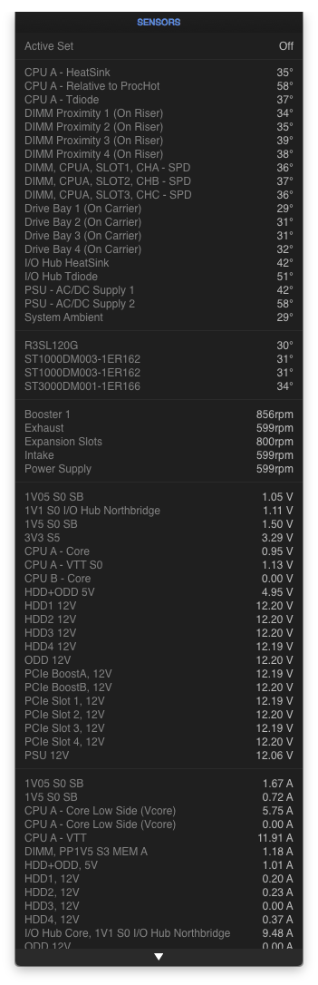

Thanks for the tip. I haven't cleaned the PSU yet, but this is my system after idling 30 minutes.
I suppose the PSU temps are too high?
