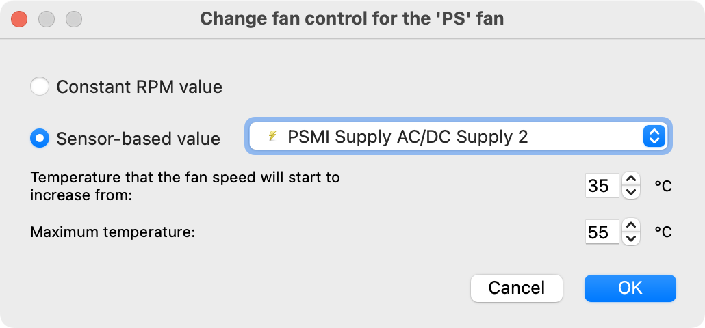

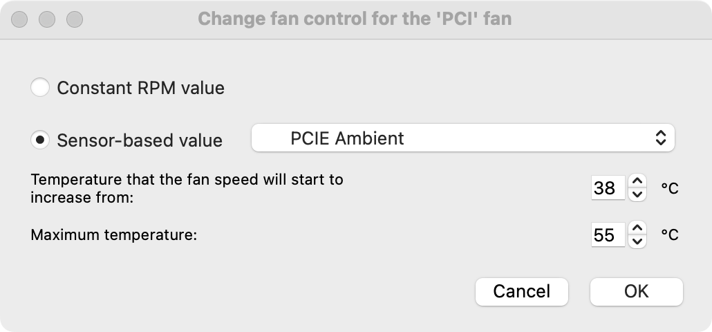

The way to set a minimum RPM is to track a sensor's temperature at idle with minimum fan. Then one sets a fan sensor lowest temperature to one or two degrees below that. That will bring the (noisy) power supply fan up to 700 or 800rpm as minimum RPM. After that adjust maximum temperature for the curve which appeals to you.
I've paid for Macs Fan Control which makes it much more fun to use: as a paid user it's possible to add as many profiles as you like and switch between them, while trying to build the ideal profile. Or for somebody who does have certain activities which require more silence (active music recording) or require more active cooling (rendering), you can have all the custom profiles you like. At €17 I was happy to send Crystal Idea some support for what had been years of free use and for the super powers. It's very cool that Crystal Idea offers a capably free version and has maintained Macs Fan Control for over a decade. I've played around with the copy cats (even own a license for one). While some have a prettier face, none are as reliable and robust as MFC. Where cooling is concerned, there's no room for buggy software.

For PCIe, you may try this value

Depends on your PSU's model number, this may give you a bit high PSU fan noise. In that case, you may adjust the max temperature to fit your own preference.

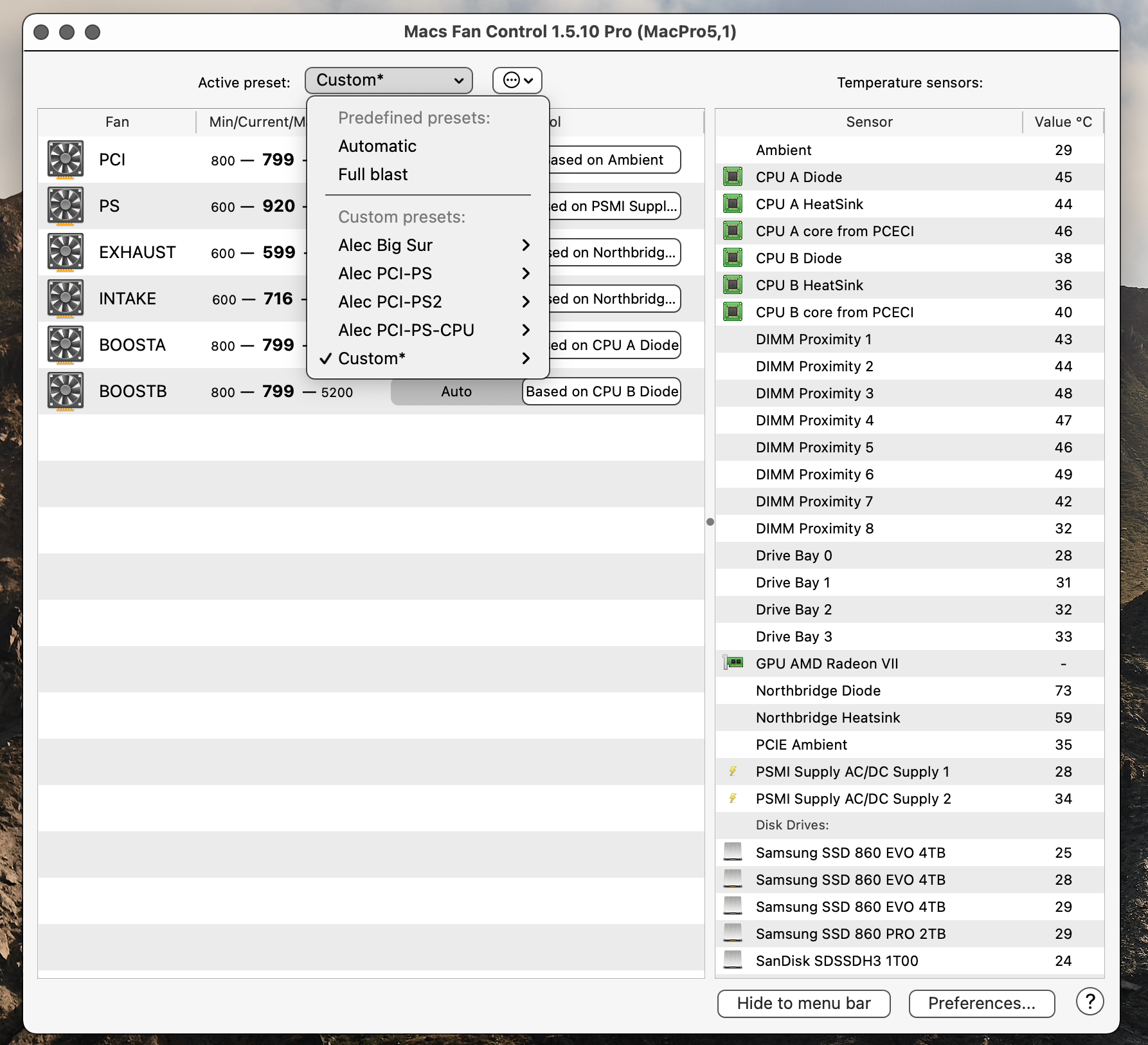

What I want is like this, mod the actual min fan speed. So that the fan speed stay at that constant min fan speed most of the time.
If use that "sensor base method", the min fan speed will flucturate base on the room temperature etc. And whenever the fan noise change, it can easily catch my attention. So, that's not ideal for me.
In order to use MFC in the way I want, I will manually set the min fan speed (via smc in terminal) to a level which just won't make noticeable noise. Then use MFC to set the fan profiles base on the sensors.
The closest you can come to this right now is to have multiple profiles (pro version) where you set (some of) your fans on fixed rate depending on the kind of work you are doing. Good idea though. You could ask MFC creators about adding a minimum speed.

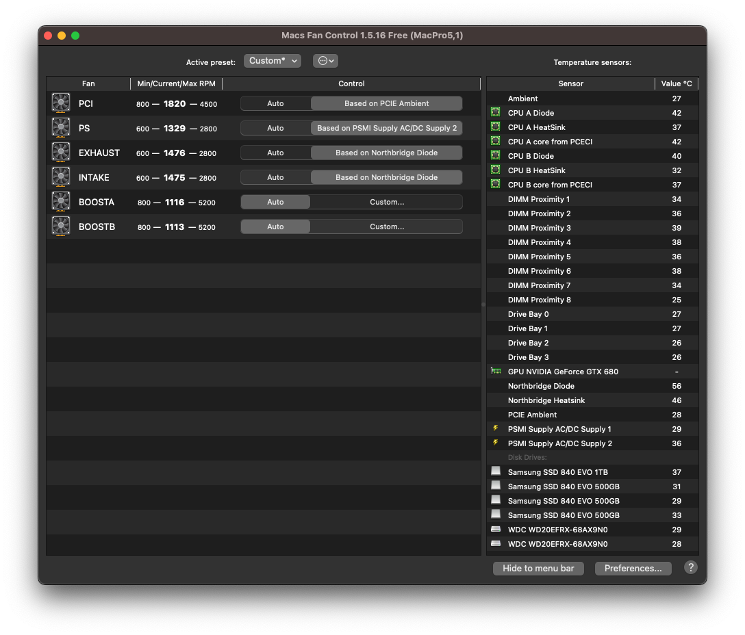

This thread has delivered and proven over the past years, to be a golden standard for keeping a Mac Pro 5.1 (mid-2012) cool and collective with no major - except fans by Apple Service - exchange / recap of components in my Mac. Still running as smooth as a Swiss Watch and celebrating its 10-years heavy duty anniversary in March 2024.
The very reliable Mac Fans Control application has proven to be a true life extension for the Mac.
