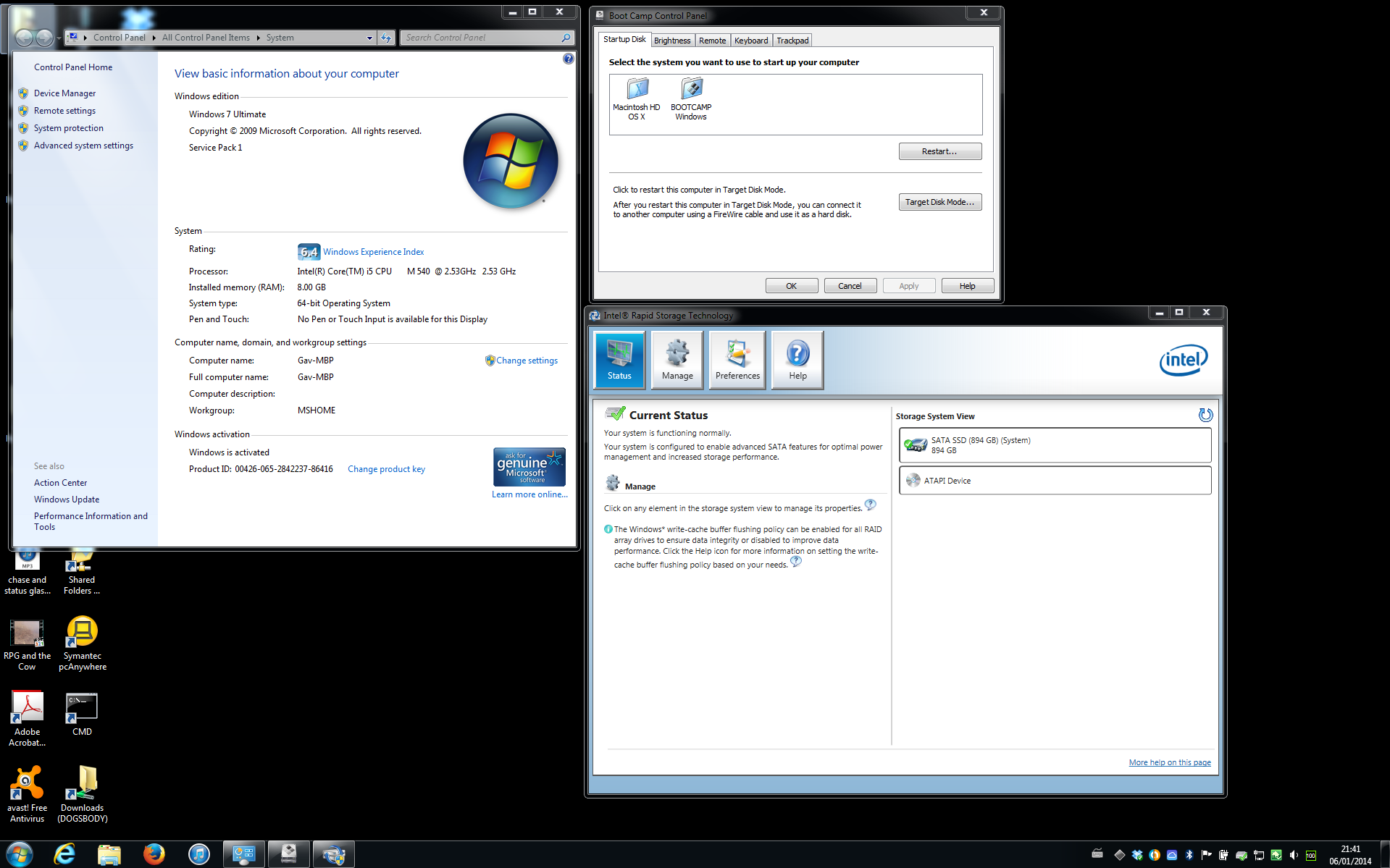

Not Mac Pro related but totally AHCI so thought I'd share this.
My 2010 17" MBP SSD went Pete Tong on New Year's Eve. Had to order a m500 960gb for next day delivery which ended up being Friday. It needed firmware flashing to 03 which fixes MacBook Pro issues which I did in the spare sled of my 3,1 running Windows 7.
Saturday I did a clean USB stick install of 10.9.1 using diskmakerx made off the Mac Pro, downloaded the latest bootcamp support onto a usb stick via BC assistant and did a 7 x64 SP1 install via DVD, then let the bootcamp 5.0.5033 drivers install automatically after. After doing all the updates and copying the data over, I set the function key setting for the brightness controls in bootcamp control panel saying farewell to ever seeing it again. I modded the AHCI and IAStor registry keys, rebooted into Mavericks, patched the mbr using Johnsock's enabler app and got AHCI running. Updated to the newest Intel RST driver which had the chipset support for the controller which was about six months old - version 11.7.0.1013.
All running great, so out of curiosity last night I thought I'd open up the Windows bootcamp control panel to get the usual startup disk error. I didn't and got a fully working windows bootcamp control panel, the first I've ever had on an older Mac after I've done the AHCI mod :D. This is the fourth time but lucky on this alone add my other Macs plus clients it easily runs into dozens!
It's going to be a while before I do that on my 3,1 but maybe that method might work for some of you lot!
