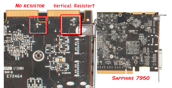

Here is a shot of the back of the Sapphire 7950 Mac Edition. Checking against boards with the same layout from MSI and XFX, (thx newegg) their layouts, as well as Gigabyte's, has two horizontal resistors in place.
On the 7950 Mac Edition
(Left Resistor) appears to be missing
(Right Resistor) appears to be in a vertical Orientation.
Can someone confirm what resistors are in place on the back of the 7950 Mac edition?

Is it possible there is no resistor on the left of the sapphire card because there is no crossfire on OS system?
It will be great to have confirmation of the resistors in place...
Such logic inputs usually default to a certain value set by on-chip pull resistors if no external resistor is present.
I would therefore take a 10k 0402 resistor and test both positions... this is very unlikely to damage the card in any way.

Muahahaha!!! Great news!!! Here is what we know:
There are two different PCB layouts:
PCB Layout A) 7950 - 7950 Mac Edition & Others - chips below crossfire connectors with horizontal / vertical orientation. No resistors .
PCB Layout B) 7950 - Most cards on Newegg - chips below crossfire connectors with 45 degree angle layout. Two resistors
1) SAPPHIRE FleX 100352FLEX-2 Radeon HD 7950 - Layout A - 2 resistors at this location. Hmmmm
2) HIS H795QMC3G2M Radeon HD 7950 3GB - Layout A - No resistors at this location
3) SAPPHIRE 100352-2L Radeon HD 7950 3GB - Layout B - 2 Resistors in place.
4) GIGABYTE GV-R795WF3-3GD Radeon HD 7950 3GB - Layout B - 2 Resistors in place.
5) Cards with the resistors in place list their specs showing: Effective Memory Clock: 1250MHz (5.0Gbps)
If anyone is flashing their card with the modded EFI Bios, would be good to hear what card you have and if you are running at 5.0GT/S
I have a powercolor 7950 PCS+ (Layout B =2 resistors).
My rom is flashed (I have the boot sreen). I removed the two resistors but the card still running at 2,5GT/s. I tried also with the two resistors at vertical position but It runs also at 2,5GT/s.
So It seem's we must find another solution....

Excellent progress. Modifying two of the positions at a time may be hiding the result we are looking for. Luckily, there are more combinations to try. One of these hopefully should deliver what we are looking for. Hey MacVideoCards - any thoughts?
Left = towards power connectors
Right = towards video connectors
Left - vertical | right - none
Left - vertical | right - horizontal
Left - vertical | right vertical No effect
Left - Horizontal | right - none
Left - Horizontal | right - horizontal
Left - Horizontal | right vertical
Left - NONE | right - none - No effect
Left - NONE | right - horizontal
Left - NONE | right vertical

Well we can't be that far off. It has to be one of the two points I identified - just need to find the right combination. Would be a great share to the community here at MR. After all, most Mac users are afraid of using a 3rd party card, let alone to modify one.
Unfortunately I don't have experience soldering at that size nor the right equipment else this would be a non-issue.
It seems no resistors near crossfire connector.
