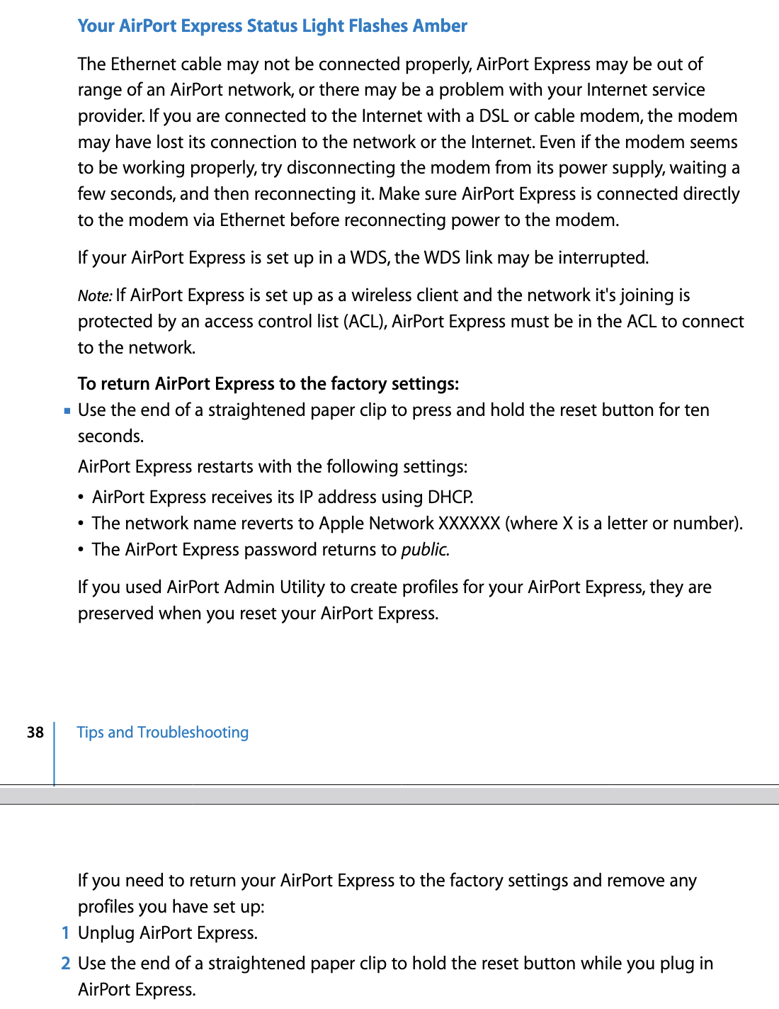

I don't know if this helps, but the manual mentions deleting profiles near the end of the page so that is a different reset than the standard one:

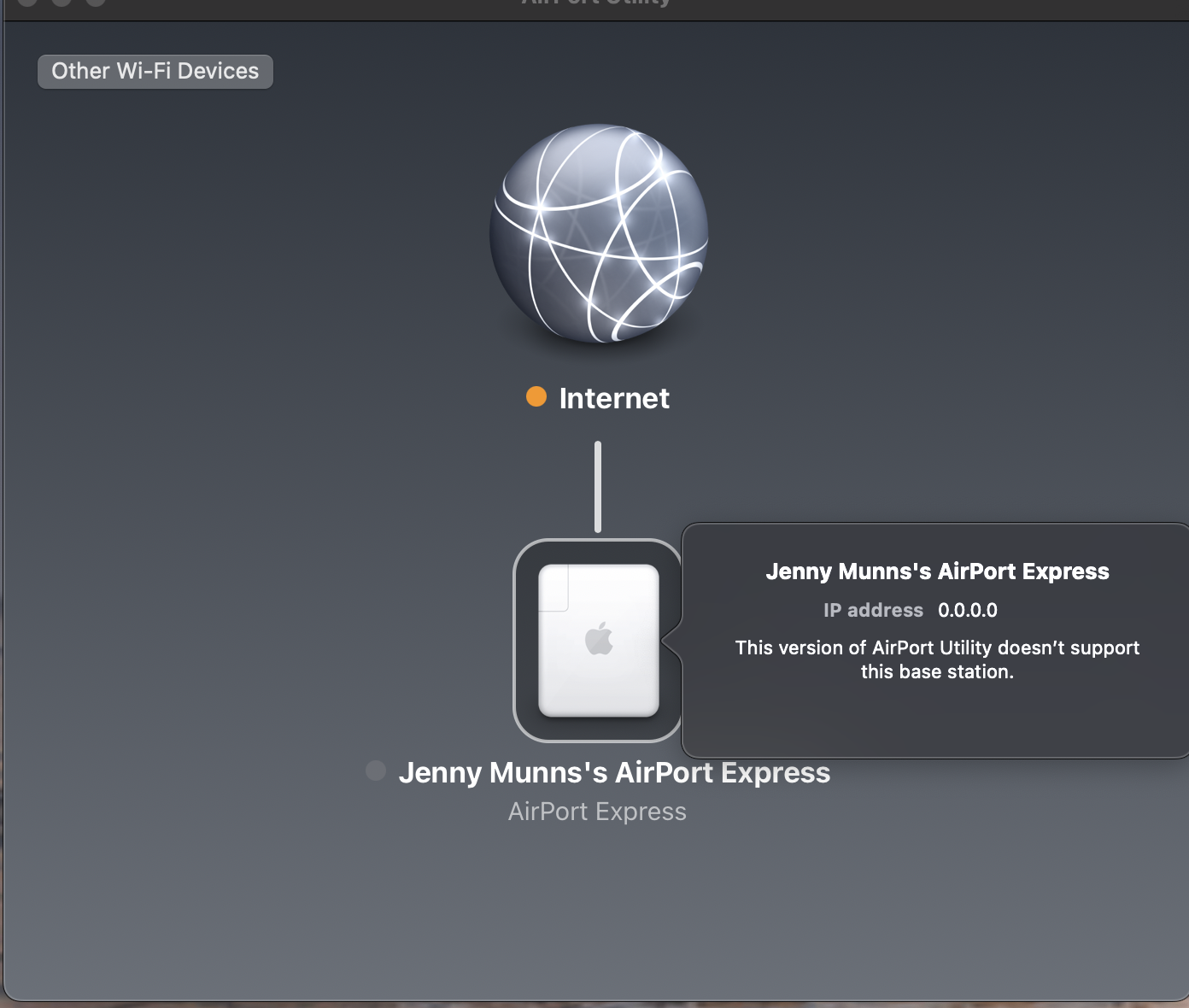

OK. I downloaded Airport Utility for Windows 10 via Boot Camp and Win 10 has recognised it. I've configured it as a separate network and it now shows in Airport Utility on my Mac but states that I need an older version of AU. When I've googled and found an older version it states that it will only run via an emulator. This means I can run it via my Win 10 Boot Camp but is there any way I can run it straight from the Mac?
What model of Airport Express are you trying to install? You should be able to do this from your Mac rather than Windows. If you have the first model, the 1084/1088 that is not really useful anymore. It would require an older installer but it's so old that it's not secure as I recall.

A1008 - the very first AE. Having got Windows to recognise it and my Mac AU to recognise it, I'm not about to give up just yet. There's an answer out there somewhere!
If it recognizes it, then Airport Utility should be able to install it for your network. I have one of the first ones and I did have to use a really old version of Airport Utility but this was a long time ago so I don't recall the version number. Did it tell you what version of the utility you need?
According to the Wiki, version 5.6.1 for Windows should be able to access your older AE:
There is no A1008: it's either a 1084 or 1088.

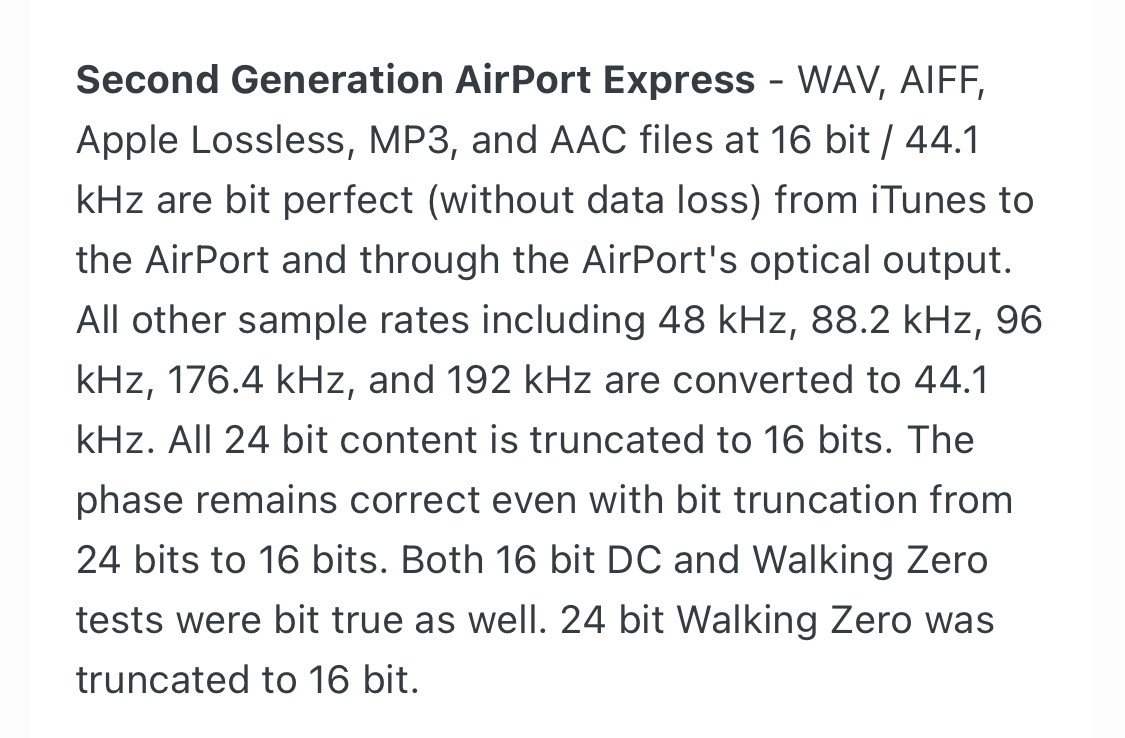

The problem with the 2nd generation Airport Express units is that they're not bit perfect with the later firmware so either you roll back to an older firmware or have a lesser quality audio using AAC streaming protocols. The earlier firmware used Apple Lossless. If you search some various forums, you'll see that many are using the model 1264 to avoid the audio issues that the later model has.
EDIT: I forgot to mention that the Music app on a computer can access the multiple speakers option just like iTunes but I still prefer iTunes so I use that. It still works installed with the Retroactive app even on my M1 Air running Sequoia though the author of the app has stated it is getting no further support:
sauce? info on versions?
That's a really old article and was accurate at that time since the newer AirPlay 2 firmware wasn't out yet.
There are numerous posts about the audio quality downgrade due to the newer firmware 7.8.1 and here are two:

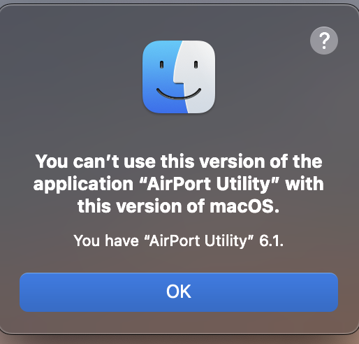

What MacOS are you using? Apparently, the utility app is too old for that OS. The latest one on my M1 Air is 6.3.9 for example but there were others in between. I know you said you needed an older version for that Airport Express but MacOS will flags apps that are not compatible.
The only thing is to try using Windows as you stated earlier or possibly make a Virtual Machine but if you're never done that, it would take more time than it's worth just for this one issue.
Thanks for that. It will certainly run from Windows but I need to reconfigure it so it appears on my usual network. I do have VM in abeyance so I could fire that up. You're probably thinking if it's ever worth it but I do like a challenge! Thanks for your help.
I think the problem with the original Airport Express is that it's a b/g wireless device and newer routers don't see that or if they do, it's ignored. Also, there is the security issue: WPA vs WPA2. I think those early devices only had WPA or some lesser security which is not recommended today. I think I still have my original unit and will look tomorrow and see if it still works and see what security level it has.
