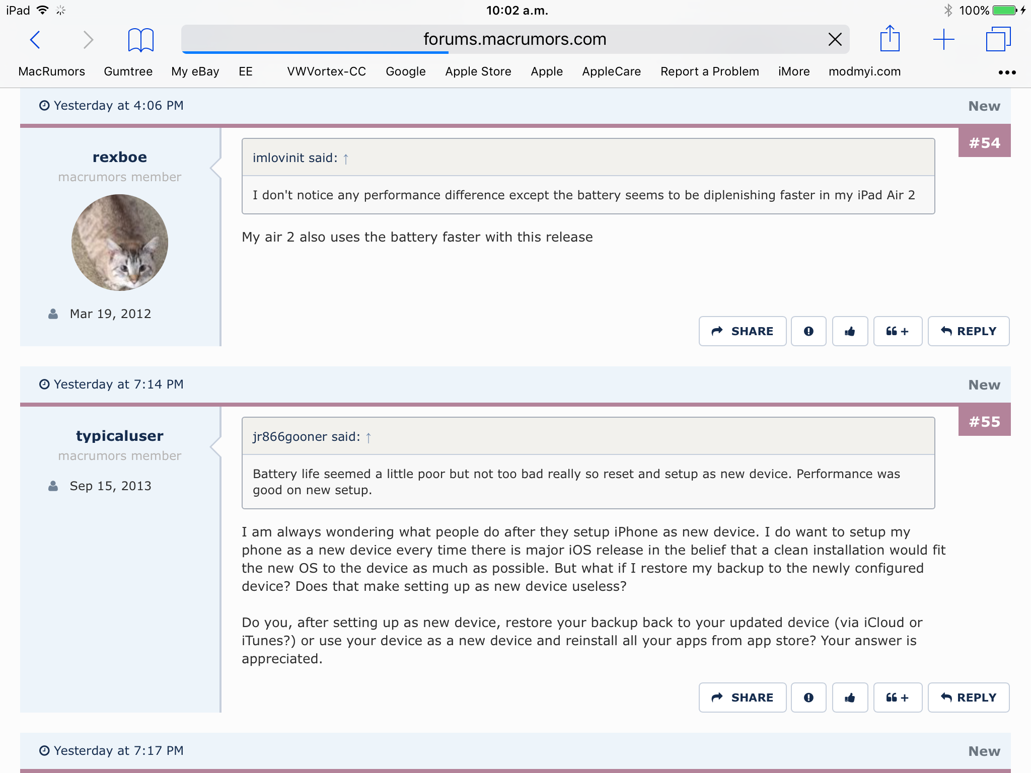

Battery life seemed a little poor but not too bad really so reset and setup as new device. Performance was good on new setup.
I am always wondering what people do after they setup iPhone as new device. I do want to setup my phone as a new device every time there is major iOS release in the belief that a clean installation would fit the new OS to the device as much as possible. But what if I restore my backup to the newly configured device? Does that make setting up as new device useless?
Do you, after setting up as new device, restore your backup back to your updated device (via iCloud or iTunes?) or use your device as a new device and reinstall all your apps from app store? Your answer is appreciated.
I always restore backups. The key is to afterwards use the "reset all settings" option. That defaults the settings to the new iOS version defaults and clears any hung up items. But restores your apps and data. This has been a known solution to battery and other issues after an update of iOS. Of course you have to run through your settings to setup as you prefer but you would have to do that on a clean install too. Always worked fine for me doing it this way. (and sometimes don't really need to reset) Only if having issues afterwards or typically a good idea with major version changes of iOS. Most of the time there is no need for a "clean" install. If you want a full "clean" install so to speak use iTunes to do your updates. It downloads the full iOS not the deltas that the OTA does so in effect it is a clean full install od the OS.
