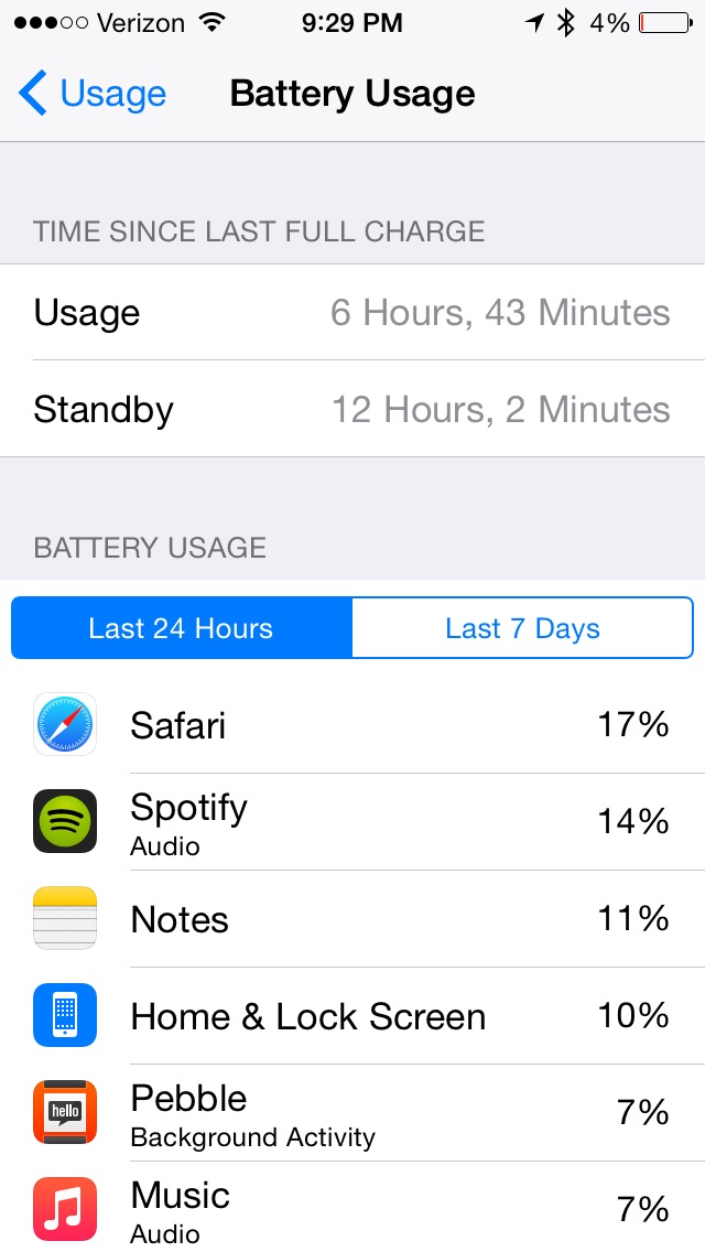

Had to share this here: I finally have a decent amount of usage time on a single charge. Now that is what the battery should be like.

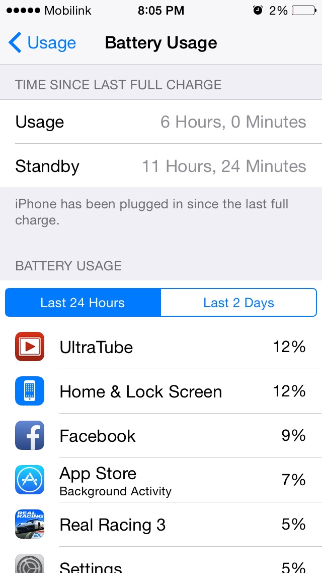

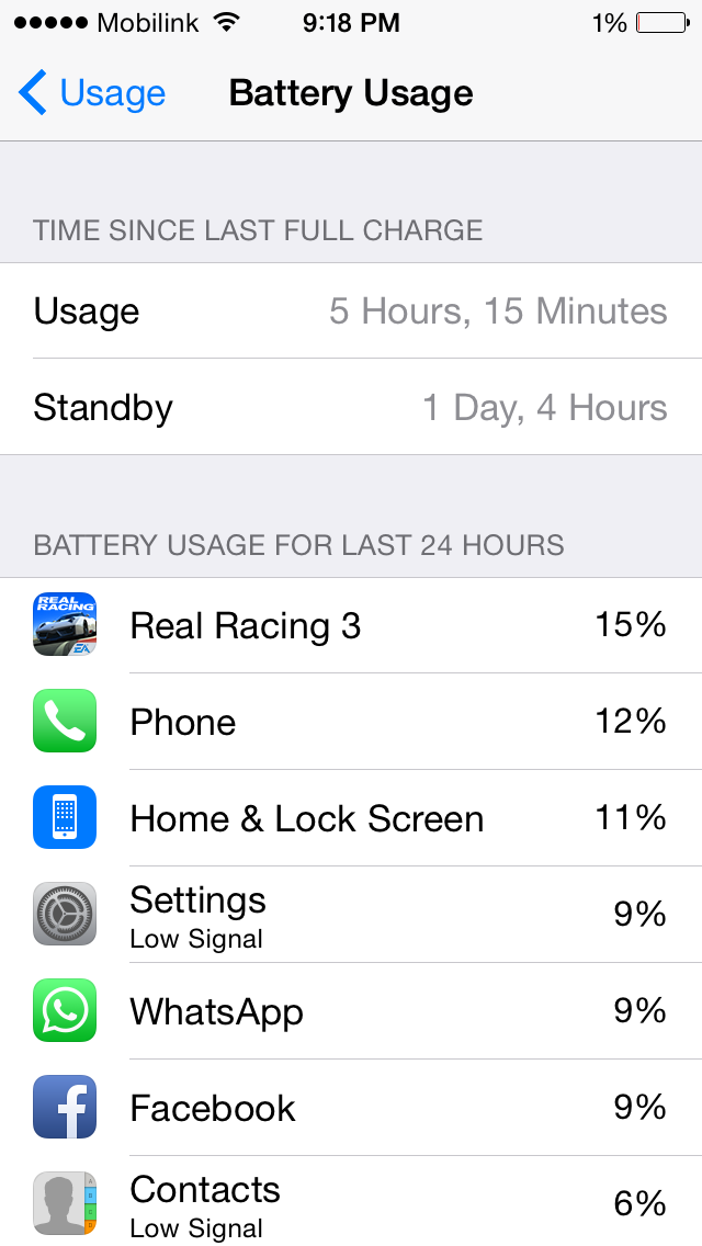

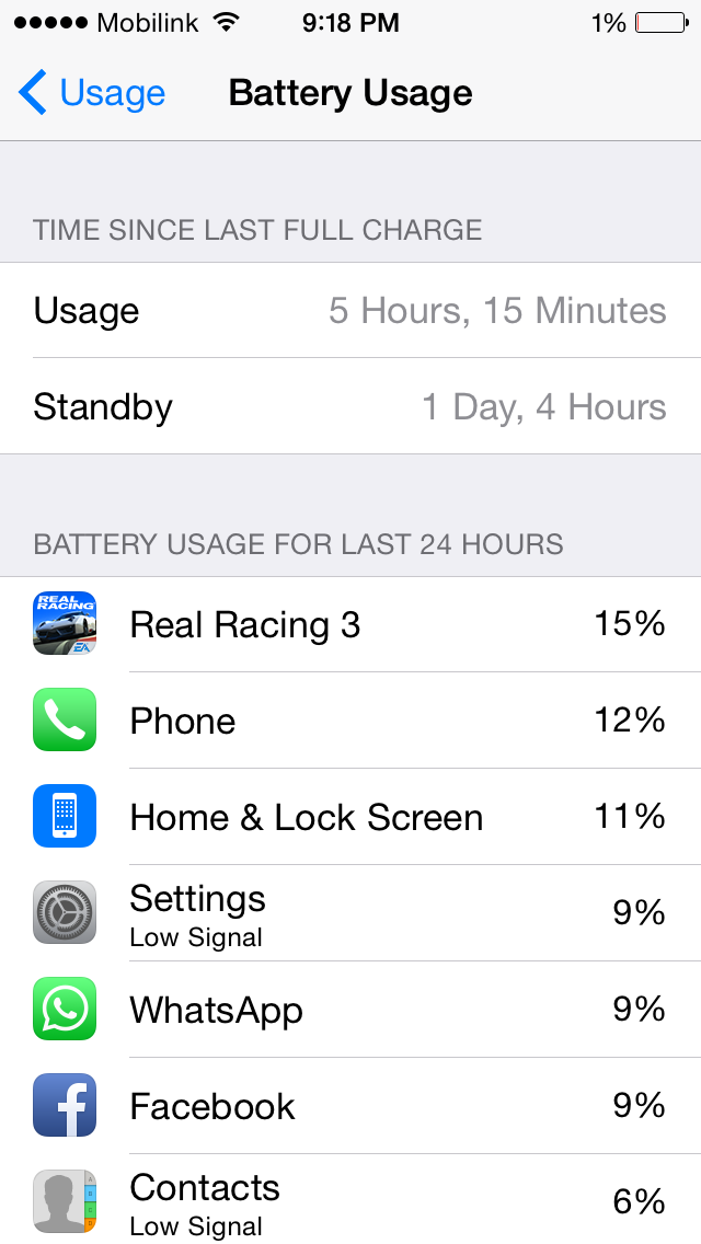

Results
Here are the results from the first charge/discharge cycle post restoring as new..
Screen brightness: Auto
Location Services: On for google maps and weather only
Background refresh: On for facebook, linkedin, watsapp
3G/Wifi: 3G while at work, Wifi at home
Usage mainly included some texts, decent amount of phone calls, facebook, flipboard, web browsing and some real racing 3

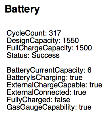

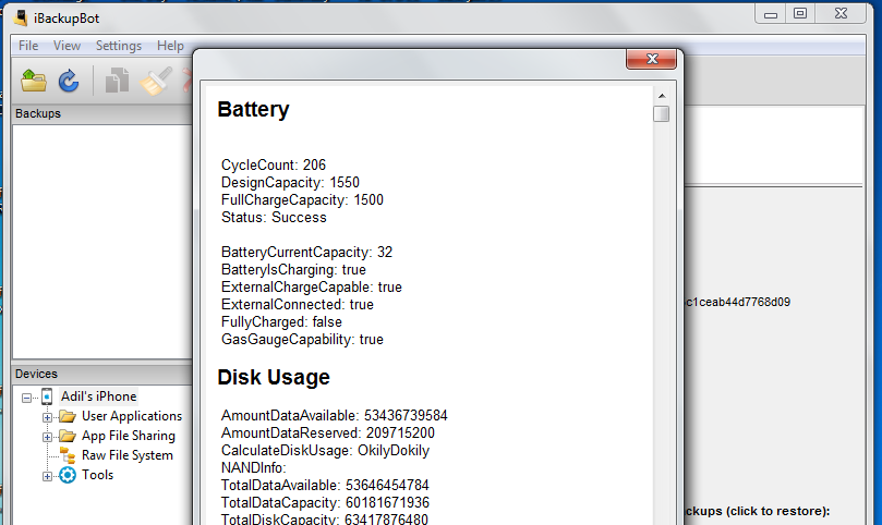

iBackupbot has ability to report battery health without jailbreaking.
Note this is an app you install on your mac, then open with your iPhone connected to the mac. (screenshot below is from "more information" after selecting the phone in the "Devices" section.
It is pretty expensive but has free trial mode which works.
Googling around it seems to have a mixed reputation, including not being accurate. But I have also seen a thread where it gave the same results as a jailbreak app. I have used it on a very old 3Gs, a less old 4s, my 6+ and now my wife's 5s, all with credible results.
"Battery Current Capacity" in screenshot is %

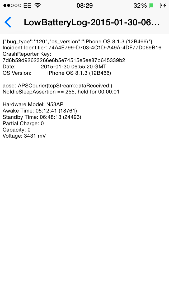

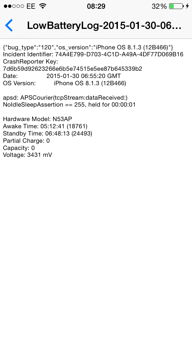

Poking around in my wife's phone's diagnostics info, I found this "low battery log".
Doesn't seem to tell me much, and so inclined to ignore in view of the iBotbackup result and Applecare diagnostic in my #838 above.
Does it mean any more to anyone else?

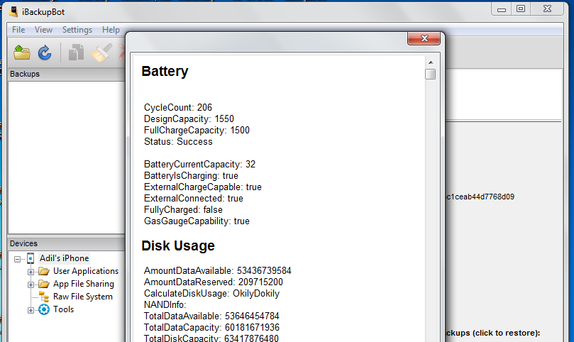

ibackupbot results
Just ran it..
According to this seems my battery is in pretty good shape? Still i only get max 5-6 hours of usage time

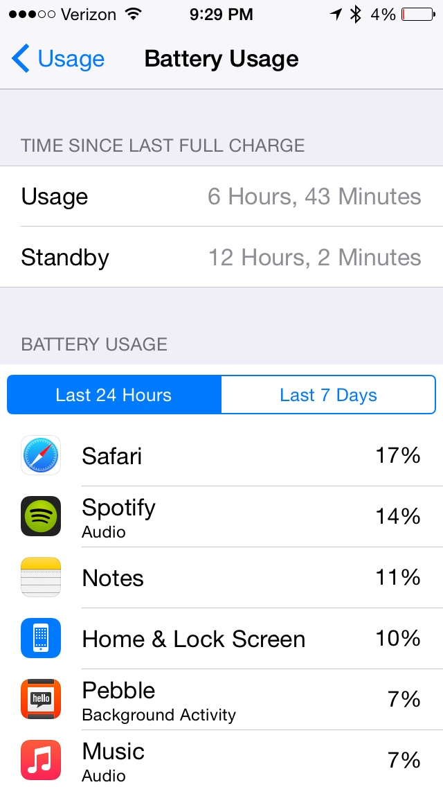

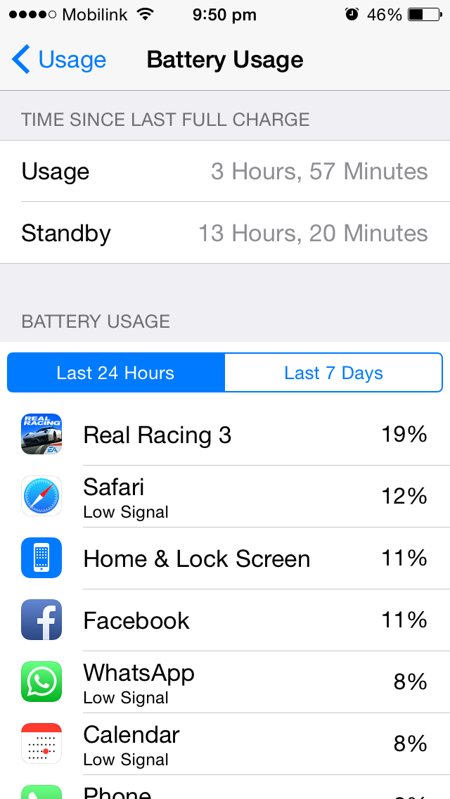

2nd discharge results after restoring as new. Used it heavily today. Mind you, out of the total usage time more than 90% was screen on time. So that's not bad considering most comparable android devices give roughly 4 hours of screen on time..still not as good as iOS 7 battery life though

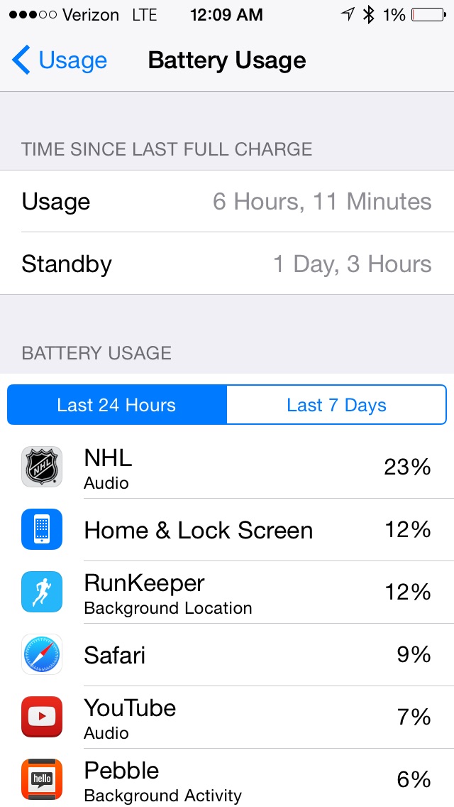

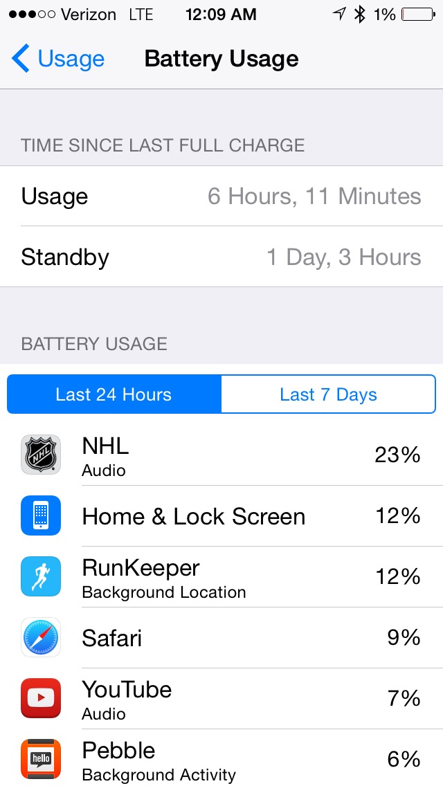

Here is my last charge.
Some of it towards the end was streaming radio; but still I guess that used significant battery, so I guess this is about average when having a pebble connected.
