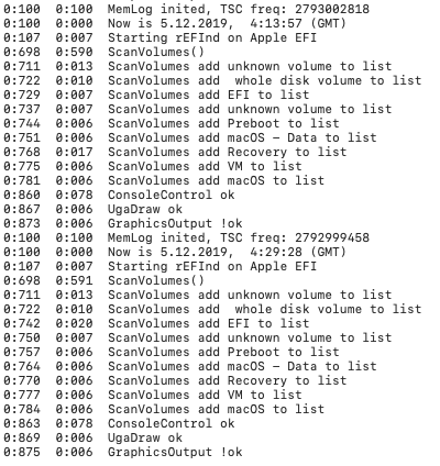

I tried doing the bless command again with different settings. Asked for the admin password and it seems to have taken but the same thing - black screen with refind running. Here's the latest entries from the refind.log.

Well refind is loading and the logging is primitive but it shows that it is failing for graphics output. (!ok means “not ok”) so it could mean the card you have doesn’t have GOP firmware or perhaps a resolution is trying to be loaded that isn’t valid.

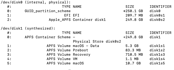

This is my diskutil list:

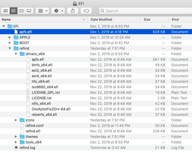

I use ESP Mounter Pro to easily get into my EFI partition.
I run your command to bless the file:
sudo bless --mount /Volumes/EFI --setBoot --file /Volumes/EFI/EFI/refind/REFIND.efi --shortform
I did not use the chown command as I used Kextbeast from Dayo's instructions. The card does work once I'm in Catalina. I'm going to try going through the steps again with the RX 580 already installed.
