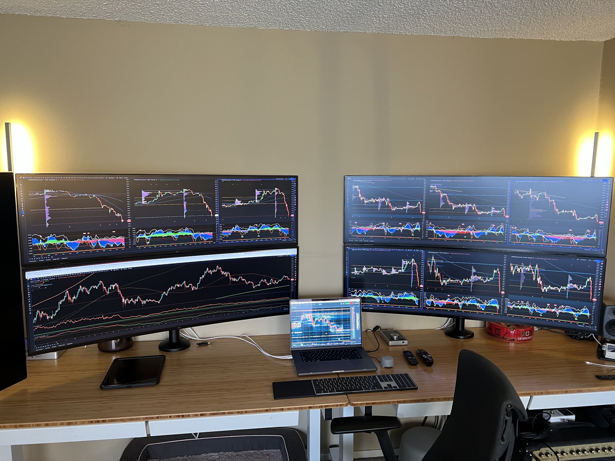

Bought my M1 Max for daytrading. Needed a fast powerful laptop for running apps and charts, and able to run 4 x 49” widescreen monitors. This replaced a 12 core Mac Pro 5,1. Best computer I’ve ever owned hands down.
