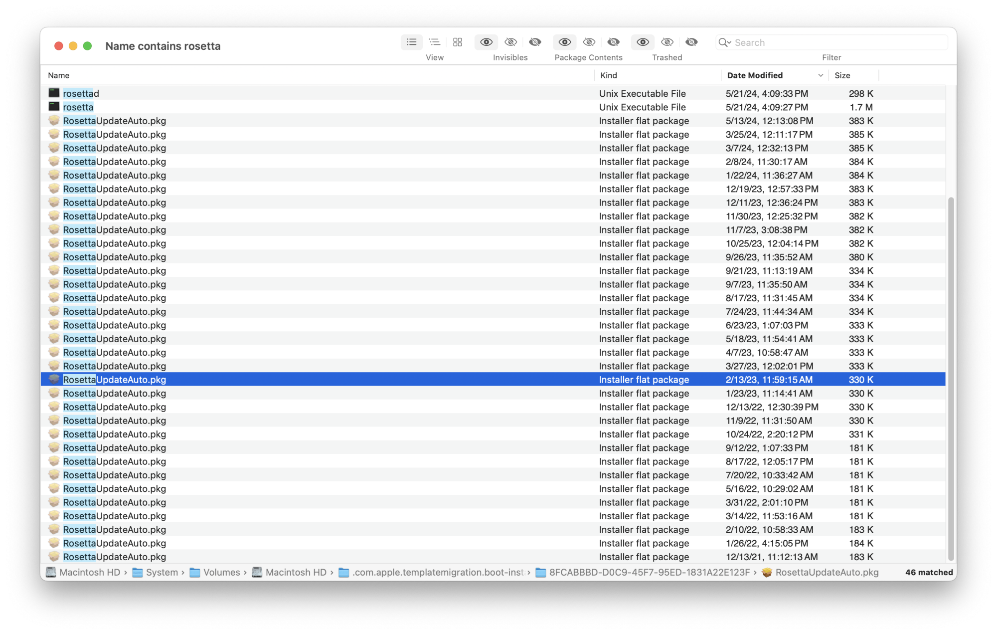

Here is a screenshot from Find Any File app.
Looks like the OS is saving all those old Rosetta installers in a hidden folder.
I couldn't find anything while booted normally, but in recovery I find 4 instances:

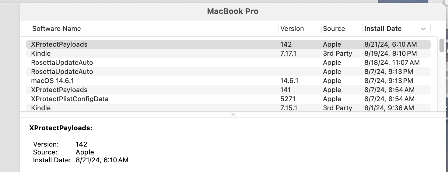

Xprotect Remediator was updated some time yesterday, so maybe that was it.
In ~/Library/Preferences/com.apple.preferences.softwareupdate.plist ProductKeysLastSeenByUser I have MSU_UPDATE_23G93_patch_14.6.1_minor. I didn't see any phantom notification so far in Sonoma 14.6.1 (23G93)
The folder for the current XProtect update is 062-54041, the link for the pkg https://swcdn.apple.com/content/dow...c7seo2e6tdwivhodil/XProtectPayloads_10_15.pkg The version is 142.

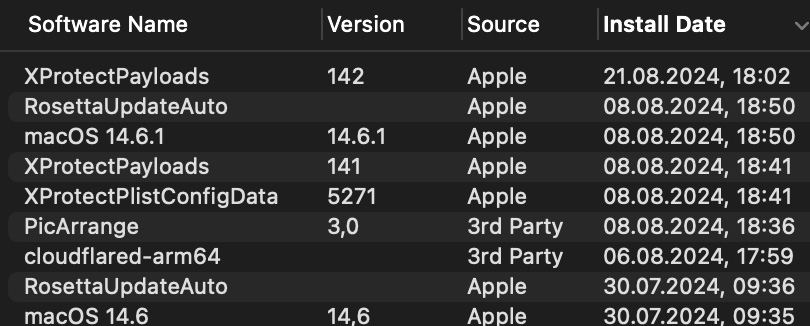

The are the updates installed on my MBA since 14.6
My softwareupdate.plist shows the same MSU_UPDATE_23G93_patch_14.6.1_minor, which corresponds to the last non-phantom software update notification on my MBP. The timestamp on the XProtectPayloads install corresponds closely with the appearance of a spurious notification this morning.

Could you look at my previous post to see if you can correlate the time of your notification with something being installed? Aside from running system_profiler, you can also see what's been installed lately in System Information, under Software -> Installations. Click the Install Date heading to sort in reverse time order to see the last thing installed at the top of the list (it's XProtectPayloads for me). Thanks!
I just got another spurious notification, but without a corresponding install. So, there goes that theory.
It's not a stuck Rosetta update for me. (It's happening on an Intel iMac.) I'm on 14.6.1, I get the dubious update notification, but /Volumes/Macintosh HD/Library/Updates only contains index.plist and ProductMetadata.plist.
14.6.1 was installed on 10 August. XProtectPayloads 142 was installed 21 August. I honestly can't remember now if I was getting false alerts prior to that being installed. I'm still getting them daily and the last software update (Goodnotes) was on 23 August, so it's not tied to a non-OS update notification.
