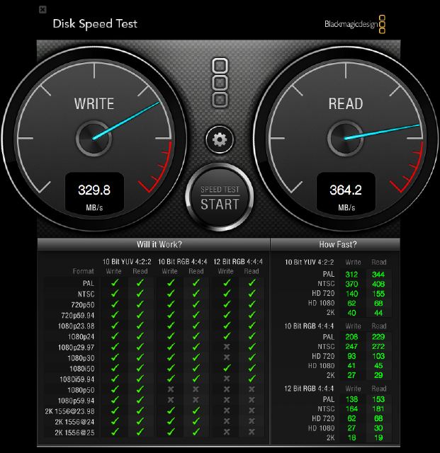

Get 330 MB/s Write and 364 MB/s Read speeds on my Seagate Thunderbolt adapter connected to a Samsung 830 series 256GB SSD
I see people getting near 500mb/s read on internal sata interface, surprised to see such a difference compared to thunderbolt.
My thoughts exactly. I wonder why? TB was supposed to have no overhead (unlike USB) to make transfers as fast as internal connectors.
Perhaps , the Seagate implementation of Thunderbolt in this adapter is a bit slower. I don't mind it actually as it requires no power supply.

The adapter is only SATA II. Internal is SATA III.

not correct the seagate t-bolt is sata iii . it has latency due to the 2 chips needed at each end of the cable. it can push 380 mbs read write on a long clone if the mac mini has a ssd mounted on the inside.

To further philipma's comments,,, Thunderbolt is an exposed PCIe lane. Thus it requires a Thunderbolt controller at each end, plus a controller for the device connecting to Thunderbolt. In this case a SATA III controller. Its well known that Intel Sandy Bridge and now Ivy Bridge SATA III controllers are the fastest on the market. Marvell and others are far slower. That's the real difference between the Seagate GoFlex Thunderbolt adapter and an internal drive. Even when these other SATA III controllers are integrated into ATX motherboards, they are slower and prone to performance issues.

However, the slower performance over TB has nothing to do with "the chips at the end". The TB interface supports 2 x 10Gb/s bi-directionally, even through the "chips at the end". Just using 1 10Gb channel means it would max out at over 1Gbyte/s not 380MB/s.
380MB/s is clearly slower than the 500MB/s+ you get if you install the drive internally so this must be down to the slower performance of the Seagate controller.
