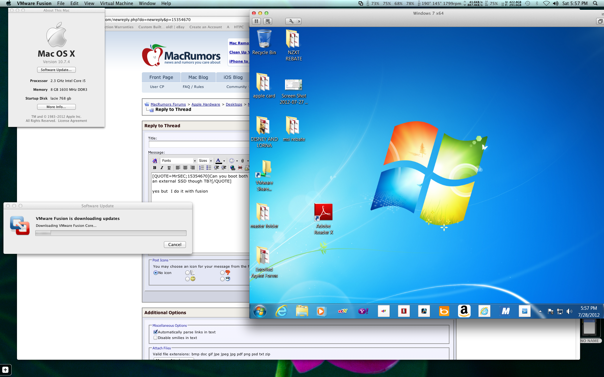

Can you boot both windows/OSX(partitioned) from an external SSD though TB?
yes but I do it with fusion. it can be done with bootcamp some posters have done it .
