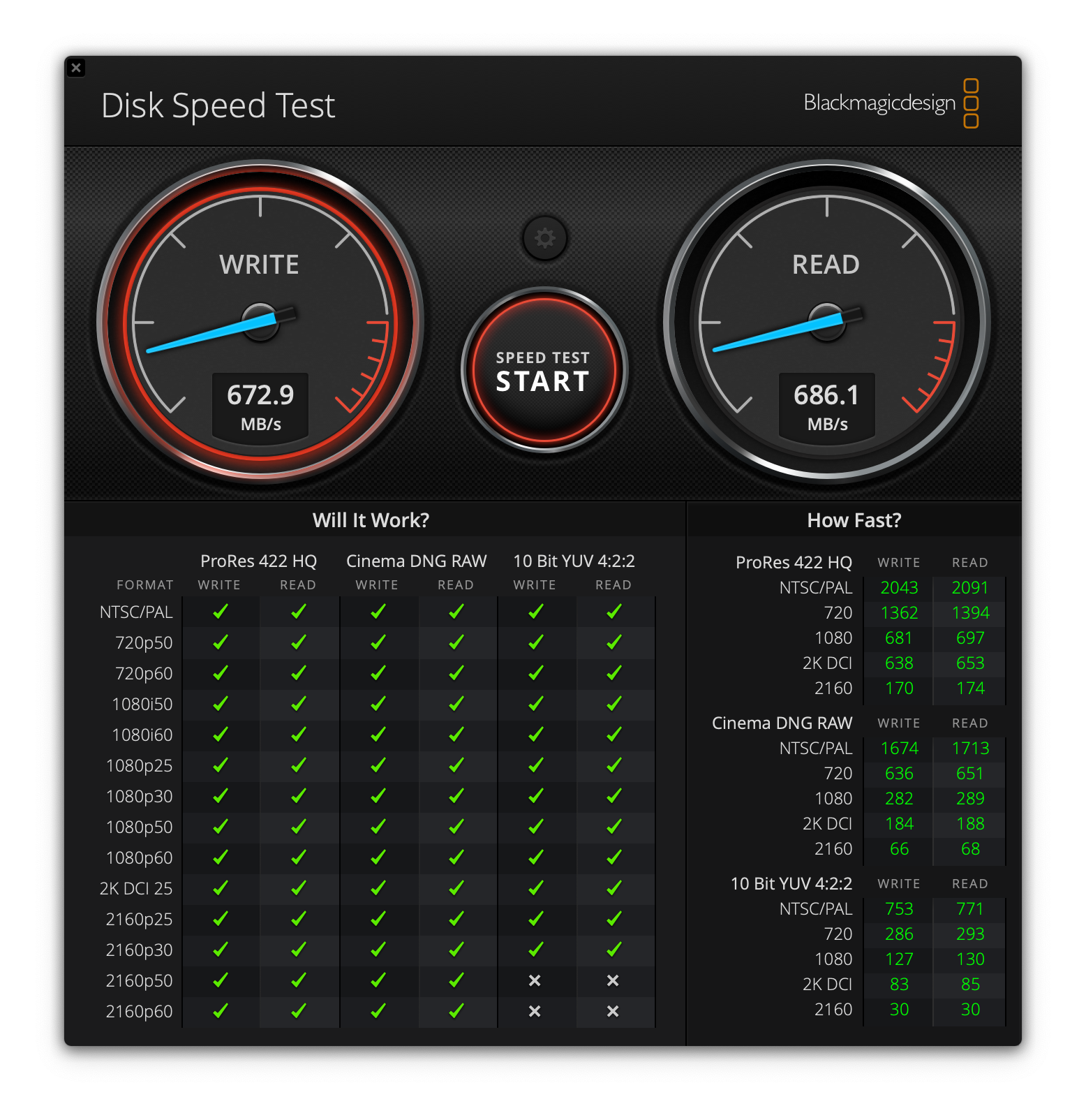

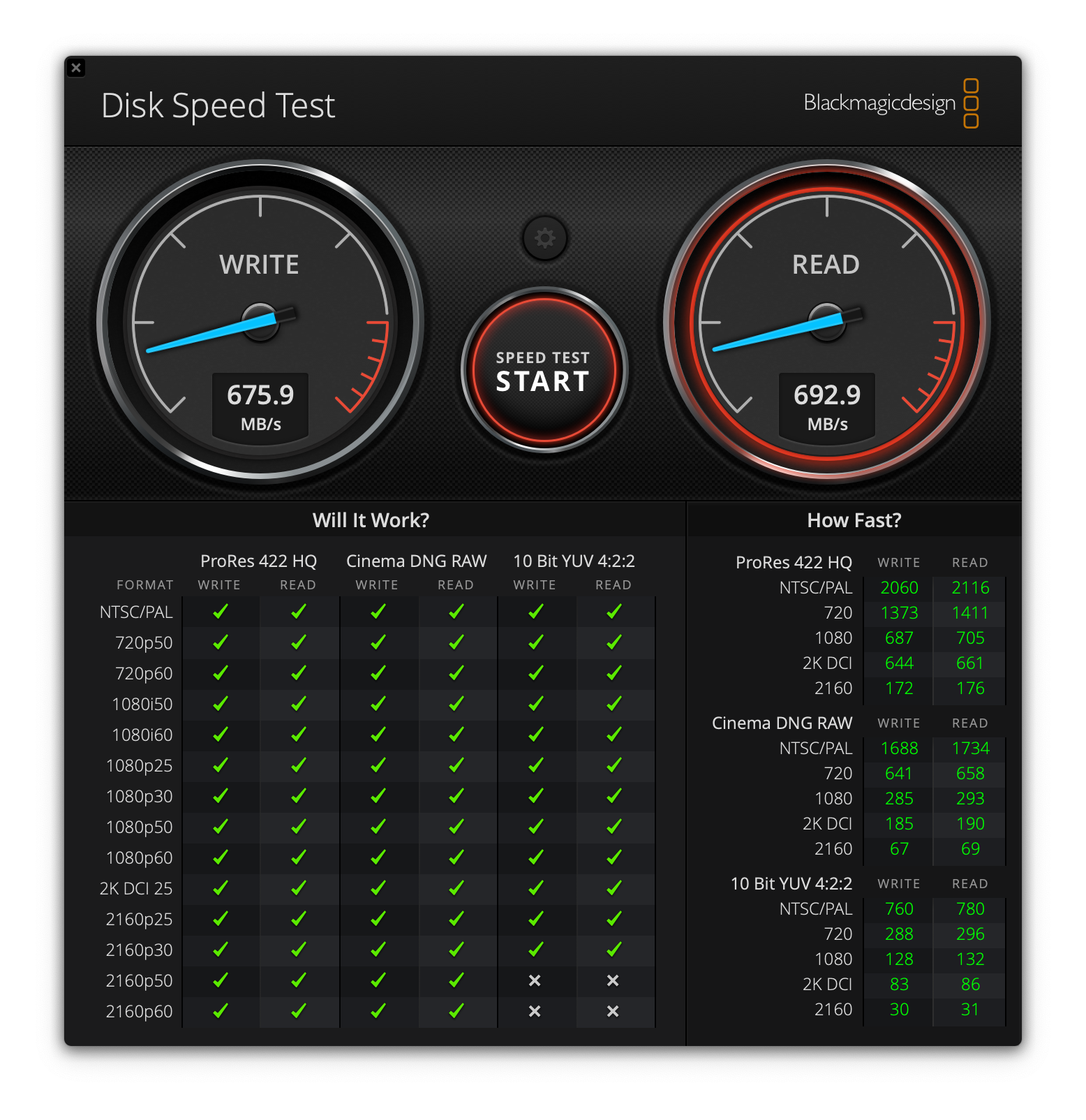

"Date Added" does not work on this ExFAT file format (Tested on Big Sur 11.1 @M1 Mac Mini)
Thank you for asking. I found the answer to my question. It's ExFAT. And here is the test results for various partition schemes / file system .. (I triple checked the numbers after posting and I tested the one with APFS many times over to be sure)
I'm definitely going to use the GUID-APFS. It's clearly fastest and also because "date added" works on anything but ExFAT.
mbr-exfat
mbr-extended journaled​
apple partition map - extended journaled​
GUID-apfs​

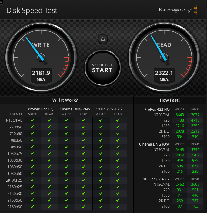

Just in case you’re interested, here’s a speed test result for my 1TB Sabrent Rocket NVMe drive inside a Wavlink TB3 enclosure. It is directly attached to my M1 Mac mini.
Reactions: hobowankenobi

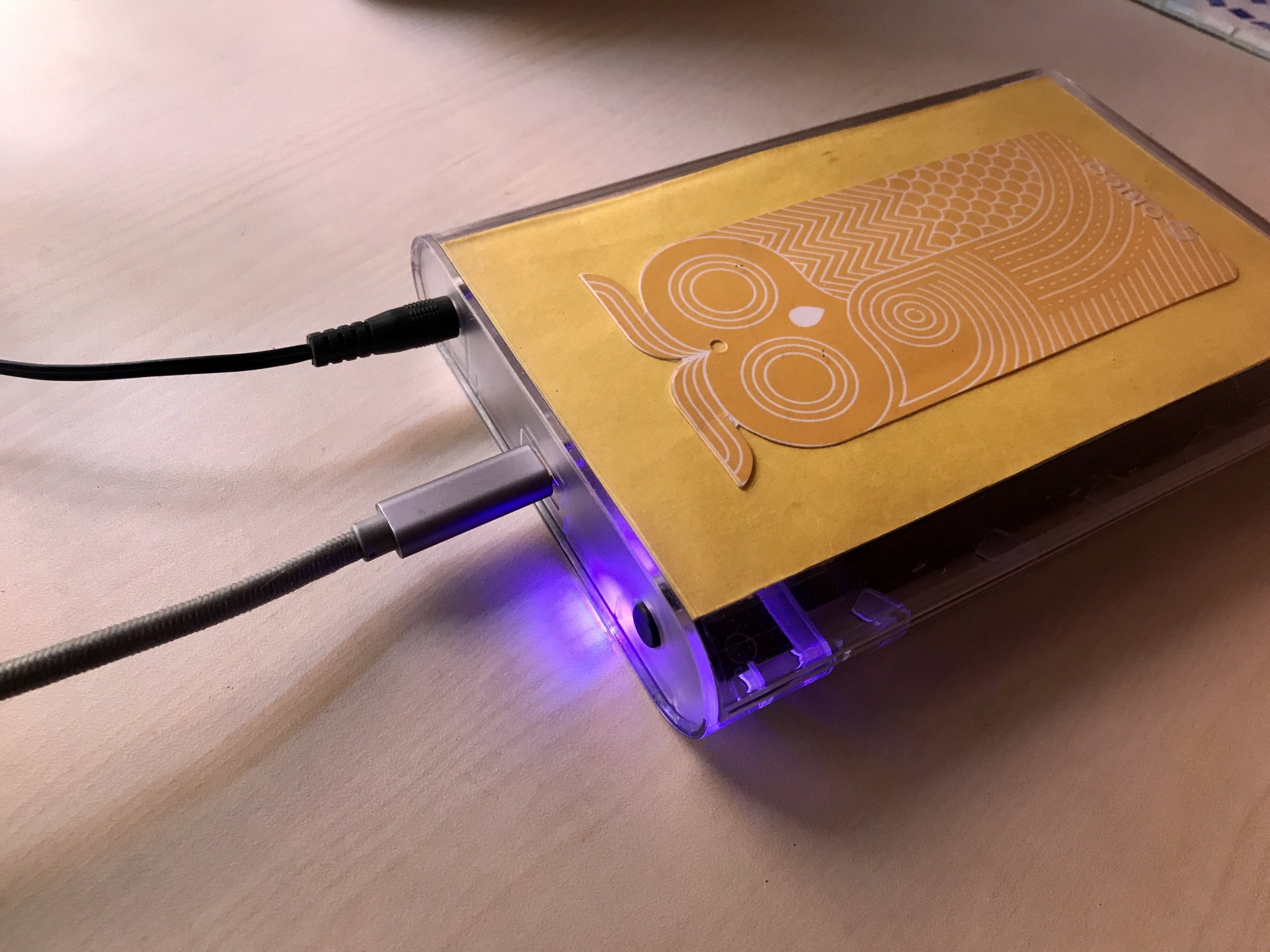

It's very simple to build cheaper, more flexible DIY alternatives to the Samsung T5 so I've never bothered with that. SATA-USB adapters are very mature and I already have plenty of spare 256GB-2TB SATA III SSDs (830, 860 EVO and MX500).

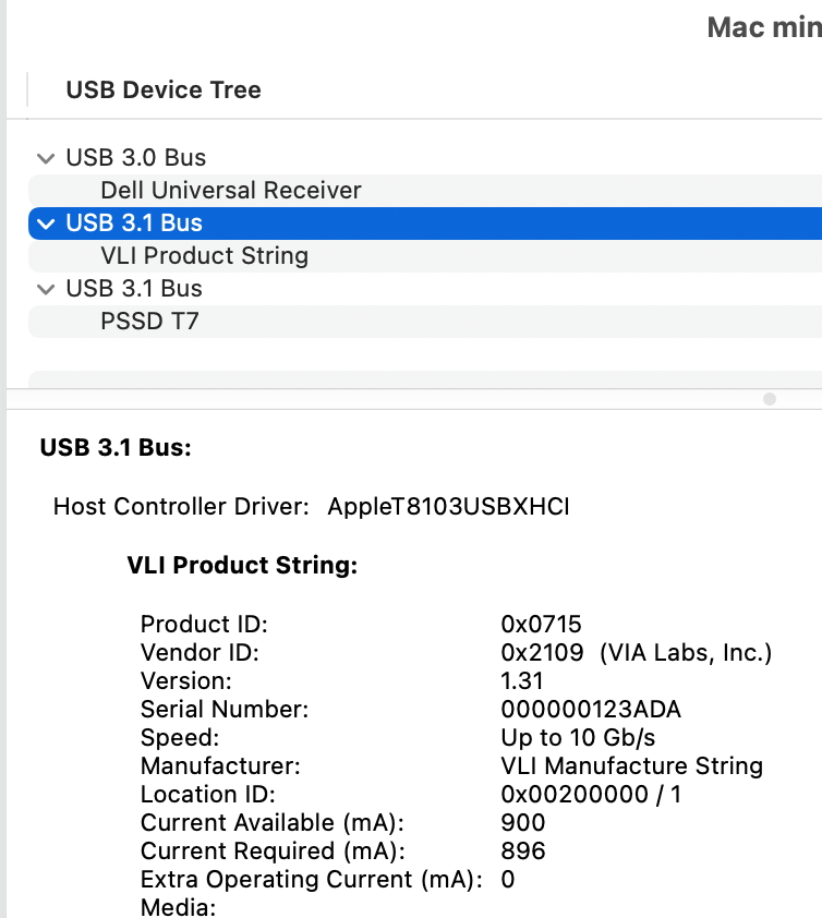

My Observations:​
I changed back the default finder window and default download location.
I was doing fairly easy things like, downloading a 4GB video from the internet, extracting a folder of 100 images etc in the SSD directly. And the drive was remaining quite hot, at all times, at the same level of temperature (to the touch).
Also I now think using the internal ssd would be better experience for most tasks in general. So I reverted back to the general download location and finder settings save for the "eject" button.

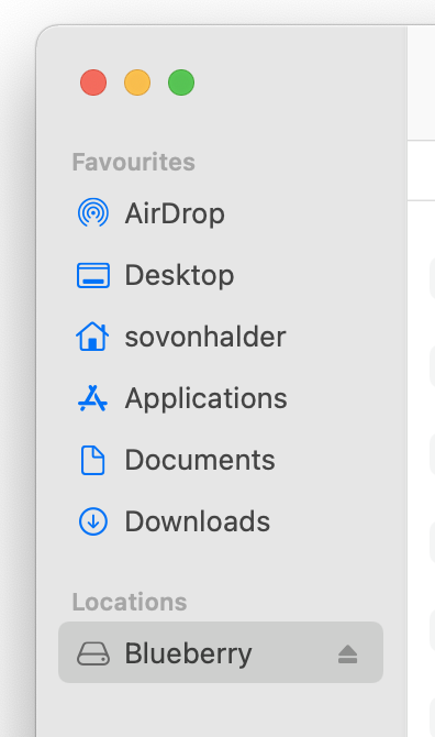

It is now on my finder window and desk like this. Non ejectable, stuck with with double sided tape. Ready whenever I need.
Even now, just for comparison, I haven't done anything in the T7 SSD for the past half an hour, just sitting there and still it's warm to the touch, and the mac mini where I just copied 158Gb data (from my old 3TB hard drive at one go at a constant 150mBps speed) is actually cold to the touch as if the computer isn't even turned on.
(Both the cable & the enclosure support up to 10gbps. Not sure if it's relevant but posting in case anyone wants to know what device and enclosure the data is being copied from & what the connection bandwidth is.)

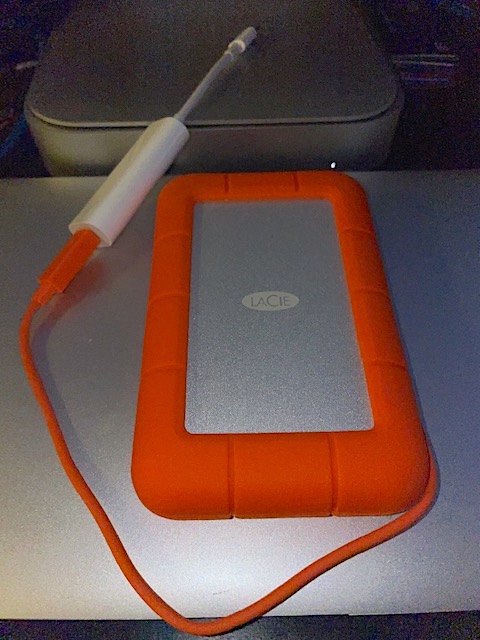

I use the LaCie 1TB SSD Thunderbolt 1 / 2 drives as I have many to shuttle...
Lack of ports ?
Since I use a 27" Apple Thunderbolt display, I have an extra TB port that I leave connected in the back of the display. Using the Apple TB3-TB2 adapter, it's bus powered and stores all my backups, files, etc...
These SSD were bought cheap and brand new on eBay for $50USD each so I bought 10 of them. Plus they transfer at 10Gbps...
If ever I needed more, these LaCie TB drives can be upgraded with a larger, standard SATA3 SSD or HDD or Hybrid.
