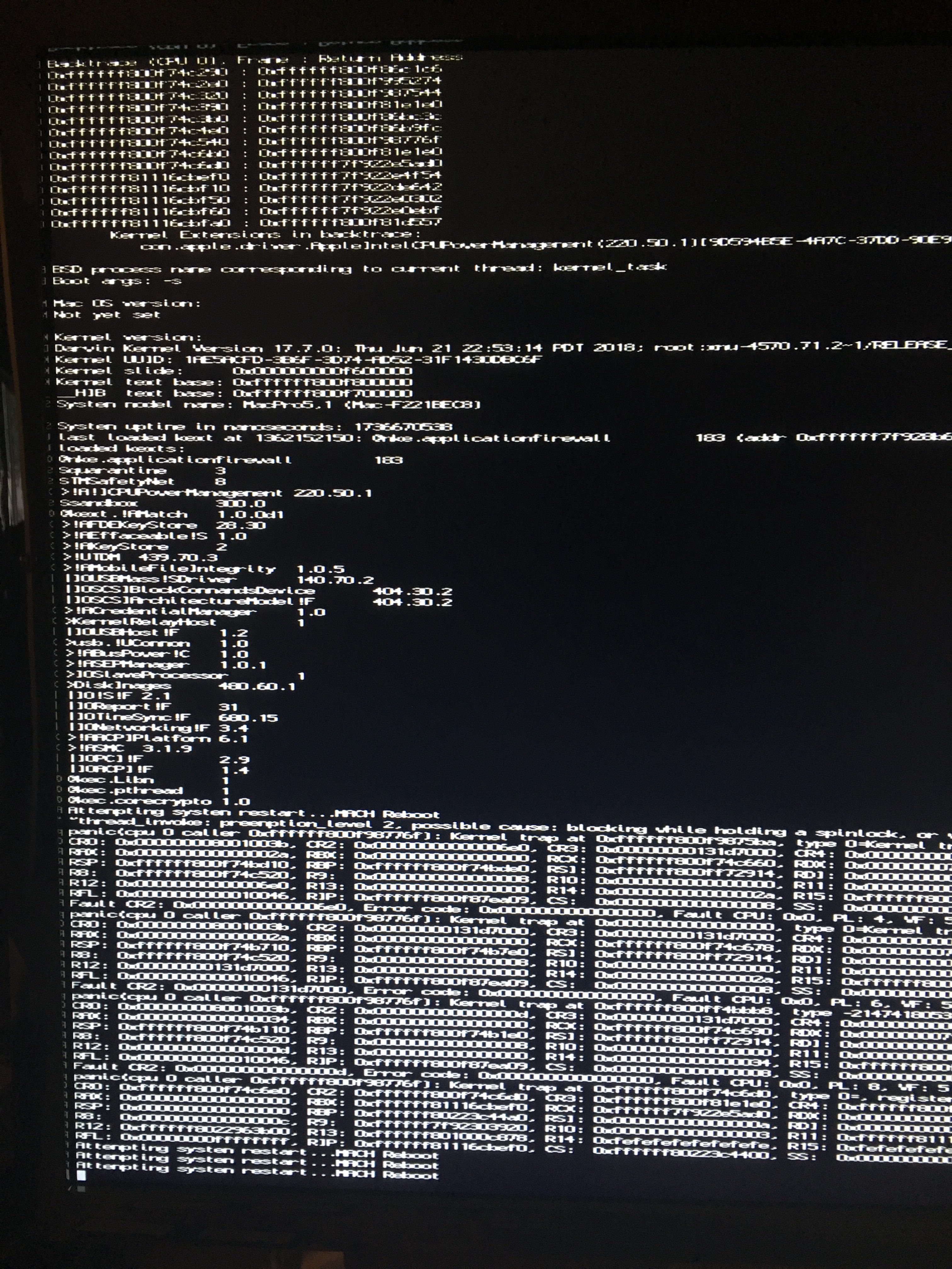

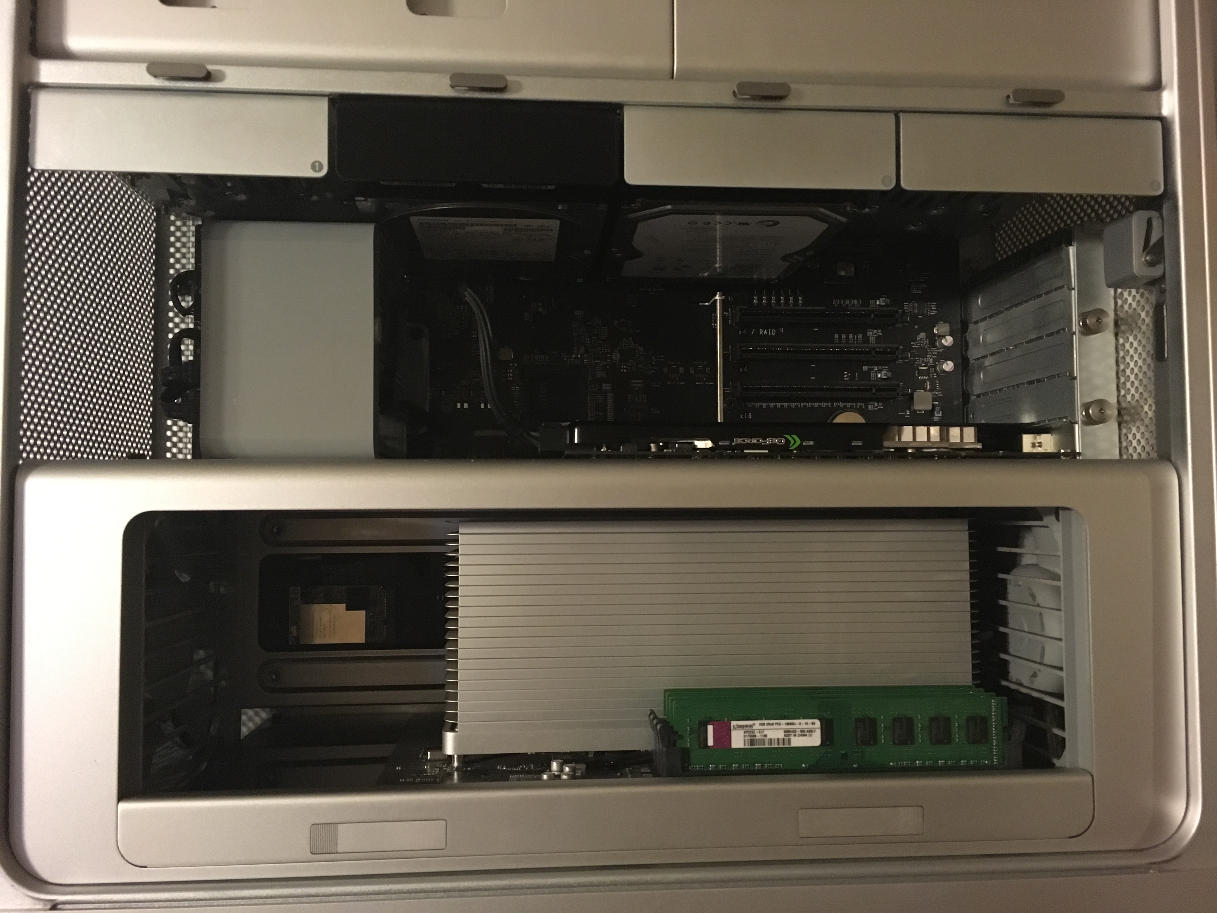

Hello all. In my 2009 4,1 (flashed to 5,1) I swapped out my Xeon W3520 for an i7-940 for funzies. I also swapped out my ADATA PC3-10600 ECC for Kingston PC3-10600 non-ECC memory. Windows 7 boots up just fine, but any version of OS X kernel panics. The Kingston ram seemed to work fine with the Xeon, but with the i7 it's no joy. The kernel panic is hard to read, but I'm assuming that it's the i7. Any good way to test it? I'm attaching a photo of the panic for what it's worth. I'd like to know what's wrong with it so I can return it to the eBay seller.
I already did a pram/smc reset, removed all the other drives, etc.
ActionableMango
macrumors G3
Sep 21, 2010
9,612
6,907
It looks like MacOS's power management driver is not compatible with your CPU. Other people have used i7 CPUs within the same family and reported success, so that CPU should work.
How is the CPU labelled? It might be an Engineering Sample instead of a real production model, with different power management code. And perhaps Windows power management doesn't care but MacOS power management does.
By the way you don't have to change the RAM. The i7 is compatible with ECC RAM even though it can't make use of ECC.
As a workaround, it appears that many Hackintoshes have this problem with any number of CPUs not fully supported by MacOS, and they install a kext called "NullCPUPowerManagement" that gets around it. Perhaps the same trick would work for you.

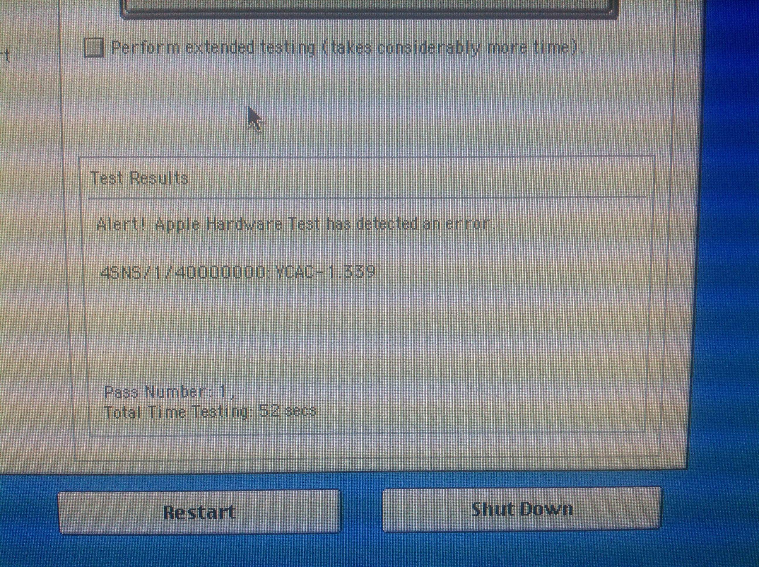

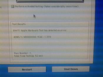

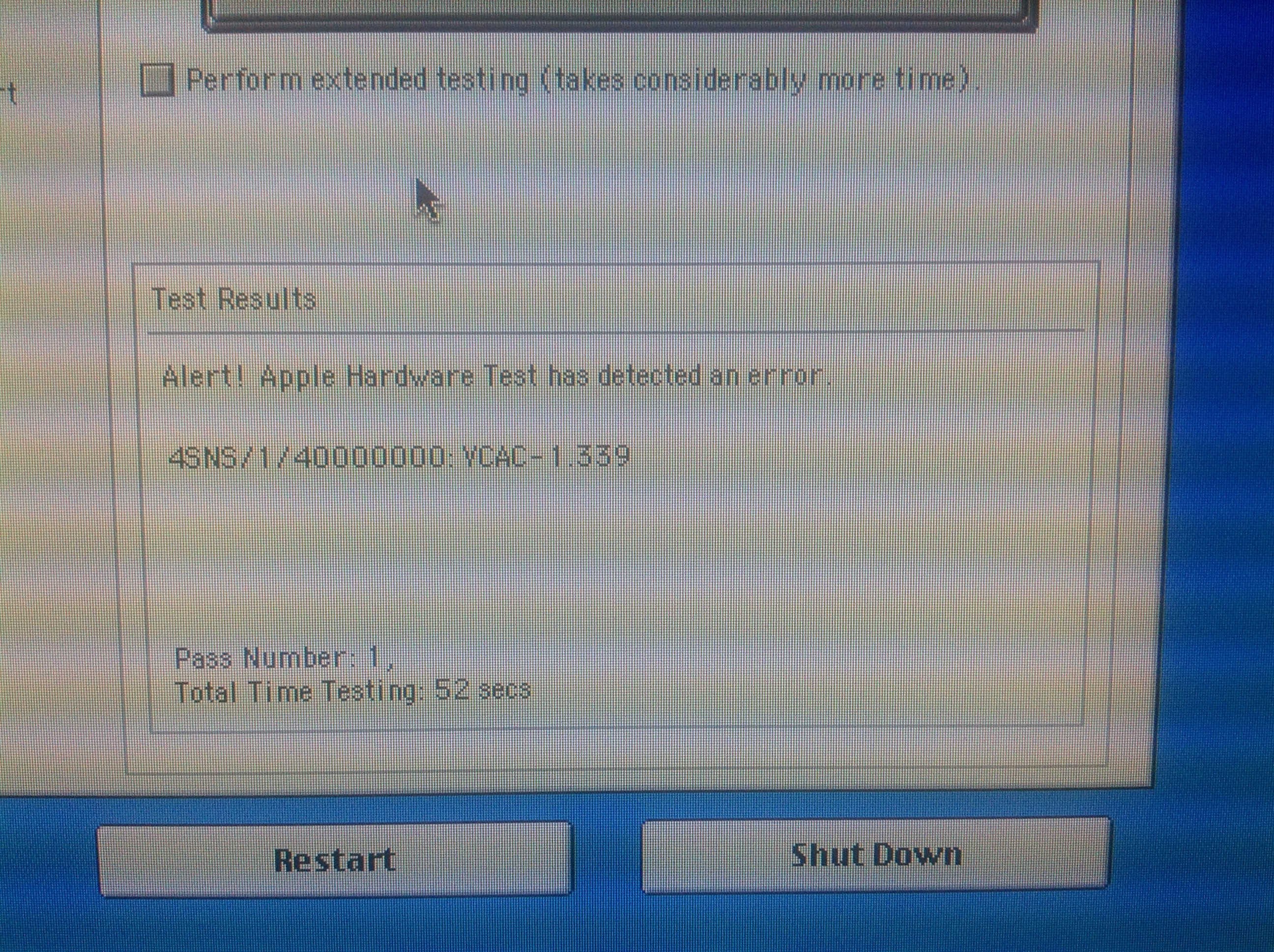

It didn’t have the “intel confidential” or “ES” on it. Can you point me to a n00b how-to on installing kexts?
AHT is reporting an error, but I can’t read it in my 4K monitor.
Man, it's been a long long time since I've done that, but I vaguely remember there was a tedious manual process of moving files around or modifying files and then either repairing permissions or manually setting specific permissions. The preferred method was Kext Drop or Kext Utility or something else where you'd just drop the Kext onto the app's window and it would do everything necessary for you. I think I used Cindori's KEXT Drop. I don't know if it still works in the era of SIP and whatever else, but I'd look for a KEXT installer to do it E-Z style.
One possibility is that it might just be an incompatible CPU. I know you're probably thinking "but it's on the CPU Compatible List that YOU WROTE, Mr. Actionable Mango".
Yeah, well... when I initially created the CPU Compatibility Matrix, I only included CPUs that were actually verified by someone.
Unfortunately over time people kept saying things like "well if that CPU works, then this should work too because it's just a different speed" or whatever reason. I usually gave in because I didn't want to discourage the input.
In particular a whole bunch of the i7's got onto the list that way. It seemed to work out okay because a couple of the "theoretically" compatible CPUs were later tried and did work. So that was good, and those CPUs might not have been tried at all if they weren't on the list.
But now I regret giving in because what's happening to you might be exactly the sort of thing I was worried about and I sometimes I think I should have said "no" at the time. And now I have no idea which CPUs are truly verified and which are theoretically compatible.

I threw in my spare 5,1 tray to try to install kexts: I tried manually, and with Kext Utility, but no luck.
Oh, well. The i7-940 I picked up on eBay for $14.99 on a lark, so I guess I'm not out too much...

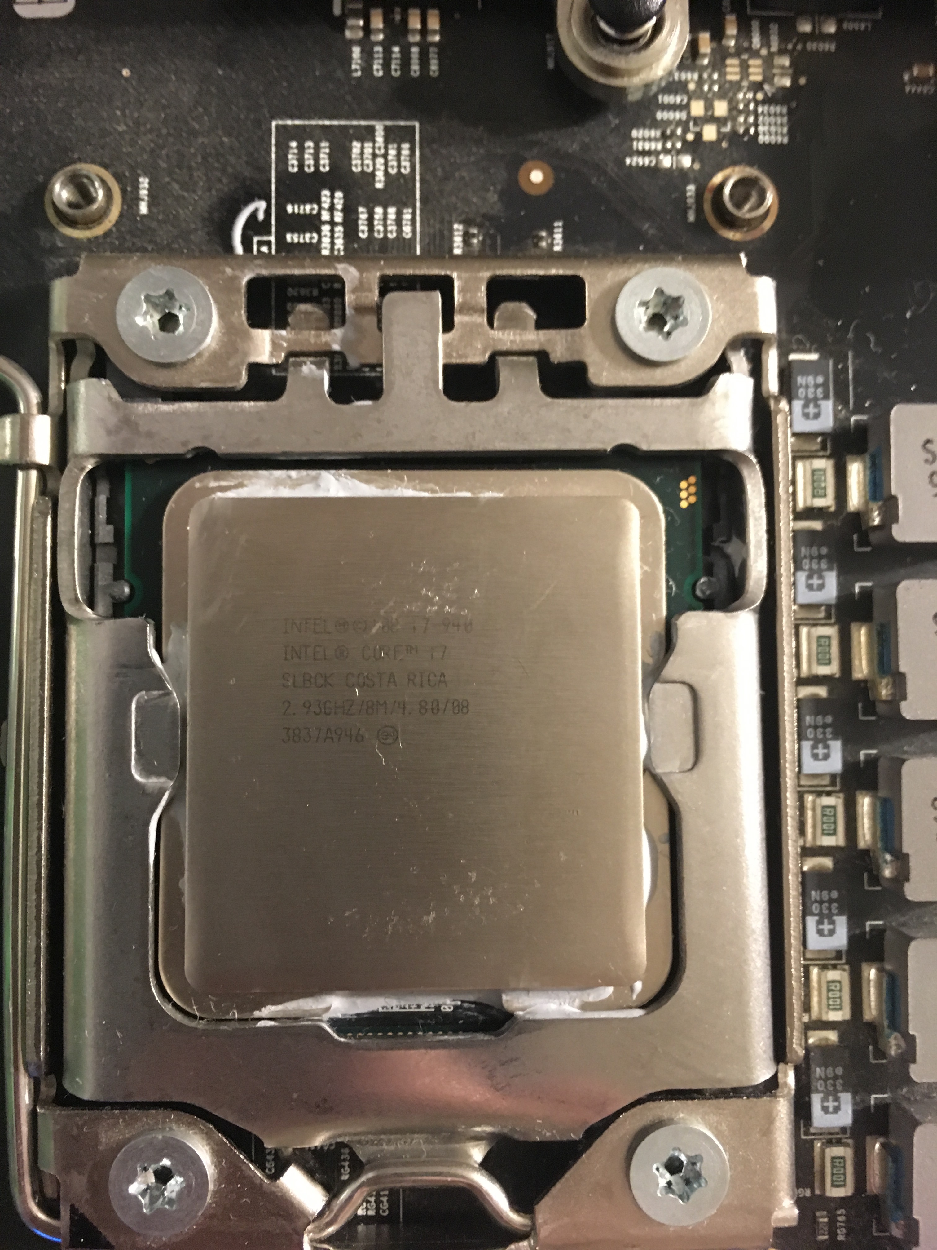

You may want to remove the i7-940 or put in a disclaimer. No workie on a flashed 4,1. I even threw the 4,1 tray into my 5,1. Although the kernel panic screen was different, the CPUPowerblahblah was the panic. I wanted to pick up one of the 6-core i7 to play with on my 5,1, but I think that I'll hold off buying one until I can get confirmation.
INTEL (m)(c) '08 i7-940
INTEL (r) CORE(tm) i7
SLBCK COSTA RICA
2.93GHZ/8M/4.80/08
3837A946

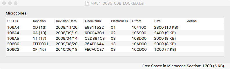

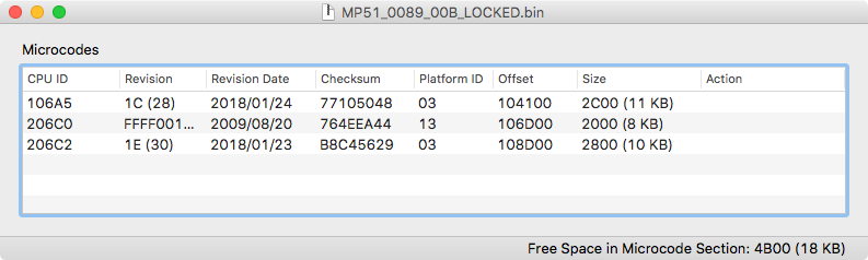

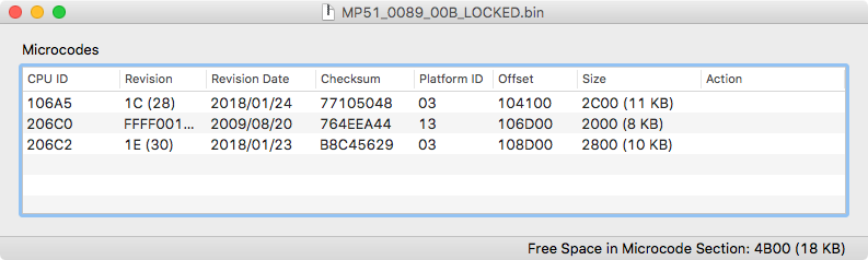

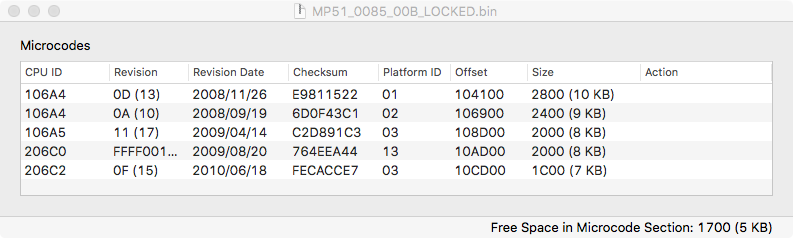

It was suggested that the 0089 firmware may have removed the support for the i7. I'm trying to downgrade back to 4,1 firmware, but despite having the 1.8 apple image open, I still get the 5770 error trying to install the 4,1 firmware.
tsialex
Contributor
Jun 13, 2016
13,117
13,315
Don't do that. If you knew how hard, costly and time consuming is to recover from a bad firmware flash, you'd never try this.
Temporarily swapping CPU Trays between cMP's, the 990x is still supported in firmware 0089.
Perhaps it's a bad CPU?
I would return it to the vendor.

You still think trying to go back to previous firmware is not advisable?
To go back to 4,1? You’re risking your logic board big time. But to 0085, renaming it to 0090 and putting it on the Firmware folder - could be done without much risk.
Zeke D
macrumors 65816
Nov 18, 2011
1,024
168
Arizona
so get the 0085 firmware, rename it 0090. how do I make it create a firmware folder? just use the 4,1 to 5,1 and copy the files to the ram drive?
tsialex
Contributor
Jun 13, 2016
13,117
13,315
No.
1) Get MP51.0085.LOCKED.fd, rename it to MP51.0090.LOCKED.fd. You can get it from 10.13.4 or early Mojave betas. 10.13.4 combo installer have it too, but it’s a lot of steps to get it from the combo.
2) Download 10.13.6 full installer from the Mac App Store.
3) Click on the installer, ask to show all files, go to the Contents/Resources/Firmware folder, remove MP51.0089.LOCKED.fd, put the renamed 0085 as 0090 file here.
4) Run the 10.13.6 installer, now it will ask for update the firmware.
I’m typing this on iPhone and it’s really horrible to type long posts on MacRumors, but I think you will get what needs to be done.
