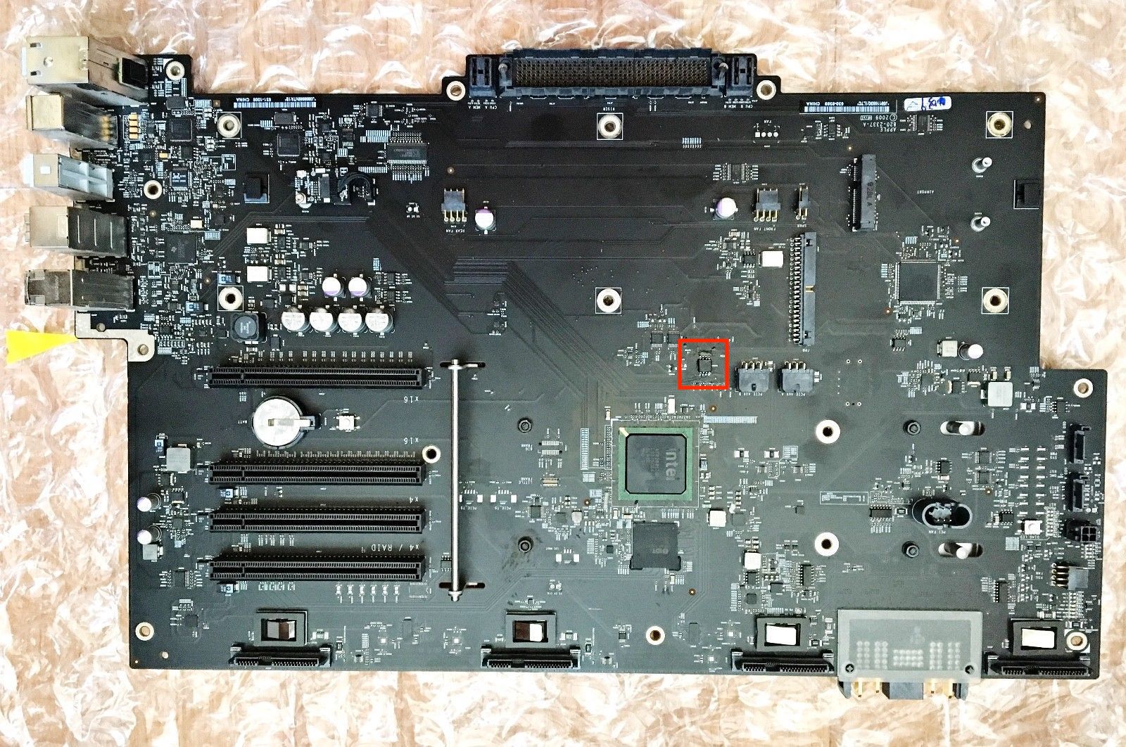

Another thought. Is the firmware chip on the logic board, or on the tray?
Board.

The problem is that the LOCKED.fd file it's a unpersonalised one. You can boot with a SPI flash restored to it, but you will loose iCloud/Facetime/iMessage.
To personalize it again, you will need the SystemSerialNumer (label next to the video card port, behind the Mac), LogicBoardSerial number (it's on a label next to the CPU tray conector) and the SalesOrderNumber ( sometimes you can use the SKU for a retail bought Mac, but on a Refurb or on a BTO/CTO, only Apple has it). Next you will need to carefully edit the LOCKED.fd file with the needed information, on the correct places that don't exist on the unpersonalised one.
It's a royal pain in the _ss to get the SON on a Mac that don't use the SKU as the SON. So, I recommend to everyone do a full BootROM dump and save more than one backup.
