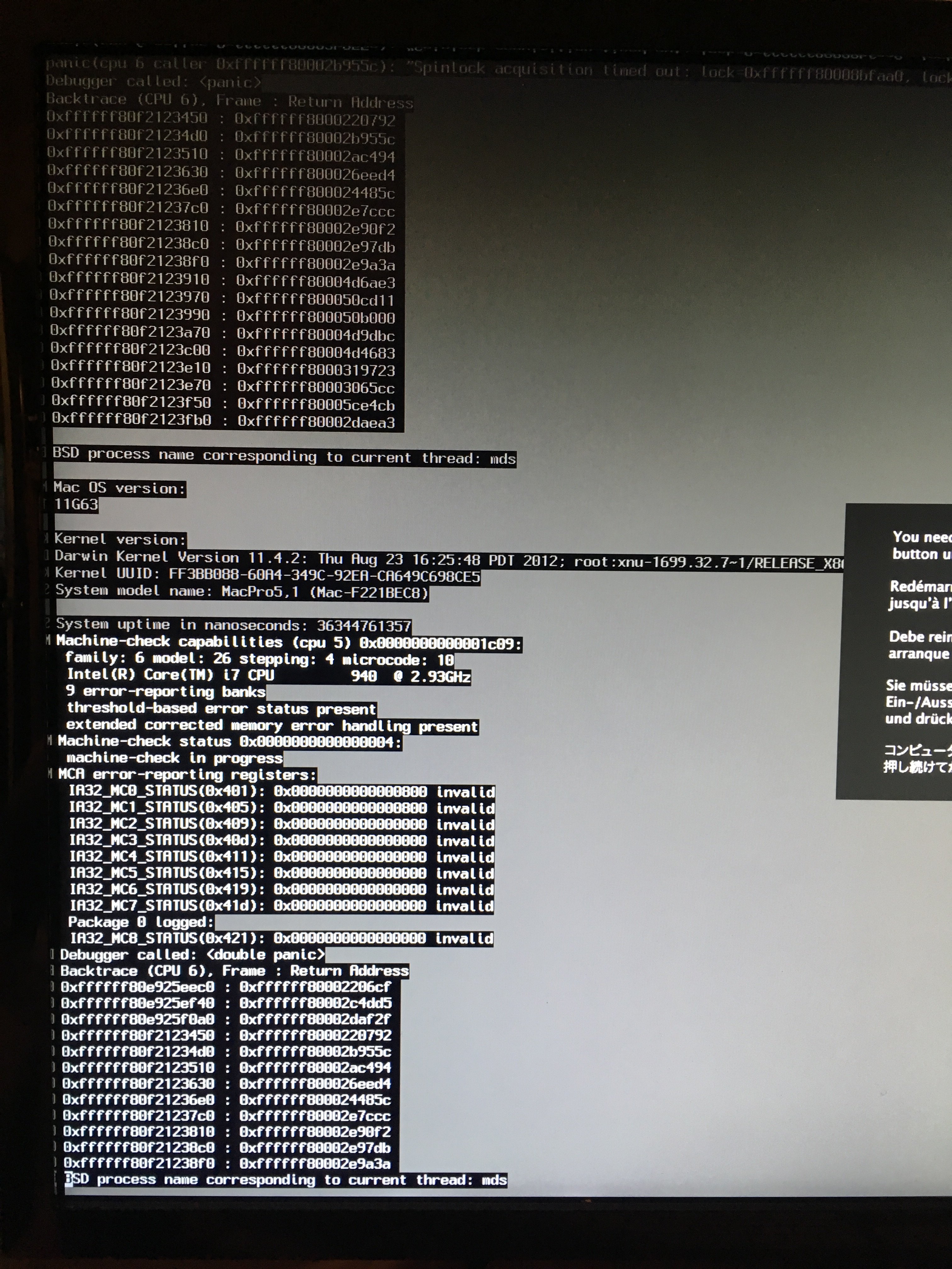

However, I've read through this thread and I'm not too sure what needs to be mentioned in the CPU compatibility list. Is it basically that Nehalem i7 CPUs are not compatible with firmware updates 089 and later? But the Gulftown i7 CPUs are still okay?
I’m sure that @tsialex will correct me if I’m wrong, but that is correct, but 0087 is the firmware that dropped Nehalem i7.

Exactly, only C0/C1 Bloomfield i7s are not compatible with 0087 forward. Btw, if you ever update your excellent compatibility table, please identify correctly the core types. It'll be important from now on.

Nehalem/Bloomfield Core i7 and Xeon CPUs work fine in the MP4,1/5,1
the only thing to watch out for is the C0/C1 Stepping Aka 106A4 CPUID Core i7 CPUs those where made incompatible with OS X in the MP5,1 by the 0089 BootROM.
the D0 aka 106A5 CPUID Nehalem/Bloomfield Core i7 CPUs will work perfectly fine even on the latest BootROMs AFAIK
It's more complicated that that. Some Nehalem generation Xeons are 106A4 too, but these will boot without microcode, i7s 106A4 can't boot without microcode.
It's more complicated that that. Some X34xx Xeons are 106A4 too, but these will boot without microcode, i7s 106A4 can't boot without microcode.

again tho, all "retail" LGA1366 Xeons are 106A5 only, the only 106A4 Xeons where Engineering sample prototypes.

Not just i7s are C0/C1, but some early Xeons, like L5520, are 106A4 too, but seems the C0/C1 Xeons can boot macOS without microcode and C0/C1 i7s can't.

the Xeon L5520s only production stepping is D0 106A5...
so again ??? 😕 nothings complicated here its just 0089 dropped 106A4 microcode. so just early i7 Guys have to watch out thats about it. (unless you happen to be running a Engineering sample class Nehalem Xeon...)
im pretty positive that if you did get a C0/C1 106A4 Xeon and stick it in a 0087+ BootROM MP4,1/5,1 that it would kernel panic the same as the OPs Core i7 940 did.

the Core i7 940 and Core i7 extreme edition 965 only shipped as C0/C1 106A4. so those are pretty much screwed.
the Core i7 920 was 106A4 C0/C1 but later had a D0 106A5 release.
the rest of the Nehalem i7 LGA1366 CPUs where all 106A5 D0 and are safe.
