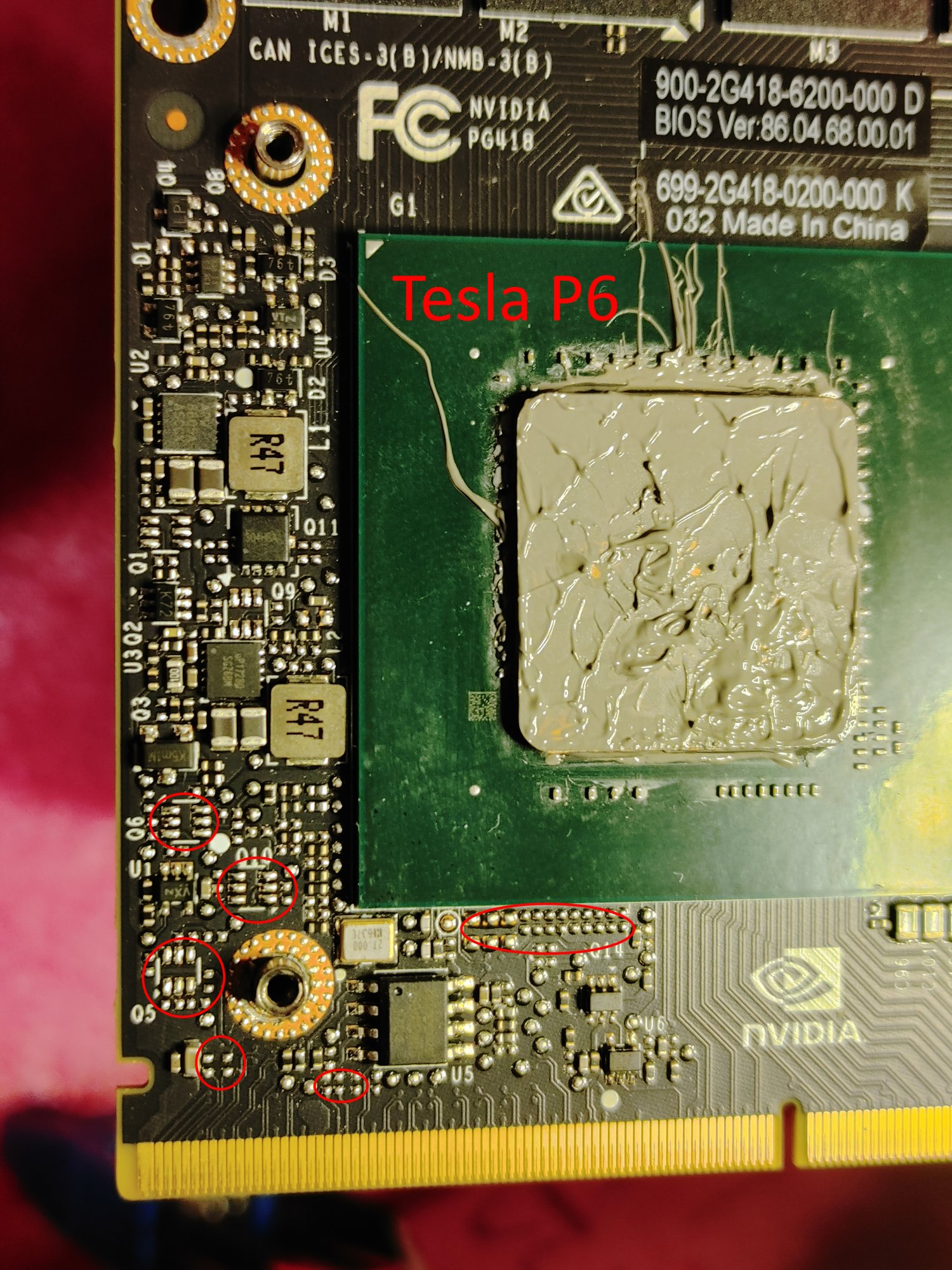

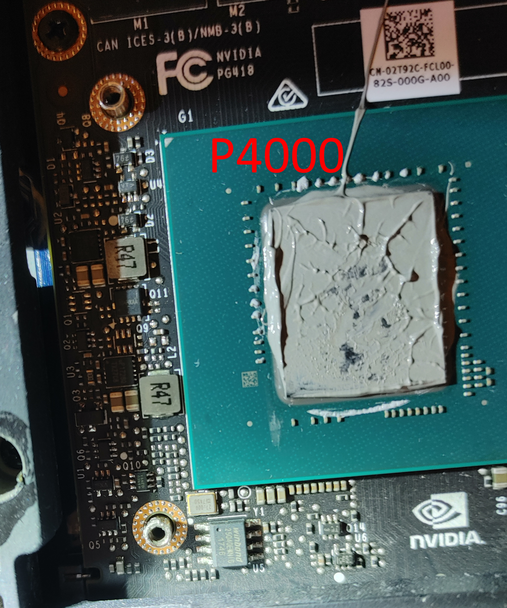

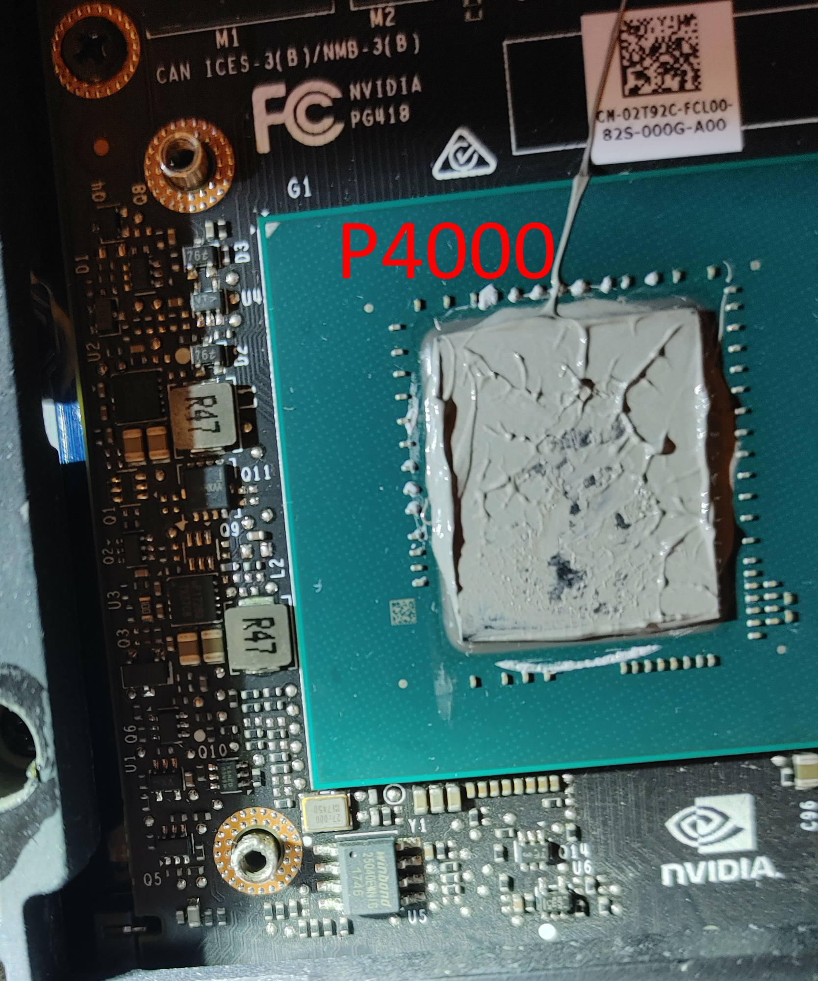

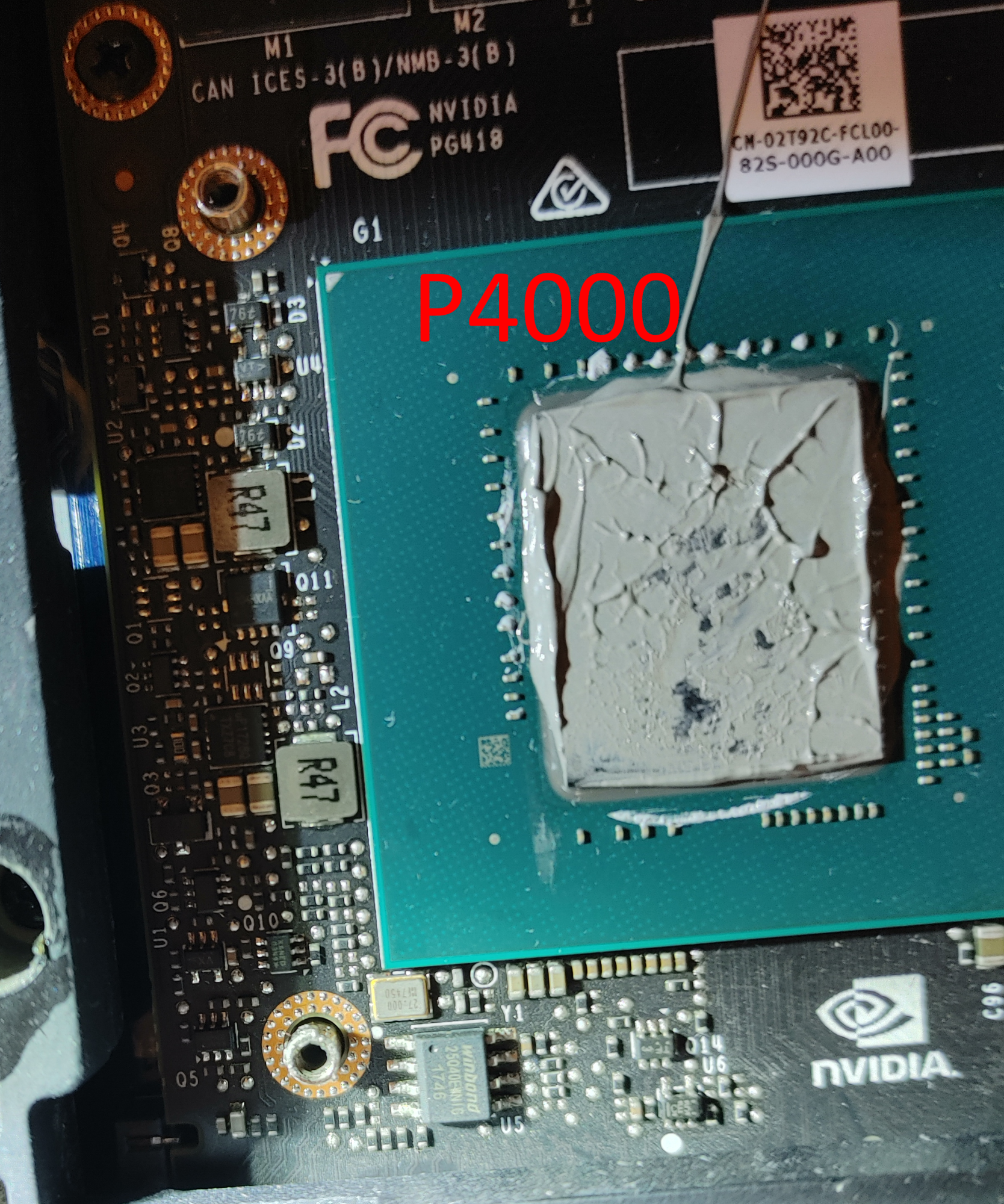

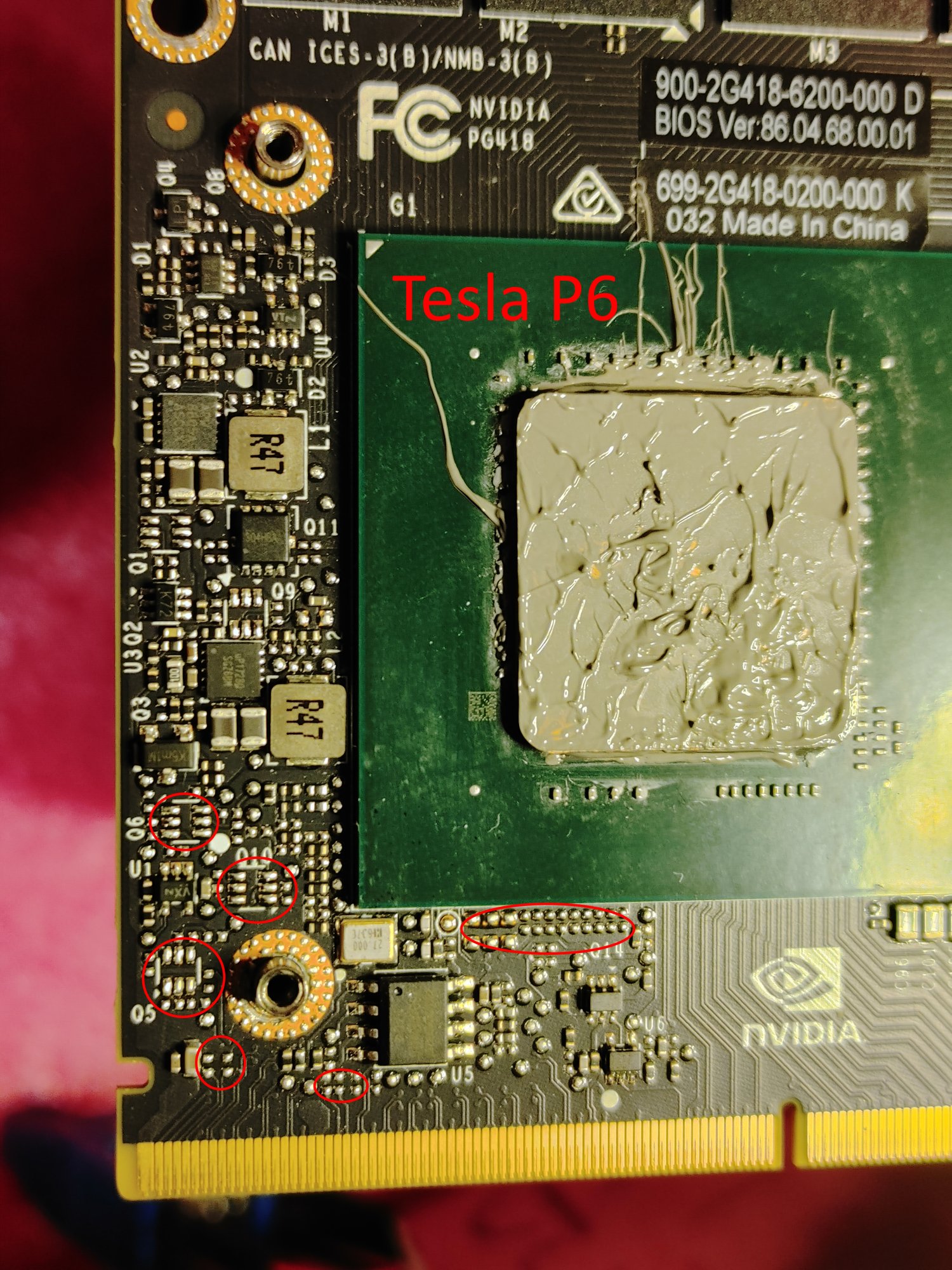

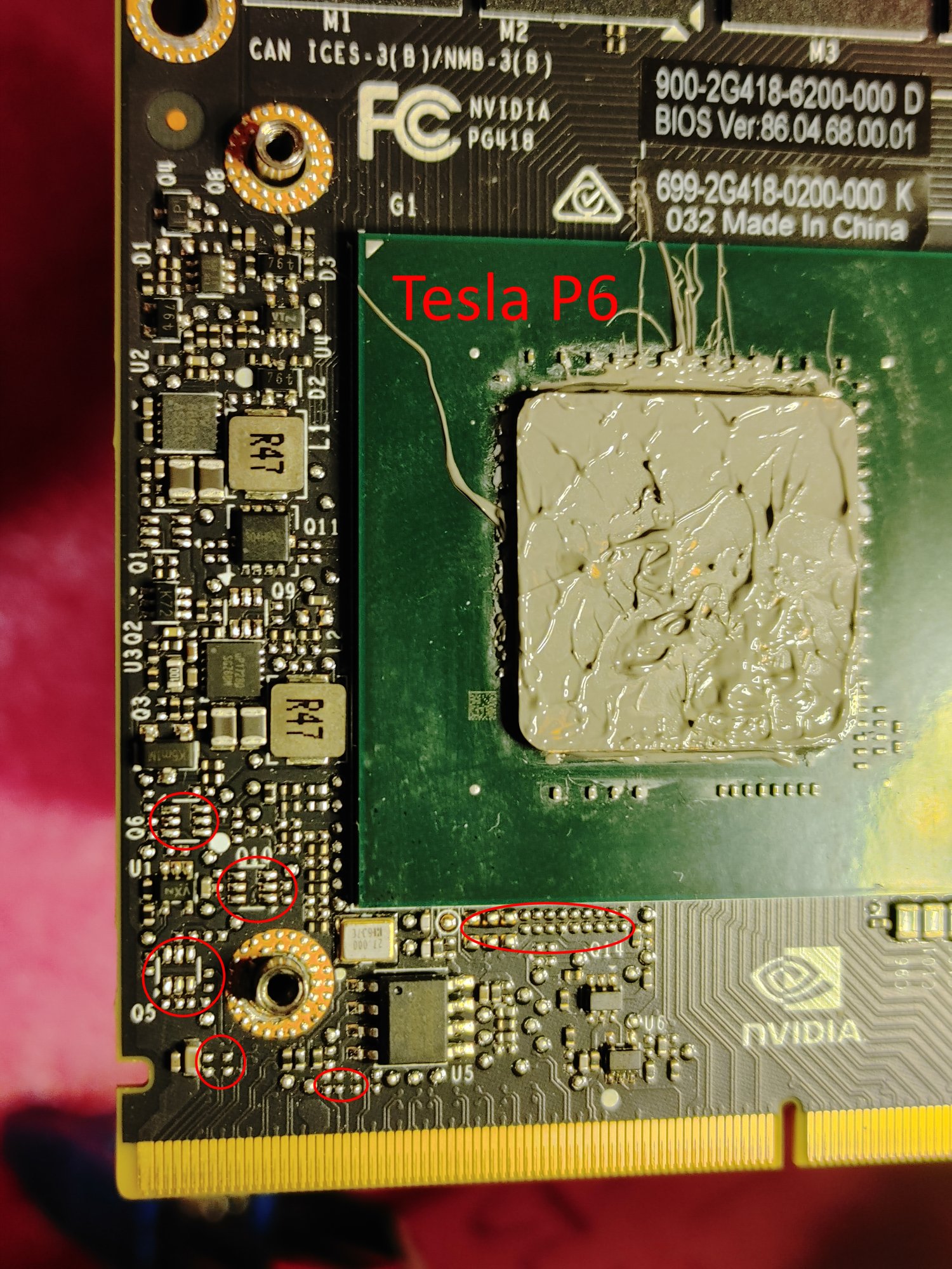

I did notice the P6 has some missing components compared to a P4000 (no P5000 for reference unfortunately). If i wasn't currently using the P4000 i'd be tempted to swap them over. I have my doubts it would resolve the errors.
Apologies for the goopy photos 😅 the Tesla photo was also taken under a yellow light and has a copper shim that makes the die size look funny.
Still no dice 🙁 even went through the whole routine of bios reset + DDU.
Hmm some new protections 🤔 if you have time you can try one more thing to be 100% sure. Take your 100% working vbios and edit it in Mobile Pascal TDP Tweaker. Enable powerslider setting to adjustable, save this change and then try to flash this modded vbios and check if this works.
In theory this change should also show error code and that would mean that this vbios has some new protections and its not going to be easy to bypass it like on for example P4000.
Took a look at clocks and power tables inside the P6 vbios, clocks seem to be limited to 1506 MHz and TDP to 90W. Also, the clocks tables are different from other Pascal cards (they have fewer power states, and most of them seem "empty"). Unfortunately this makes impossible to just copy/paste such tables from a P4000/P5000 card, I'd have to manually try to adjust existing table entries to some matching ones from other Pascal cards, and this would take a lot of work and testing...
Also, cross-flashing other cards vbios won't work since the device id is hardware encoded using strap resistors on the card, and checked by vbios/driver.

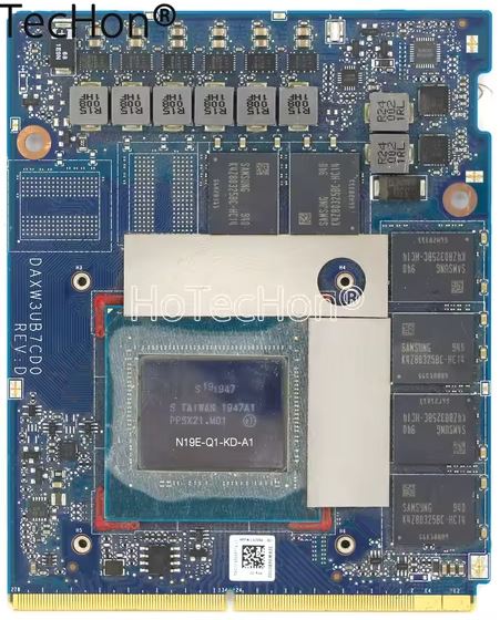

Hi, I need some help. I inserted the RTX 3000 from the HP Zbook 17 G6 laptop, but the iMac 2011 did not start. The CPU and GPU fans restart for 5-10 seconds. One LED is on. I think the iMac doesn't see the GPU. I don't know what the reason might be.
Simple: GPU is not supported by the iMac.
That card looks different to normal, one screw hole is in a different place.
I think the metal heat-sink frame might be touching some part of the card?
I would check that and put some tape over any part that touches the PCB.
Also I think for that card you will need to wire the back-light mod to turn on,
or the screen will just be black even if the card is detected and working ok.

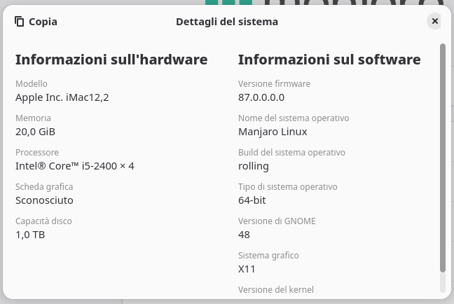

Good afternoon guys.
Sorry but I need to ask for your help, this goes beyond my knowledge.
I have an iMac12,2 in which I replaced HDD with SSD, added ram, changed GPU with an Nvidia K3100M, replaced MacOS with Linux and added rEFInd for bootloading.
*-display
description: VGA compatible controller
product: GK104GLM [Quadro K3100M]
vendor: NVIDIA Corporation
And actually is working pretty well, I use it daily since march.
I wanted to update the GPU to Nvidia 1080 Mobile ( https://www.techpowerup.com/gpu-specs/geforce-gtx-1080-mobile.c2870 ) and so i bought it.
Replacing the K3100M with 1080 Mobile led to black internal screen.
The OS is working and connecting the Display Port to my TV it shows the working OS.
I was able to play games and run LLMs using CUDA with the last nvidia driver version available.
Still, the internal monitor is not working.
Of the 4 internal led indicators, the third (referred to communication between monitor and GPU) is not working.
I didn't flash any vBIOS up to now.
And i don't find any.
The GPU is Pascal series.
I'm quite skilled, let me know how to proceed i hope i can follow your instructions.
Many thanks in advance
PS: the rEFInd boot does not appear when attached to Display Port, it shows up just after the OS starts booting.
