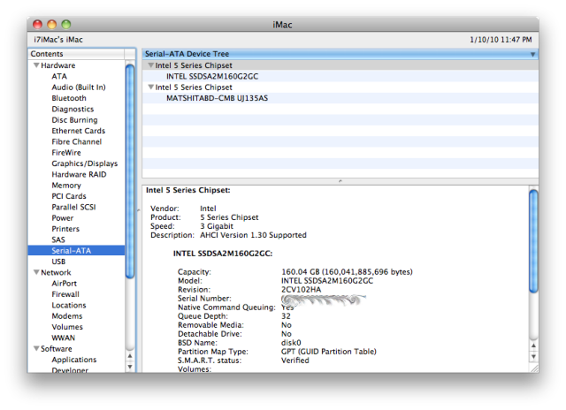

The firmware version is printed on the label.
If you already installed it, you can check the S.M.A.R.T. info. Mine reports 2CV102G9, though on the label it just says 02G9.
So I've just got my X25-M and it says FW: 02HA.
I'm guessing this might have TRIM enabled.
Does anyone know?
Does anyone know?
Mine is 02G9, and AKAIK 02HA was the next firmware released, which includes TRIM. No idea if you can downgrade, but if not, I guess you'll have to boot into Windows every so often and run some optimisation tools.

Few issues with Intel G2 160gb in Optical Bay
I did the intel ssd upgrade and I can say it is very very fast. This thread has helped a lot. I am having a few issues though. Maybe some of you have had the same problem and can help me out.
