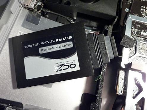

more pics of how you unistalled the normal hdd and especially how you put together the temperature sensor will be more than welcome!

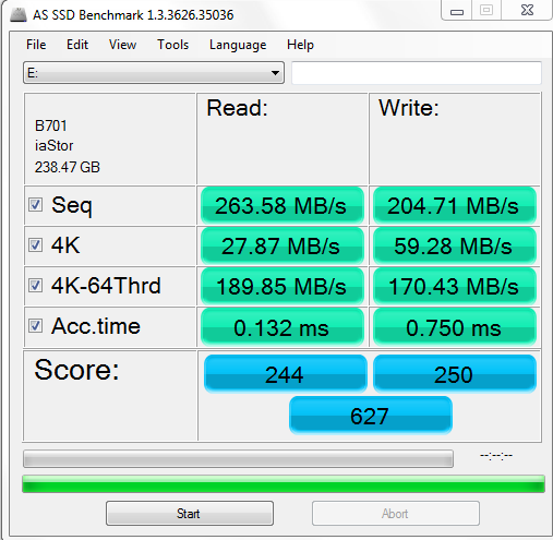

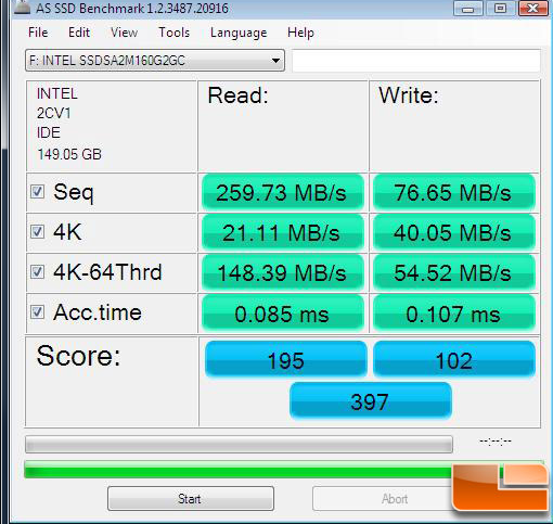

Guys, I'm sorry if I'm hyping this up, but this is a very promising SSD, Intel has been dethroned in the random 4kb write.
Basically Intel lacks sequential write speed, which is roughly around 70mb and 100mb/sec in 160gb variant, as compared to the competitors' 200 mb/sec ++. But low and behold an SSD which has sequential read 260MB and 204 mb/sec sequential write, and around 60MB/sec 4k random write speed :)
sources here:
http://www.micronblogs.com/2009/12/as-benchmarks-for-realssd-c300/
the benchmark (AS SSD Benchmark) is being used by legit reviews, for comparison with Intel X25-M G2:
Intel X25-M G2
sources from legitreviews.com
Micron RealSSD C300
sources from micronblogs.com
http://www.legitreviews.com/article/1022/11/
http://forums.legitreviews.com/about21729.html
here's hoping the independent reviewers like pcper and anand could get the hands of this new gem.
I noticed that the one used in LegitReviews is an older version, now I welcome anyone who has the Intel G2 drive can download the benchmark and post the results.
I think you meant JMicron company who made that controller. I'm taking to the makers of the NAND Chips (the actual memory that Intel is using (80GB, 160GB) not the controller. It was made by the company Micron. They didn't made that ******* controller.
ah.. :eek:... ok, explicatives aside, let's all be more objective than just dumping information from a company PR website.
Now, show and tell hour, how do you plan to install their card in an imac? :rolleyes:
well the same as you install an Intel-x25m g2 SSD :)
I'm just saying we finally have a SSD contender to Intel's random reads/write and is king when comes to sequential reads and writes too.

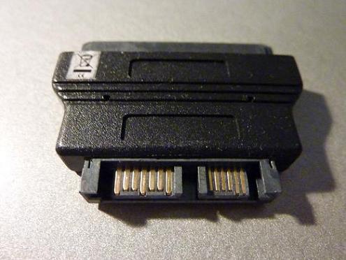

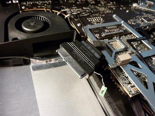

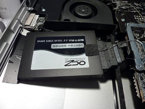

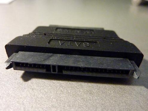

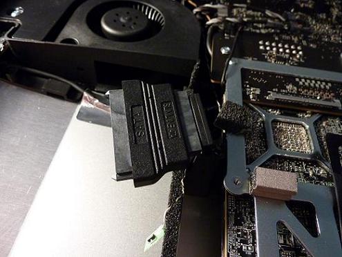

a very cheap method is following:
Additional to this post, please have a look on my last post with many other pictures:
https://forums.macrumors.com/posts/8927668/
yesterday i opened my i5 again and tested following adapter (SLIM-SATA --> SATA), appr. 10 Euro / 14 USD
If you didn´t move or pull your imac, you can fix the ssd with tape, but it´s not recommended.
With new and cheap adapter everything works perfect.
Silent and fast system
