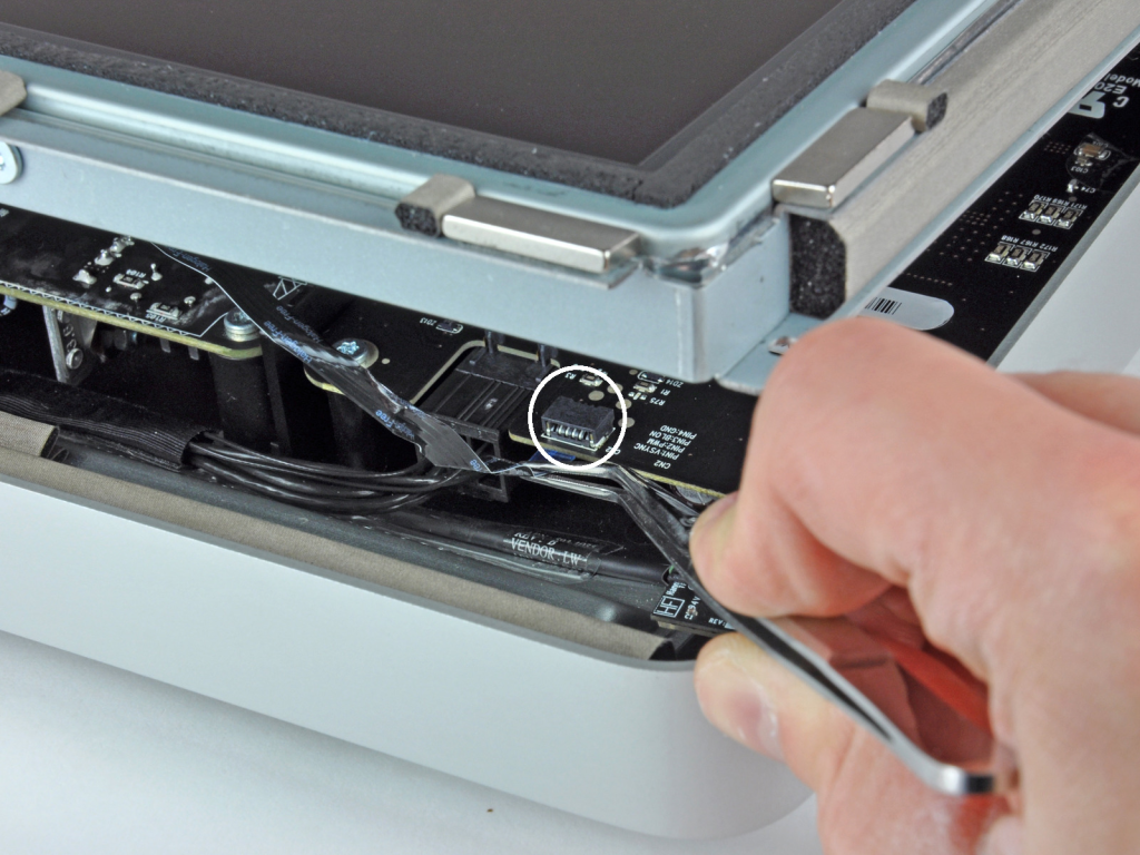

Ok. So I'm thinking of buying the ICY DOCK MB882SP SSD 2.5" to 3.5" SATA Drive Converter. I think it will fit better and that way the SSD will be completely safe inside. I know the Intel comes with an adapter too but I find the Icy one better.
No problems with the tools. They are easy to get. My only concern right now is still the step of pulling out the vertical sync cable and placing it back. Someone said previously on this thread that the little black "box" (see the picture below) where the vertical sync cable is connected has to be opened to let the cable inside again. Is that correct? Im afraid that I might break it if I try to open it. Others have said that this is not necessary. That you just have to push the cable inside the black box. What do I have to do then? I don't want to be confused on that step. Is it possible to take out the cable and put it inside again with just the fingers?

I haven't done this but just from looking at that connector it looks like you just push in the cable end to re-connect, doesn't look like there's anything to "open". Good luck.
Don't waste your money on the Icy Dock - there's nothing 'better' about it.
I didn't open the box to push the cable in, not sure if you can or should.
I doubt you'll be able to fit your fingers in there and hold it tight enough to push it in - there's very little space. Use a tool like the one pictured - I used needle-nosed pliers.

I installed a retail version of the Intel X25-M G2 80GB and the 3.5" adapter that came with it worked perfectly since it came with the propers screws and such. It actually had more than enough screws.
What you have to do is remove the original HDD from the iMac and remove two little "plugs" from the other side of the HDD (these can be removed with torx 8 screw driver) and two screws that are attached to a metal "angle iron" (these too have torx 8), these screw are on the opposite side in comparison to the plugs. Then attach both of the things you removed from the HDD and attach them into the adapter that came in the Intel SSD retail box.
Then just put everything back in reverse order and attach the thermal sensor wire with a little bit of tape to the SSD so it doesn't move around inside. Now properly placed the 3.5" adapter should be facing upwards so that you don't see the SSD. This way the SATA cables and such can be connected with ease and are the right way around. :)
