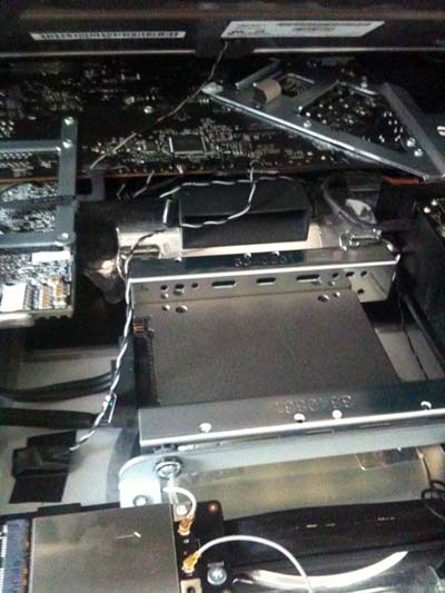

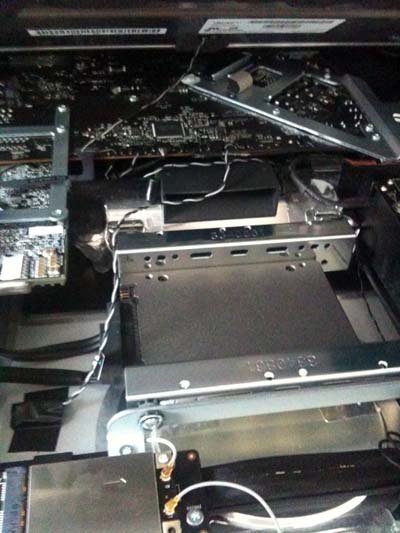

I have installed a Kingston V+ 256Gb "upgrade kit". The pakcage came with a 3.5" converter and screws, which is a perfect fit for the iMac (i7 w/ 8Gb RAM).
I didn't have a small wire for shorting the thermal sensor cable, so I just removed the two wires from the black plastic connector, connected them, and used some insulating tape to make sure they don't cause any harm. :)
After assembling everything, the LCD had no screen (blood pressure up, scary thoughts etc.). Then I carefully disassembled and reassembled everything, and voila it worked. Probably that tricky LED sync cable got loose.
A boot video: http://www.youtube.com/watch?v=ezzpWLRPiIs
Here is a pic of my setup (the drive is upside-down).
