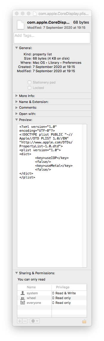

@ThugFreak Check you have a com.apple.CoreDisplay.plist file in Library/Preferences and preview it with get info. It should look like this:

Then, your Metal is still enabled. Those 2 commands create that file; reapply the commands and check the file com.apple.CoreDisplay.plist is created.
sudo defaults write /Library/Preferences/com.apple.CoreDisplay useMetal -boolean no
sudo defaults write /Library/Preferences/com.apple.CoreDisplay useIOP -boolean no

Have the file been created? You may have to disable SIP in recovery partition with "csrutil disable" command in Terminal.
Yes it is. You have to restart in recovery partition and apply in Terminal there.
Later you can re-enable SIP with "csrutil enable". SIP may block the creation of that file.
Restart your mac and after the tone keep pressing the "option" key until a menu is displayed. Then choose Recovery instead of your boot partition.
Option key have to be kept depressed instead of repeatedly pressing on it.
You may not have a Recovery partition if MacOS is not properly installed. But you can create one if you do not have it.
Definitely, High Sierra is not properly installed. You can try create a Recovery Partition or better reinstall MacOS since you have nothing important on it. It should create a Recovery partition upon install.
