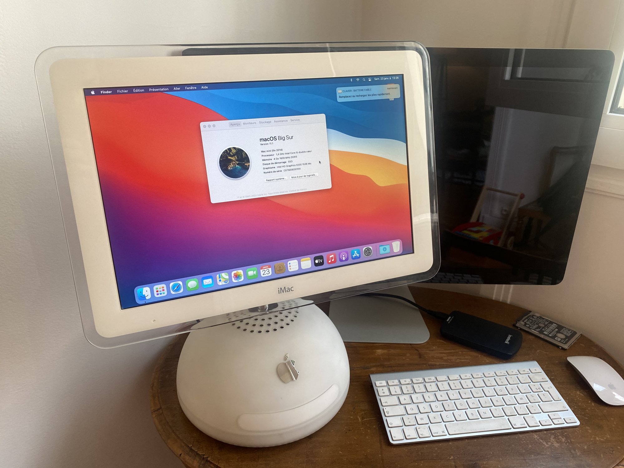

Wow! Seeing that it’s using older hardware (I’m sure), Does it run very smoothly?
If you’re talking about my mod, yes, it is fast. It is a mini 2014, the smallest one, with a i5 @ 1,4 with 4GB of ram, but with a SSD. It is running the beta of Monterey without any issue.
Surely not as fast as a M1, but really cheaper.

Wow - magnificent! OP and other original iMac modders, you guys are legends. This is a beautiful machine. I wish there were a guide for this that a non electrically inclined person could follow, it would be a dream to have an M1 in an original iMac form factor.
Are the screens original or did you guys replace them with more modern ones? Old LCDs seem to get way dim and slow to warm up
Reactions: noblesoul117
I personally used the original display. Yes it is not full HD or 4K, but the disassembling of the neck and the installation of the new wires is really difficult and long. the dimming is not working but i don’t care.
Thanks for your reply! You did an incredible job with the Mac - that seemed complicated to me, the neck disassembly sounds even more difficult then. The displays in your and OP's Macs look great though - bright and vivid.
Yes, it is more than acceptable!

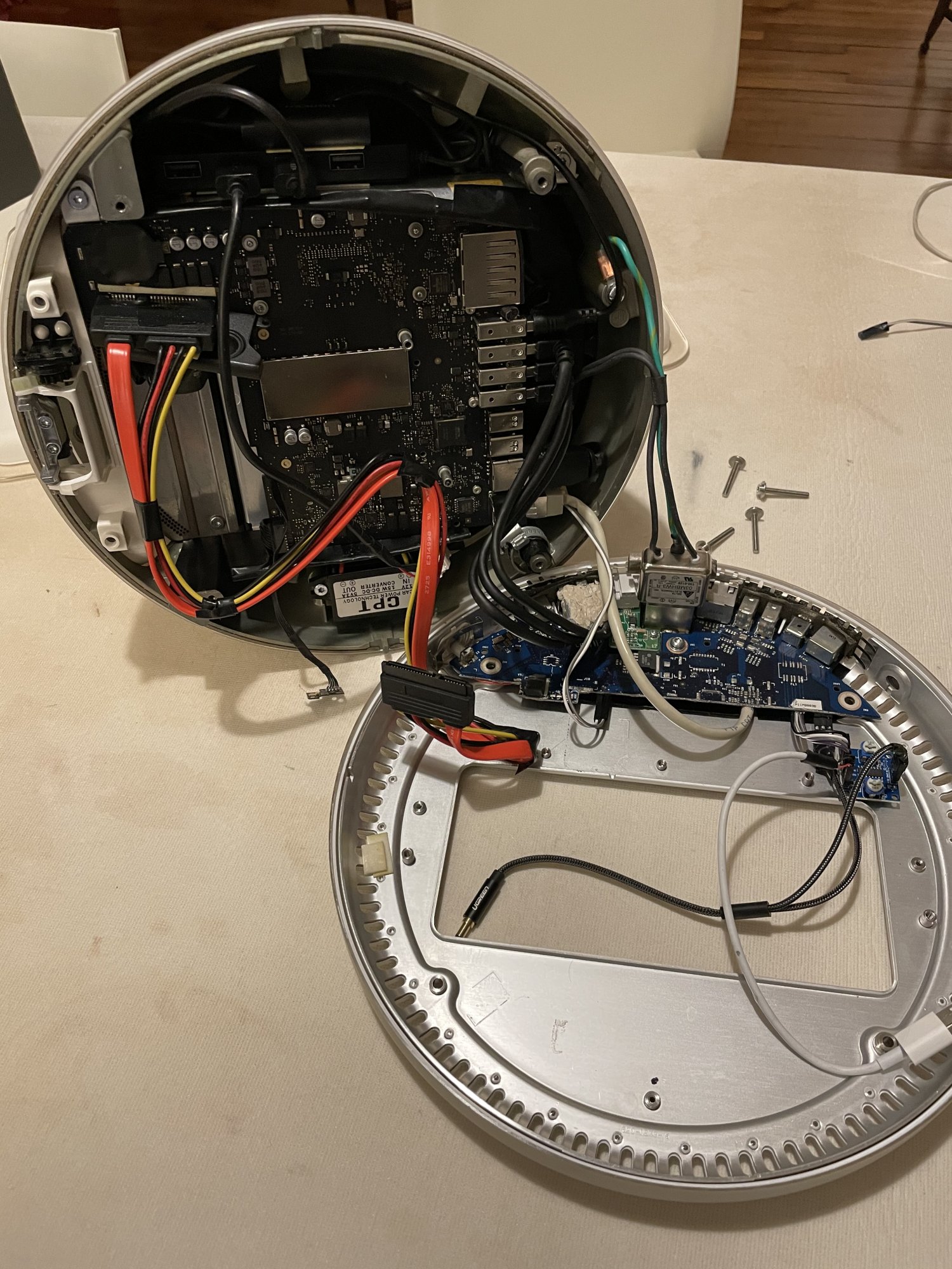

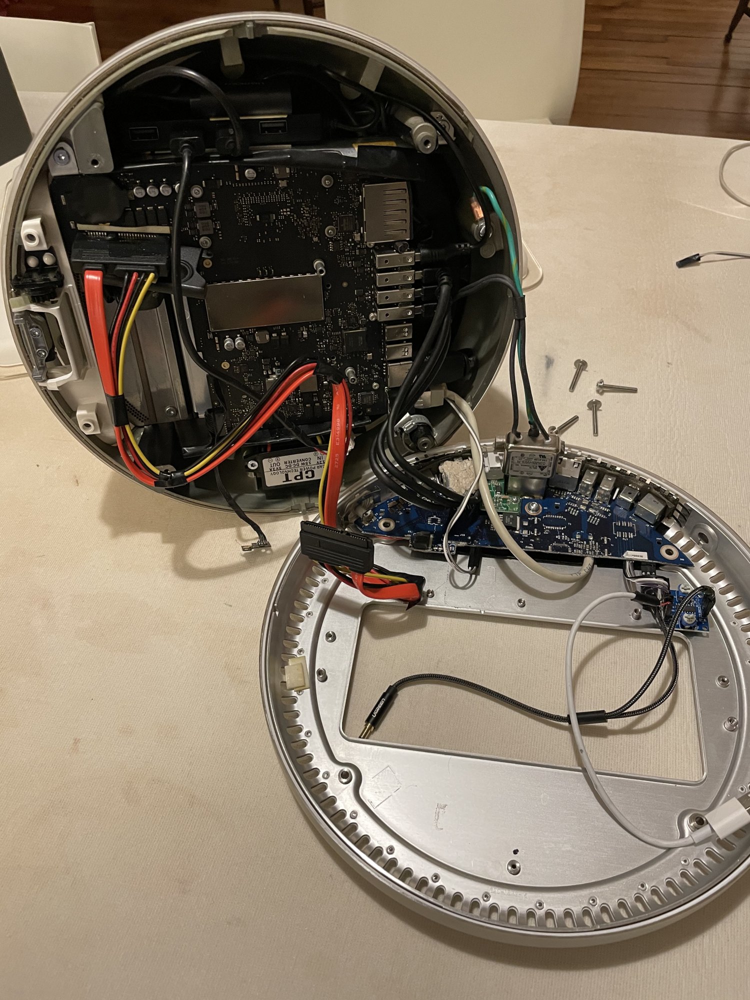

Here it is!
I had to get rid of the DVD drive, it was the only way to insert the motherboard of the Mini

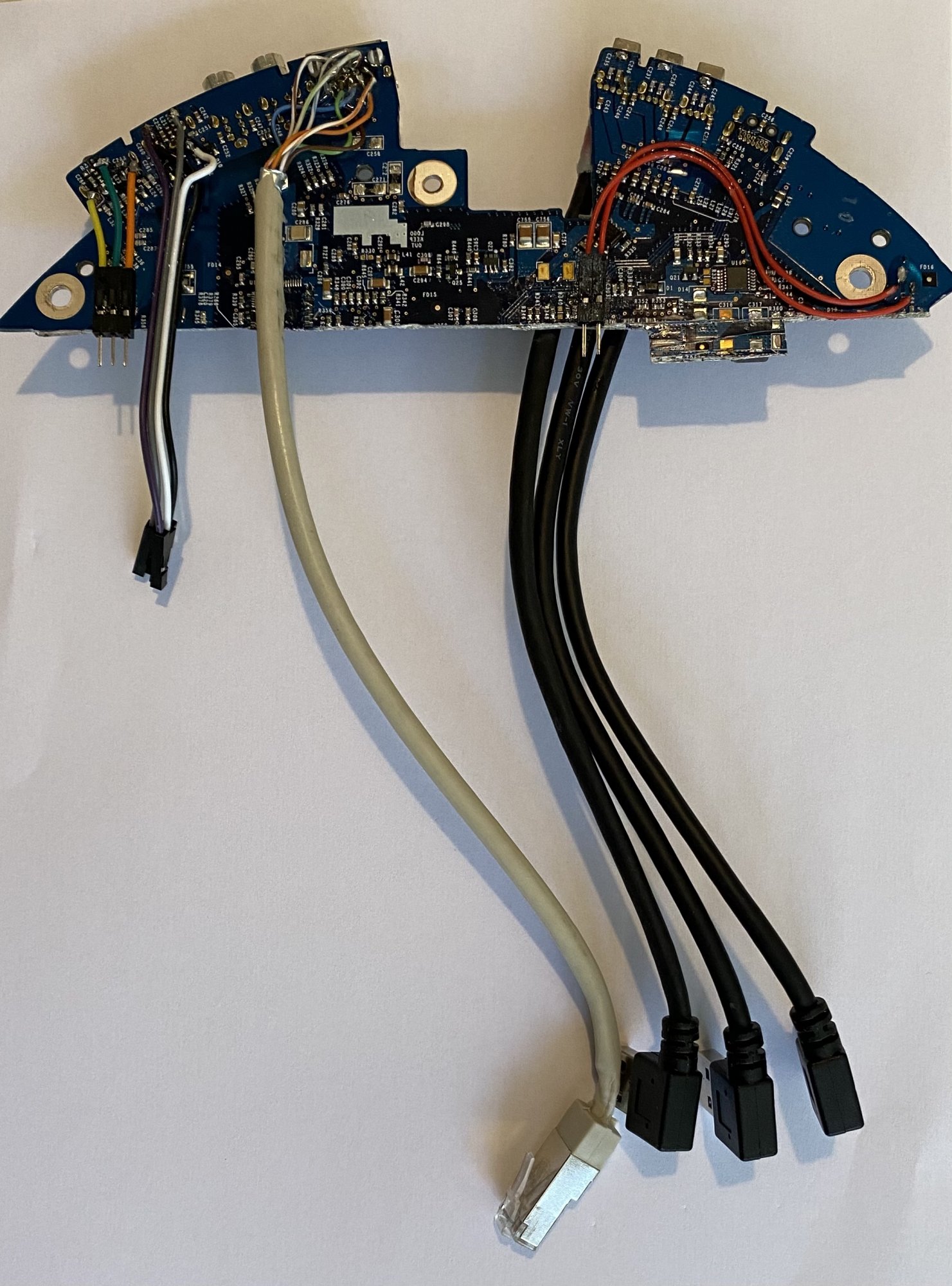

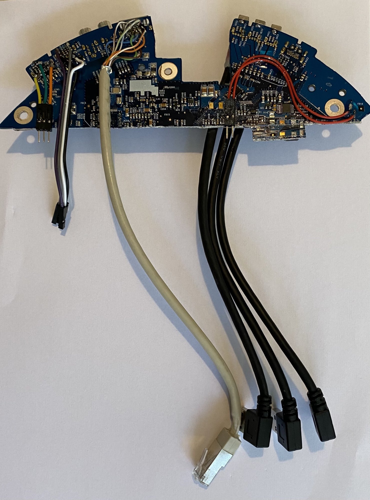

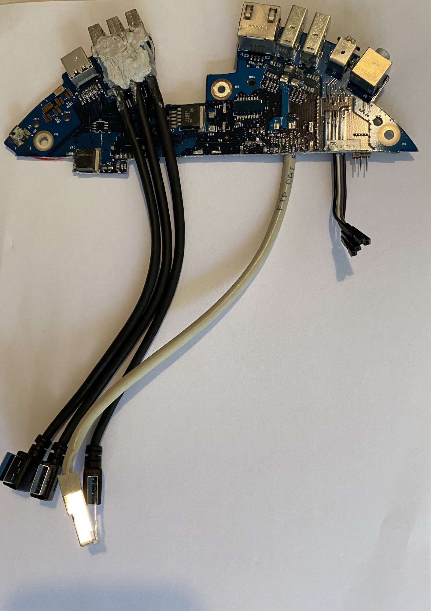

I’m working on my mod since 2019… I first used a 2009 Mac Mini, and upgraded it last year with the 2014. The M1 is still in project, but I use sometimes Windows, and it is not possible with the M1.

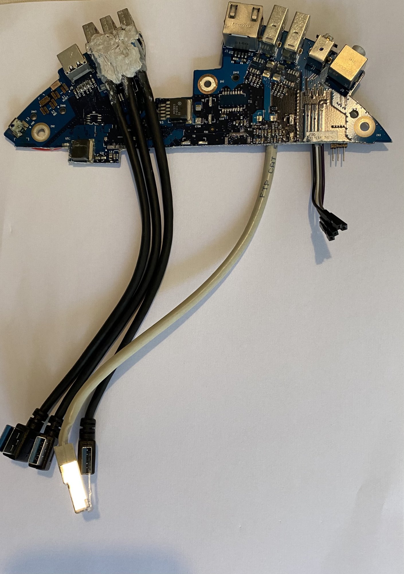

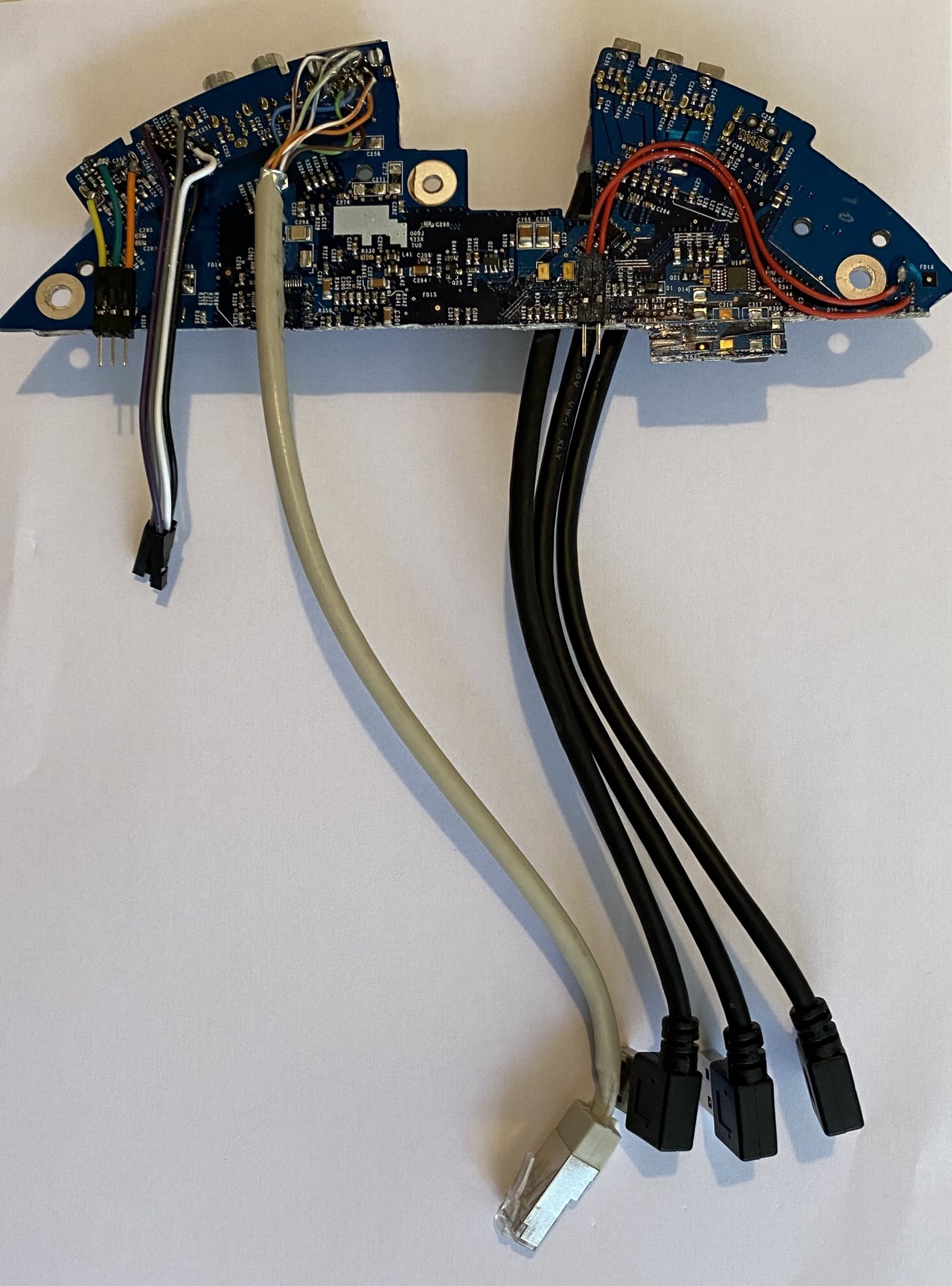

Some pictures of the part of the reused original motherboard :
I soldered cables for Ethernet and sound ports.
Thank you!
Thank you!
