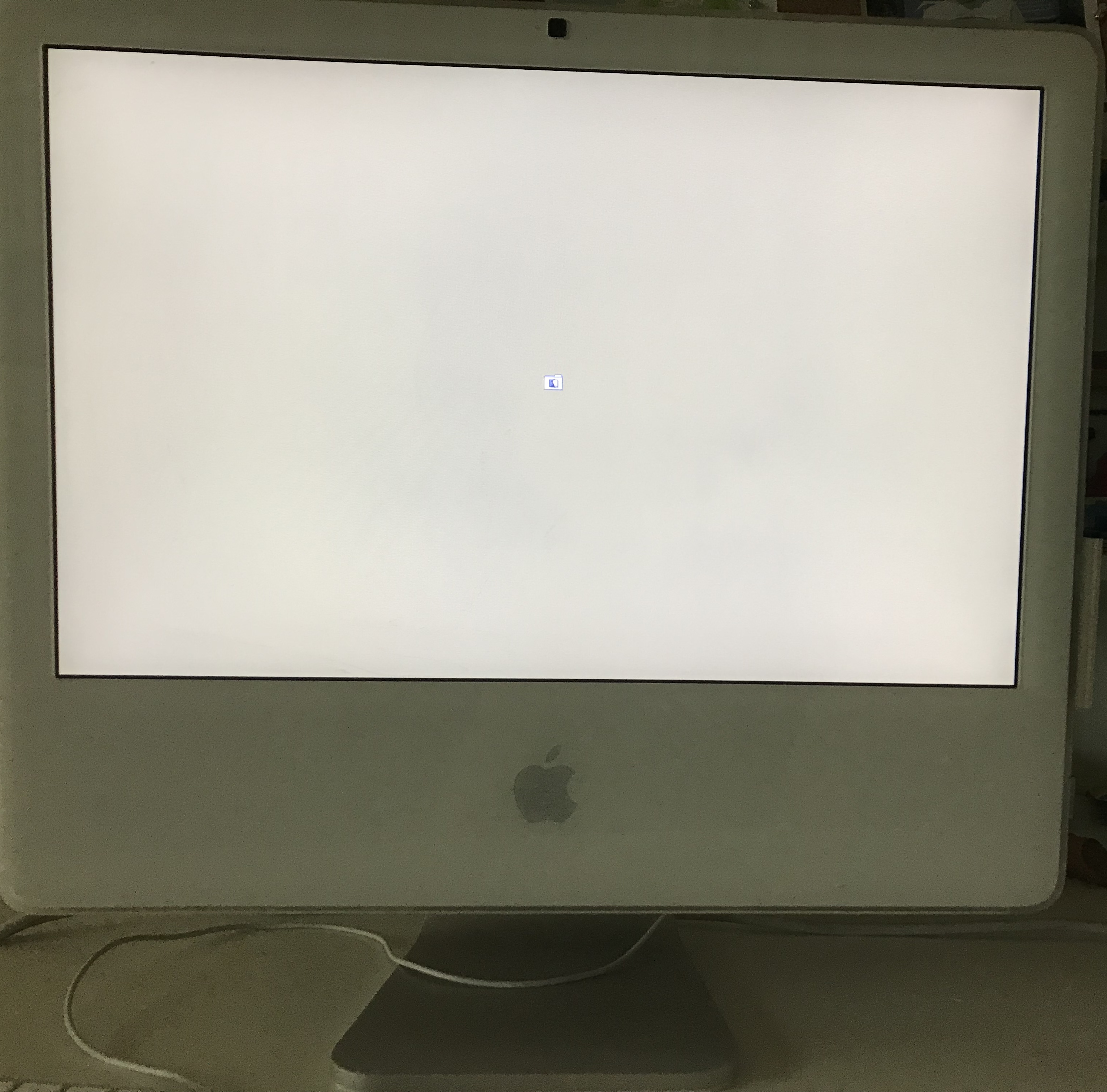

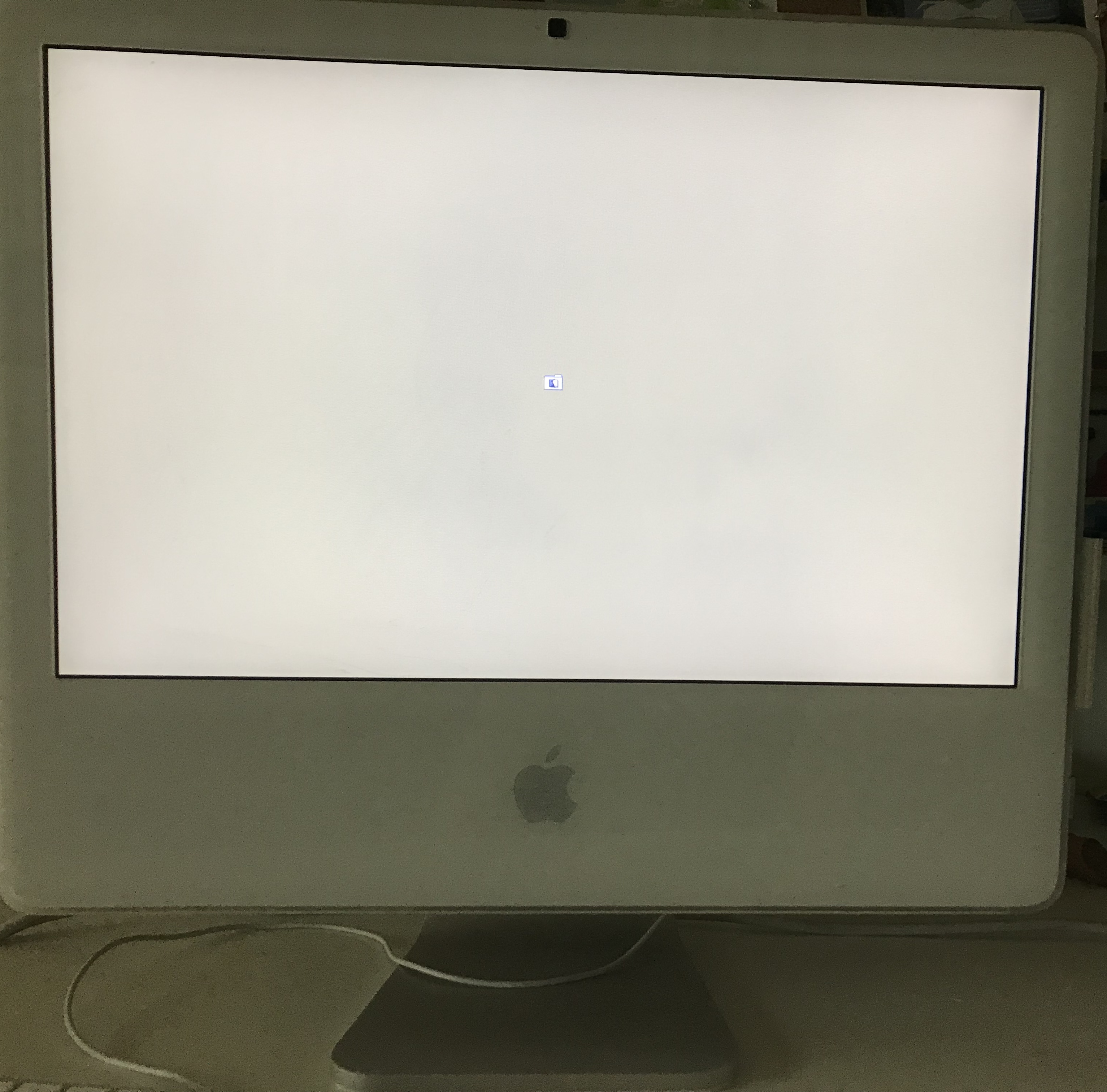

I managed to get a free 20” Intel iMac (one of the early white ones, so it must have come out in 2006) because the owner had a problem with it he couldn’t fix and just gave it to me. (The only reason I think it’s an Intel is because it’s thinner than the G5 version)

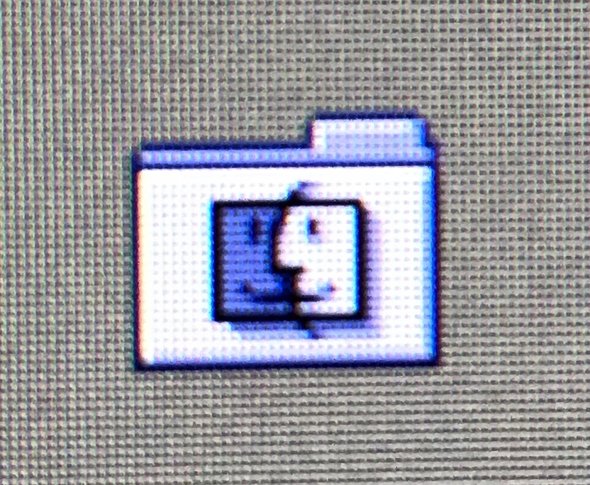

It turns out the problem was that upon pressing the power button, and hearing the chime, it shows an old, 90s-era folder with a alternating flashing Finder logo and question mark (see second and third photos).
By holding down the eject key while booting up I found it had a Snow Leopard Install DVD in it. Unfortunately, when I boot up the iMac while holding “c”, nothing happens.

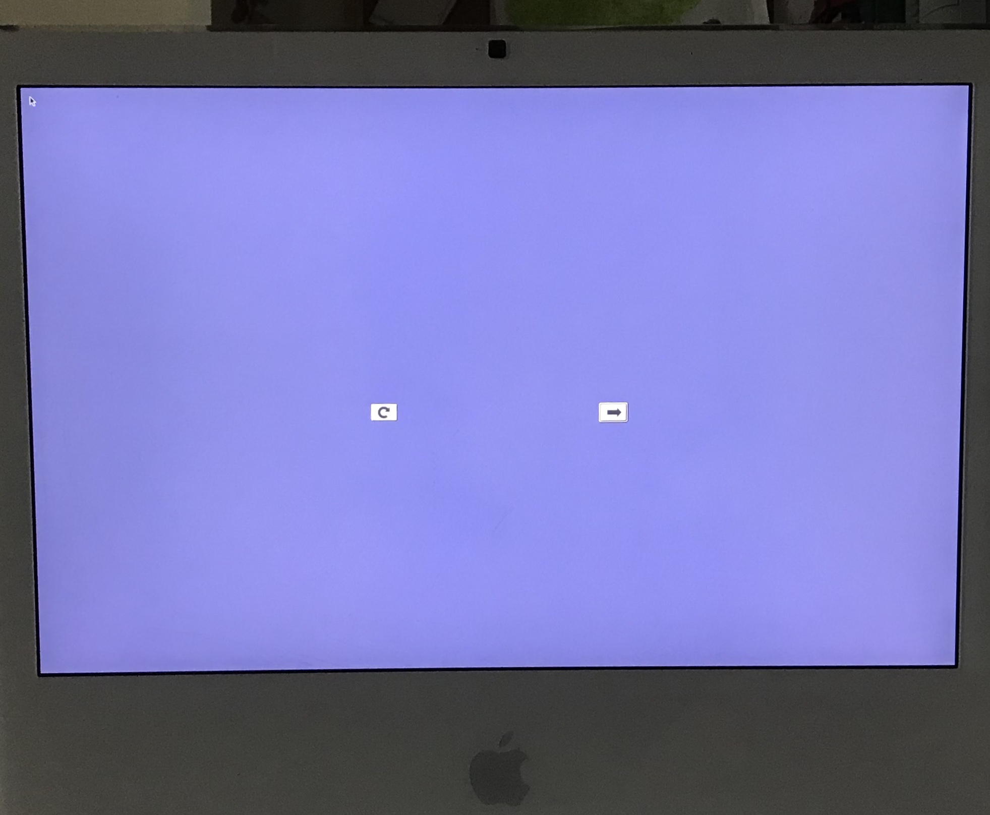

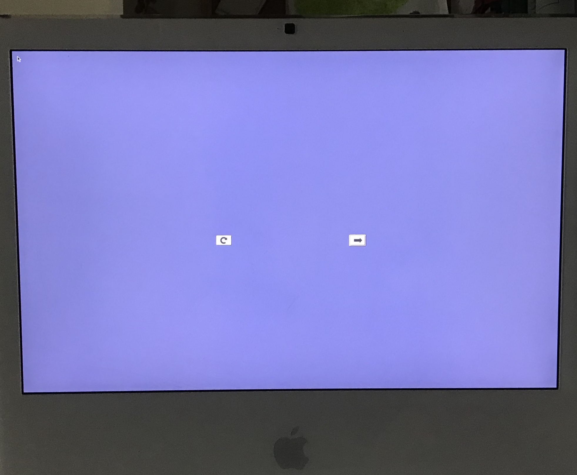

Booting up while holding the “option” key (with the DVD inside) just brings me to this weird screen with the fans running at full throttle (see picture 4). I can’t even move the mouse at this point. (I think it’s weird why these buttons look really old... is this normal to Snow Leopard?)
I have been unable to start up in either Recovery mode or Verbose mode, but Target Disk Mode works fine. Starting up while holding “d” or “c” doesn’t change anything. (It just goes to the alternating flashing folder screen). And starting while holding “eject” does eject the DVD.
Also, if it’s been running for more than about five to ten minutes (on the folder screen), the fans turn on at maximum and won’t quieten down.
I just don’t understand what’s wrong with it! Is there anything I can try? I would really like to be able to use this machine... :/
Any and all help would be appreciated, even if just a suggestion to try something out that I haven’t done yet.

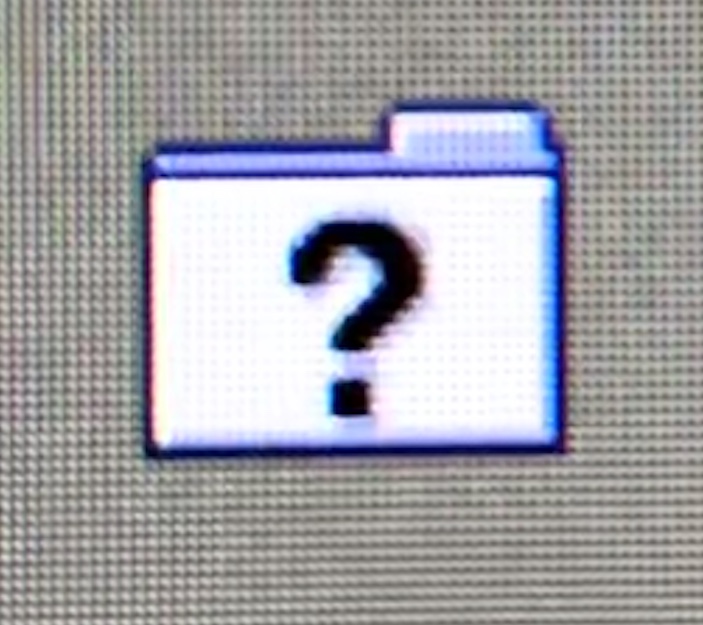

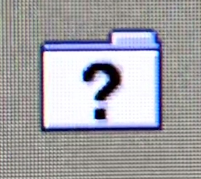

First off, the flashing ? inside a folder means that you have no valid OS installed.
Second, check that the Snow Leopard DVD is the Upgrade version ($20) - not one specific to a machine other than yours.
Third, since the DVD won't even mount, it sounds as if your Superdrive is kaput - a common problem with that item. If this is the case, and you have the correct SL DVD, burn that to a flash drive and install.

Your USB is not created correctly (and is not bootable), or it's not showing as a bootable device because the internal hard drive has failed.
A failed hard drive can sometimes block or prevent ANY boot from any device.
You could open the case, disconnect the internal hard drive (or simply replace with a good drive), and try booting again from an external drive or bootable installer.

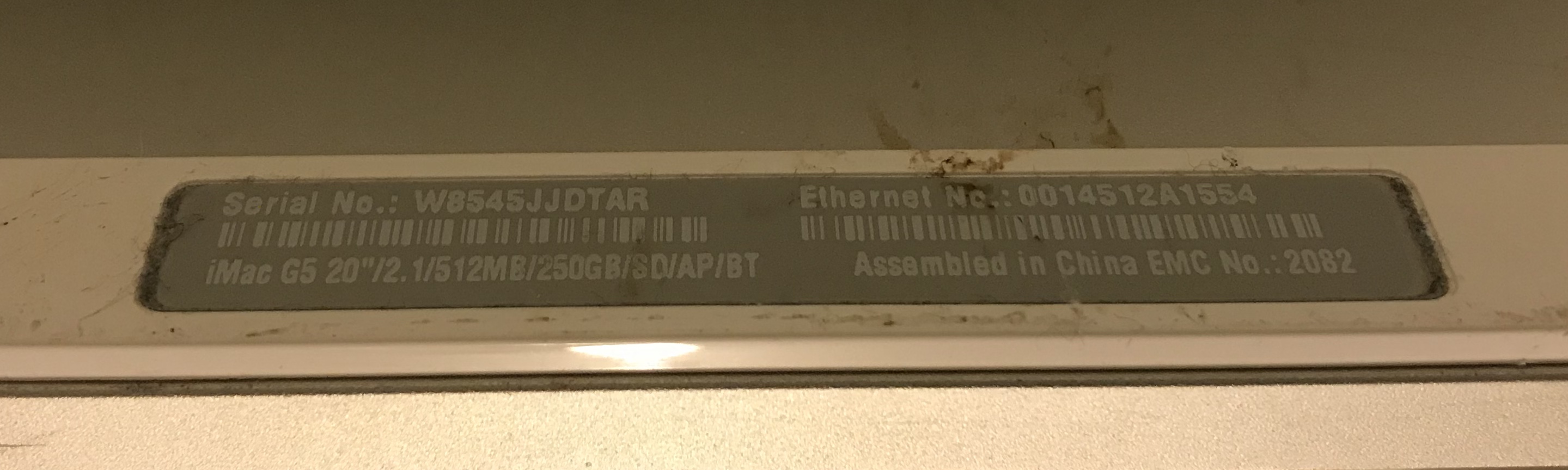

No white iMac shipped with Snow Leopard, so a Snow Leopard DVD would not be the original disk shipping with a white iMac.
But - your may simply have a G5, and not an intel iMac at all.
You should find a serial number label on the bottom of the stand - that will show the original configuration of your iMac.

Look on the underside of the base (the part that normally touches the tabletop). Can't be sure it was there in 2006, but it has been there since at least early 2008 (the oldest iMac I have access to).
The serial number is not on the outside of the iMac anywhere, and the previous owner did not give me the packaging, so I don’t think I’ll be able to find it.
However, due to the ports and the thinness, I believe it is a 2006 Intel iMac

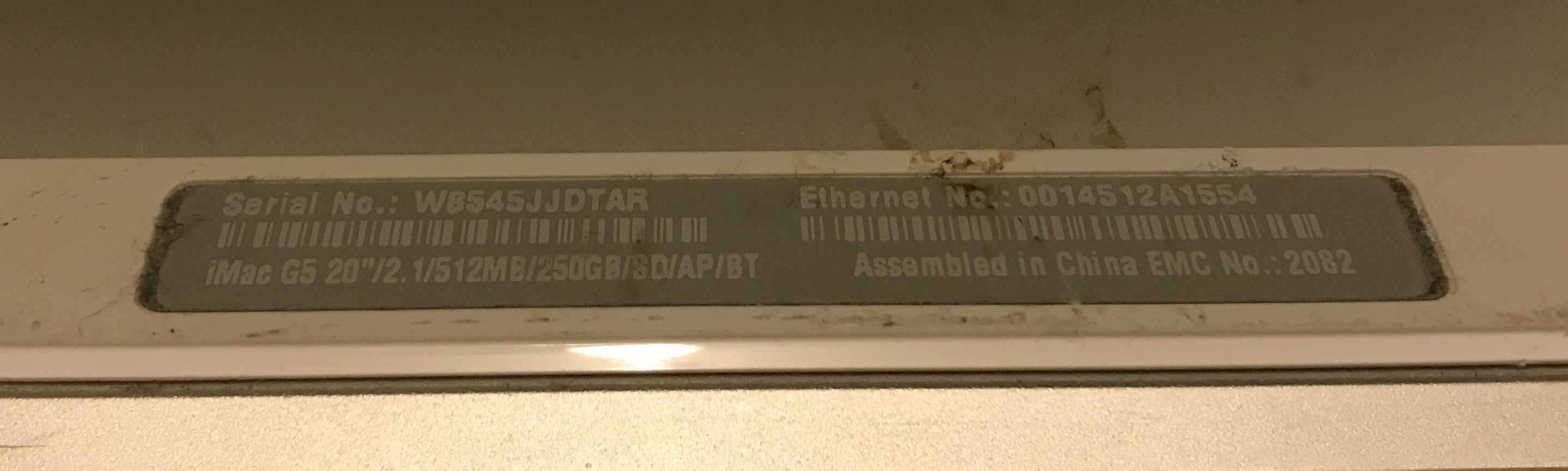

Well what do you know!
It was on the underside of the stand - I didn’t think to look there.
You were completely right - it does say iMac G5. I was wrong!
I made the false assumption because it was thinner than my other G5, and I mistakenly presumed Apple had thinnend (is that a word?) the “new” Intel iMac, instead of a later model. Also, it had the SL DVD inside it.
This is rather unfortunate - I now have a useless Snow Leopard DVD (that the owner for some very weird reason bought and left in the iMac) and a broken iMac G5, with seemingly no way to fix it...

[doublepost=1502391927][/doublepost]I just thought of something - the look of the folder seems quite Mac OS 8/9-ey, is it at all possible that the iMac doesn’t even have Mac OS X on it?

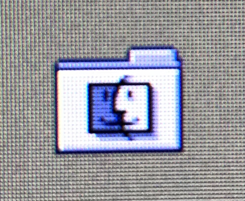

The simple screen icons do NOT indicate that you might have Classic Mac OS installed, as it can't boot to OS 9, for example. It will support the Classic environment, if you want to run Tiger on that G5 iMac.
I'm pretty sure all you are seeing is the icons provided in firmware, showing you the flashing folder icons. That just indicates that your iMac can't find a bootable system.
So, all you need is a standard install of Tiger (higher than OS X 10.4.2), or Leopard OS X 10.5
You can download an installer image for Tiger OS X 10.4.6 from www.macintoshgarden.org (scroll down to find the Tiger_4_6.dmg )
Although it is now moot, the Upgrade SL DVD has a nice picture of a snow leopard on its face, while machine specific releases are usually grey-faced.
For everyone else here that's confused by this jumble of threads, old folder icons == new world ROM == ppc mac
The intel folder icons look very different.
