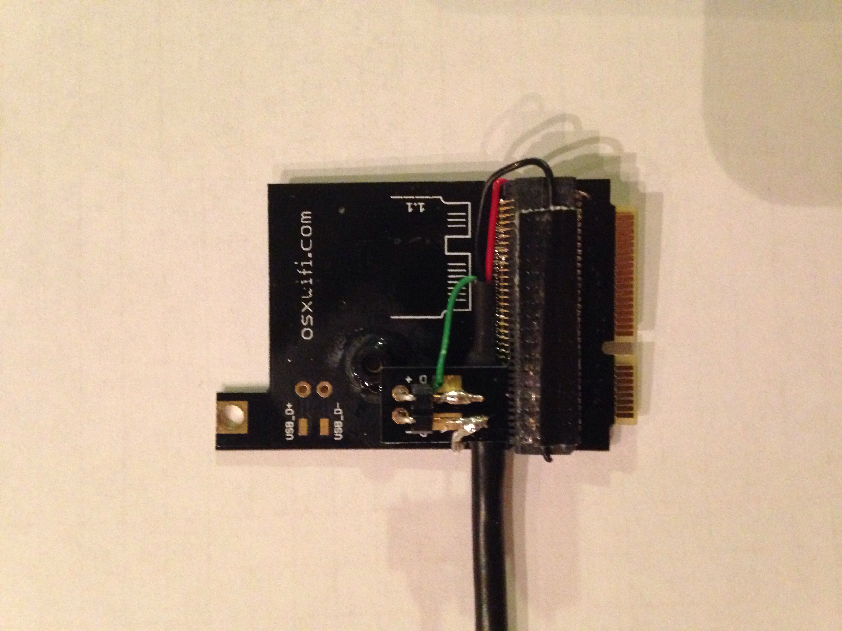

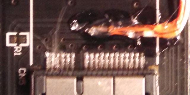

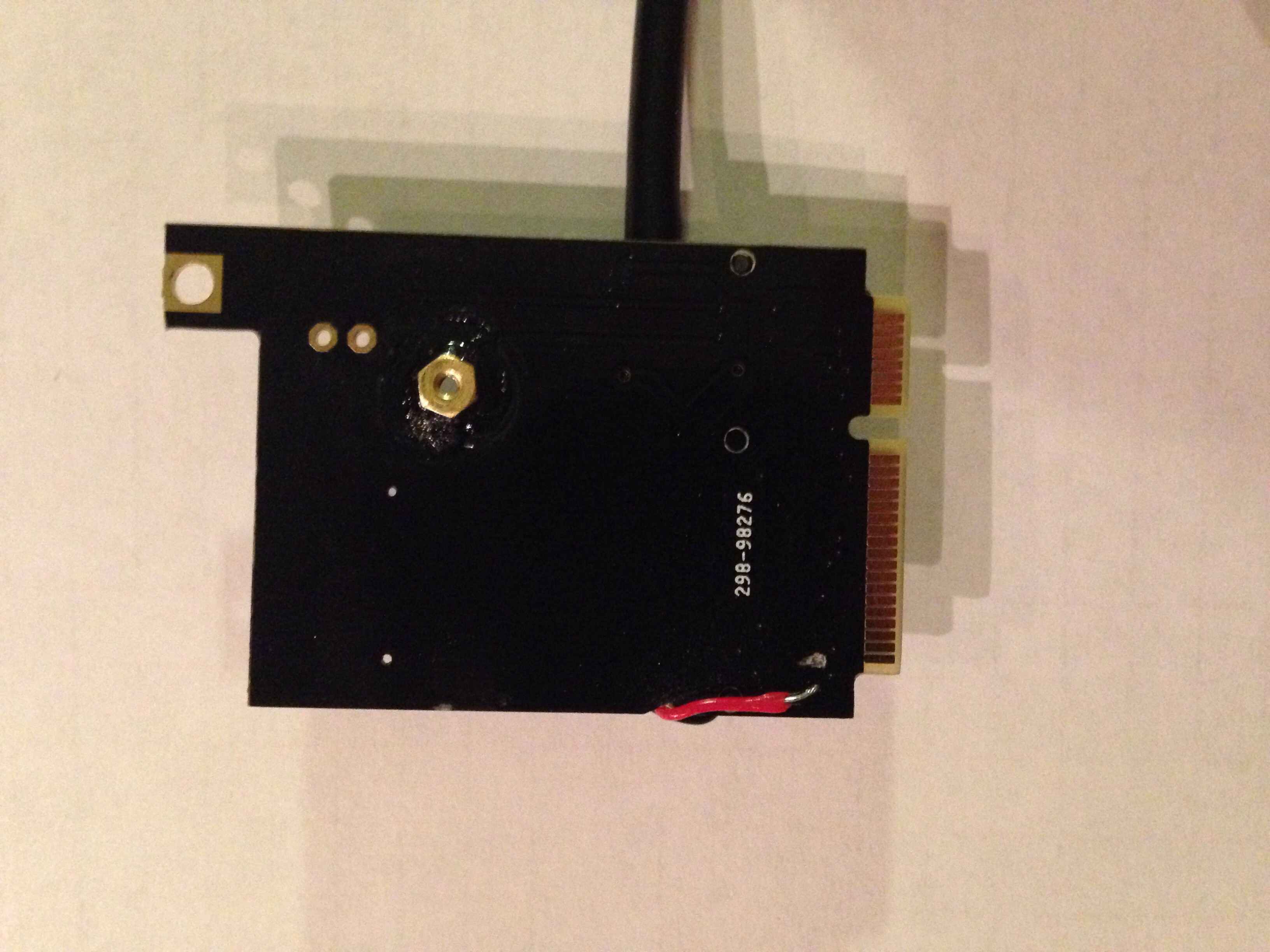

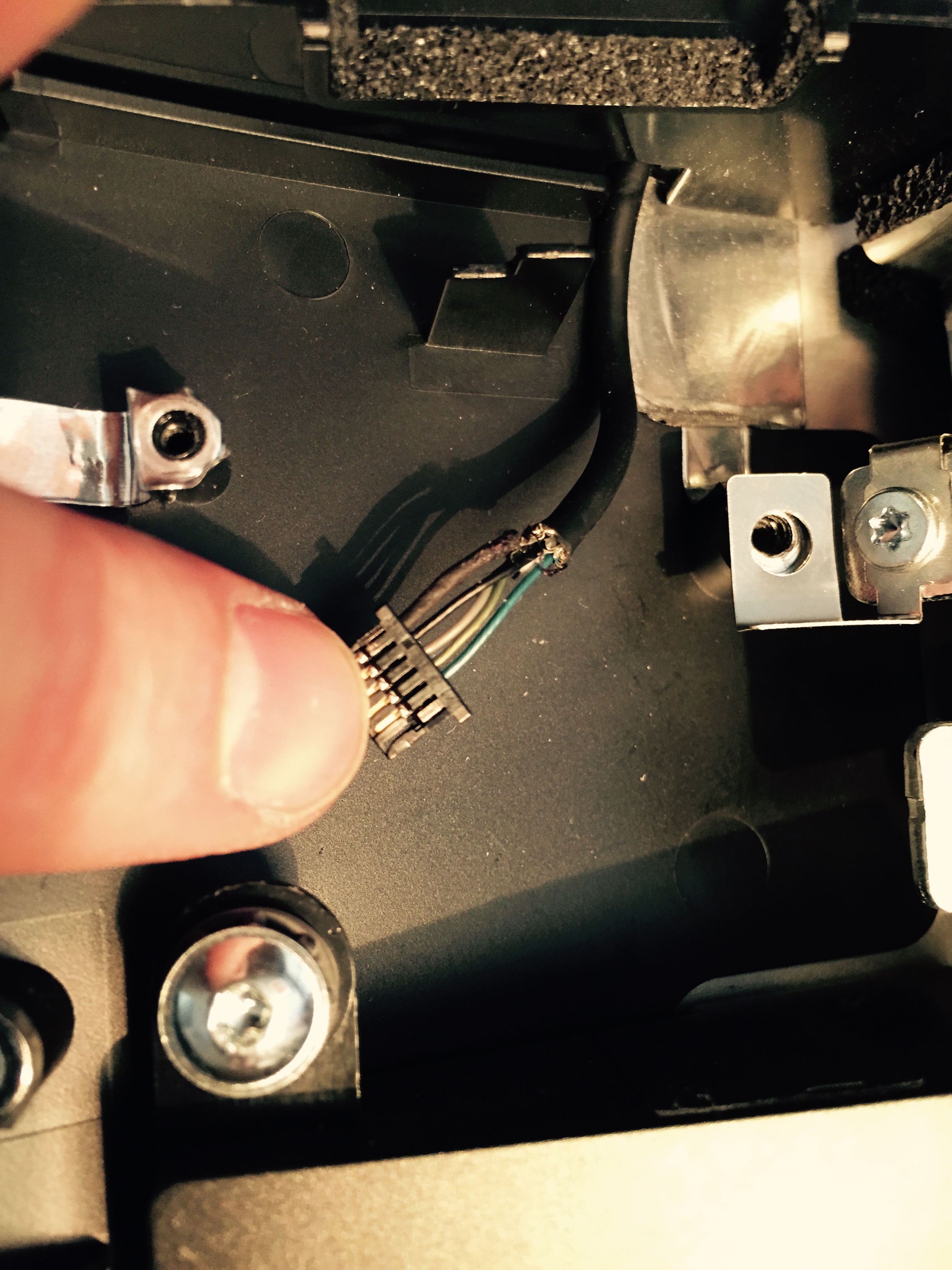

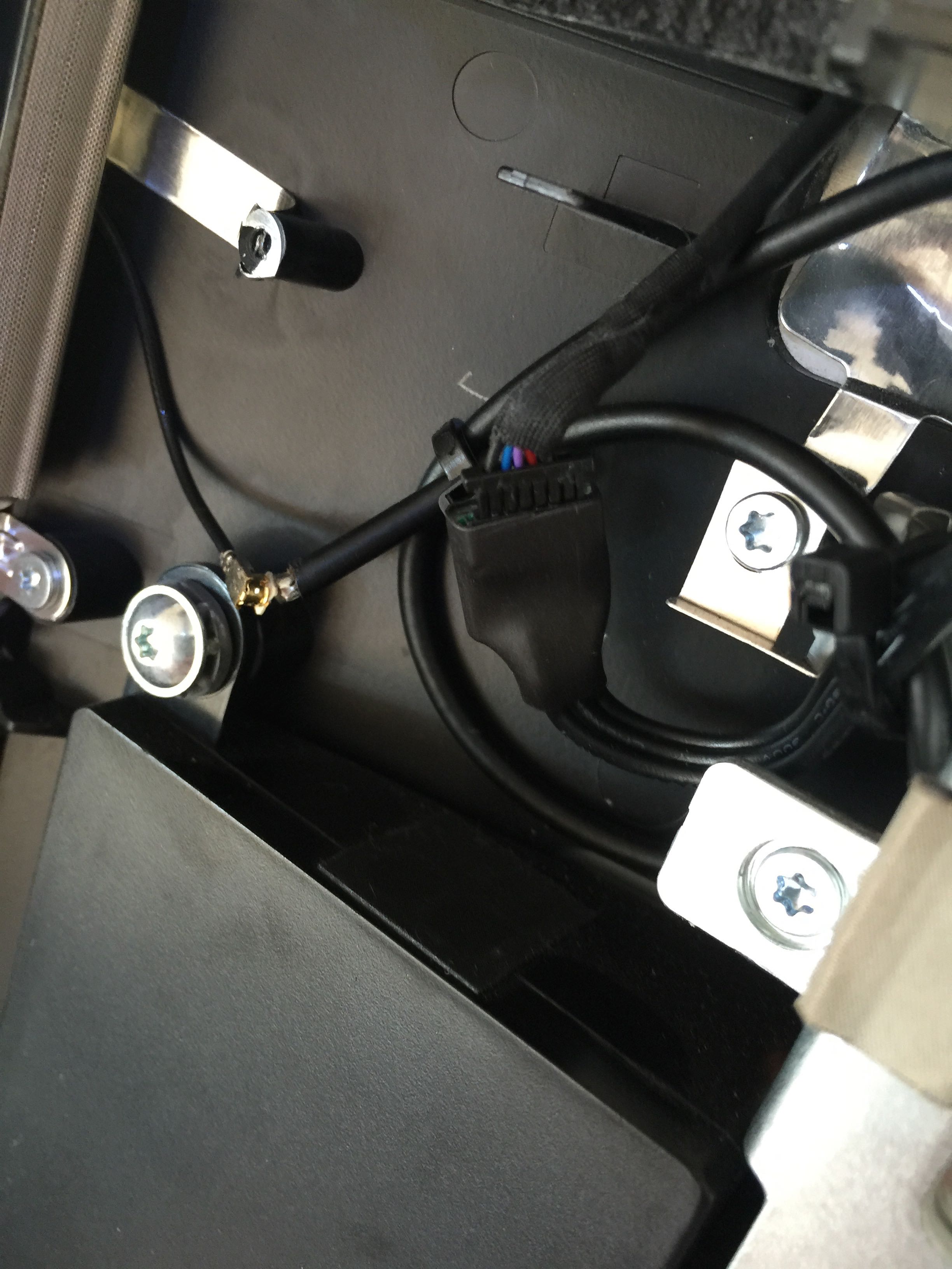

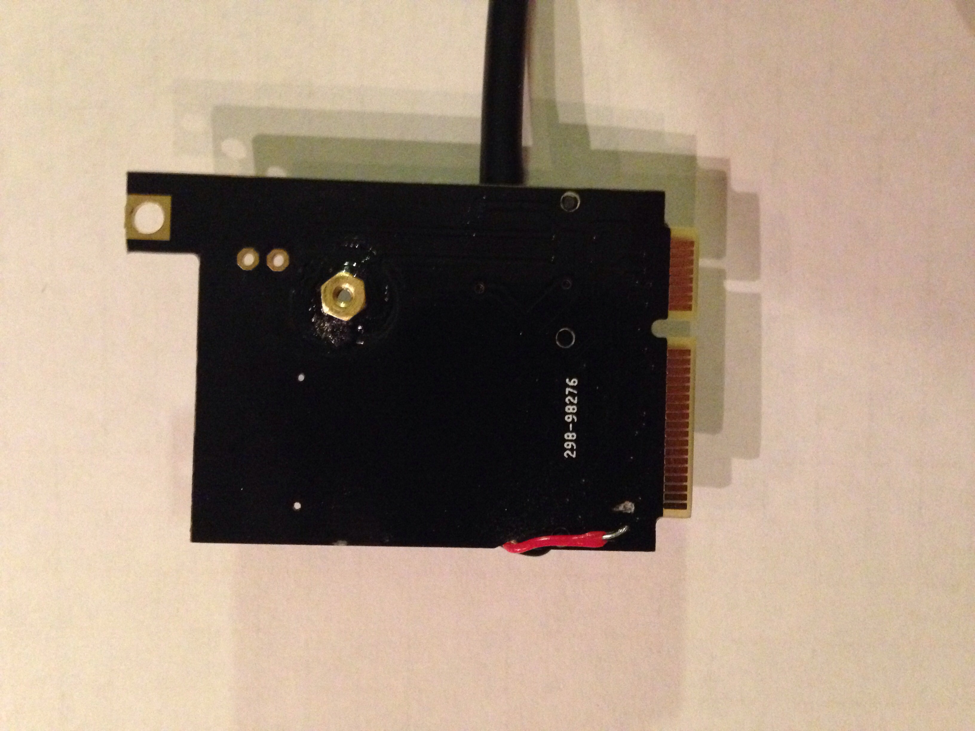

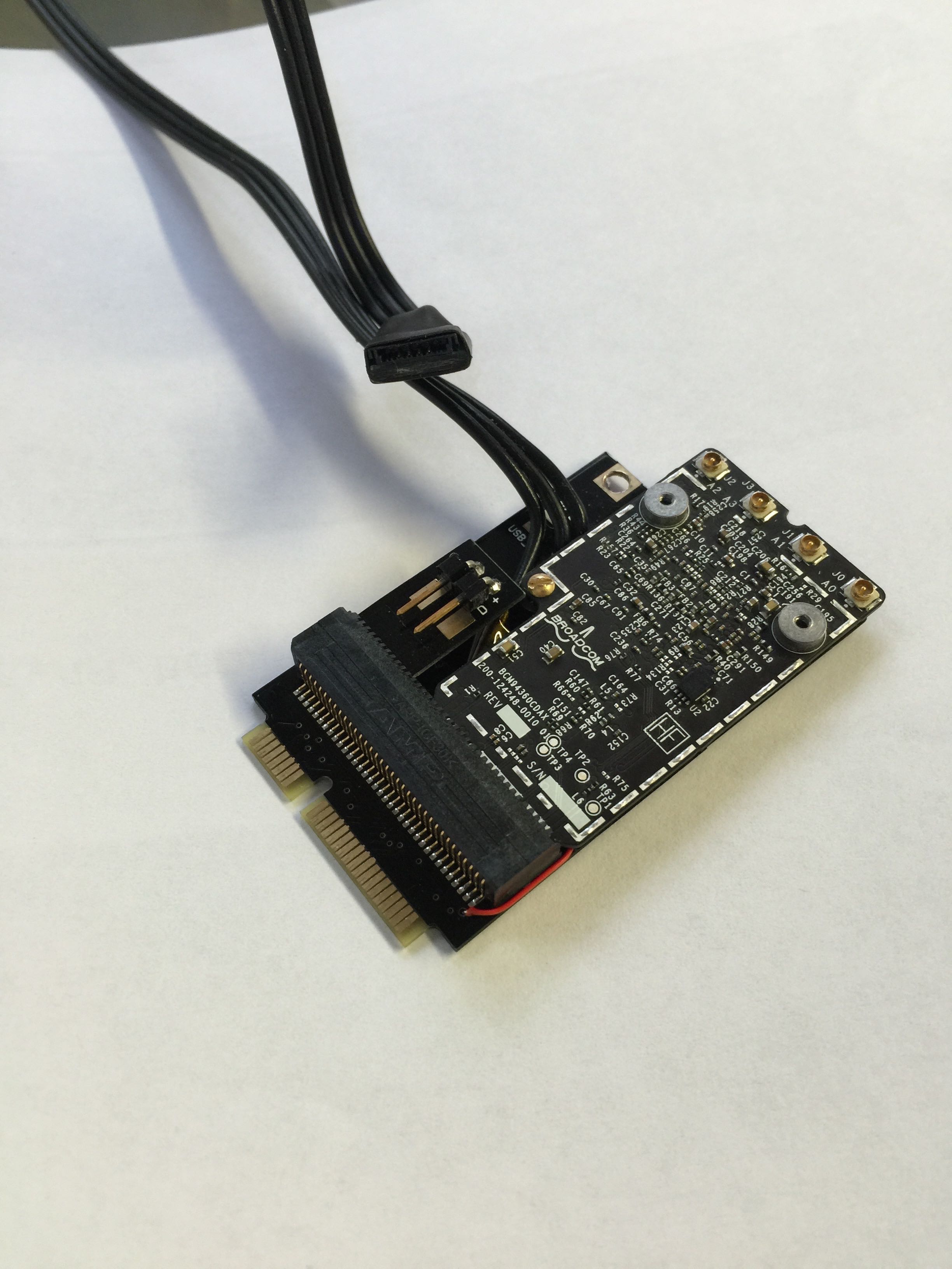

Cordes, I bought a 3 foot usb extension cable from Radio Shack and cut it in half. I soldered one end to the old internal Bluetooth cable after removing the connector. I took the other half of the usb cable and soldered the green, white and red wires as shown in the photos. The opposite ends of the usb cable half can then be plugged into each other and used as the new connector. There is a small hole in the adapter card at each pin location just big enough for the usb cable's red wire. The hole also places the end of the wire in the perfect position to be able to solder it to the last pin on the card.
Next to the hole where the red wire passes through to the front, I scraped away an small section of the printed circuit leading up to the hole and red wire. This effectively disconnected the last pin position from its original 3.3v source and prevented me from having to do any desoldering.
I left the black wire of the usb cable disconnected and taped out of place. It is not needed in this configuration.
You will also notice that I used superglue to attach the nut and spacer to the adapter card. This helps when installing everything back in.
Good luck! Let me know how your mouse works.
Photo of front of adapter card.
BTW, the WiFi antennas are labeled with marks corresponding to their number. I bought another antenna from OSXWiFi to use as the Bluetooth antenna and mounted it at the top of the iMac. I left the old Bluetooth antenna disconnected in place. I wonder if the new antenna reception is intermittent and that is causing my occasional mouse issues.

I can tell that the 12" antenna pigtail I purchased in hope of reusing the existing bluetooth antenna is just a bit short, so I did go ahead and order a new antenna from OSXWiFi, too. Hopefully I can place it where it will be effective for mouse, etc.
Others have reported different wire colors going to the current bluetooth card. I can confirm that the top wire goes to the shielding. I will assume that regardless of colors, they are positioned as in the diagram that Czo has shared. I have attached a photo of mine.

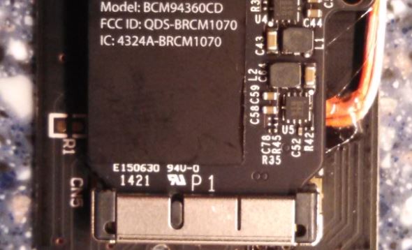

I've got a Late 2009 27" iMac and just got my kit from OSXWiFi. It looks like ekroy has figured out that we have to run USB D+ and D- data signals from somewhere to the new card. I don't want to cut and solder wires in my computer. I'd much rather have a nice adapter that I can always revert back to stock if desired or needed. With that in mind I just ordered two Bluetooth modules for $5 each. Maybe I can break it down and use the on board connector to make an adapter cable.
http://www.ebay.com/itm/Apple-27-iM...luetooth_Adapters_Dongles&hash=item20ea57bc3e

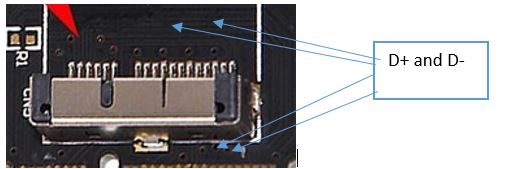

I finished the upgrade on my iMac, and its connected the board to the internal usb pins.
This iMac (Mid 2011 27") removes the power from the MiniPCI-E slot when the wifi turning off. The slot is not powered when the computer starting (unable to press cmd to open boot menu), and recovery not working when only the USB D+ and D- are connected to the bluetooth board.
I'm figured out of the internal usb header pins, and using this connector to supply the bluetooth part of the wifi card.
First,i needed desoldering the rightmost pin (when the osxwifi's adapter in the slot) of the adapter card, and make a wire to the the bluetooth connector. This is the osxwifi card, with the red wire connected to the rightmost pin of the adapter: http://homokozo.czo.hu/iMac2011mod/iMac2011OSXWifiExtra.jpg
After i connected (soldered) everything, the bluetooth started working.
This is the pinout of the internal bluetooth module, and cable: http://homokozo.czo.hu/iMac2011mod/iMac2011BT.jpg
Both of the black wires are GND, but one of them are not connected.
Next wire is white, this is the USB D+.
The pink/violet wire is the D-
Red or brown wire is the 3.3V
I secured the card on the slot with cable ties ( http://homokozo.czo.hu/iMac2011mod/t18r-tbk.jpg )

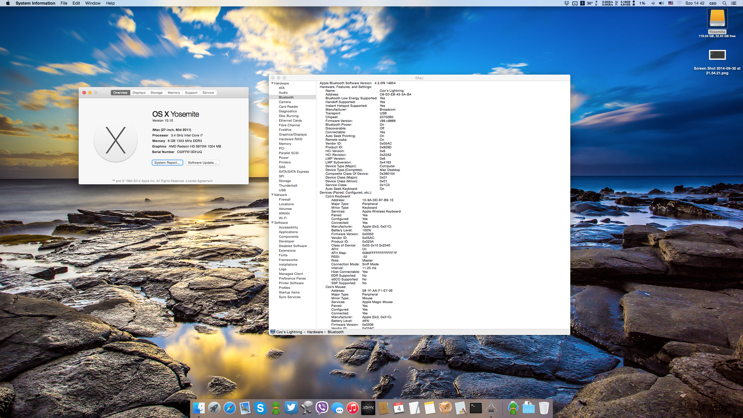

What's working:
- startup keys after the boot chime (cmd+s, cmd+r)
- successfully boot mavericks and yosemite RC recovery
- Handoff and Airdrop are compatible with Yosemite RC1: http://homokozo.czo.hu/iMac2011mod/iMac2011-bt4upgrade.png

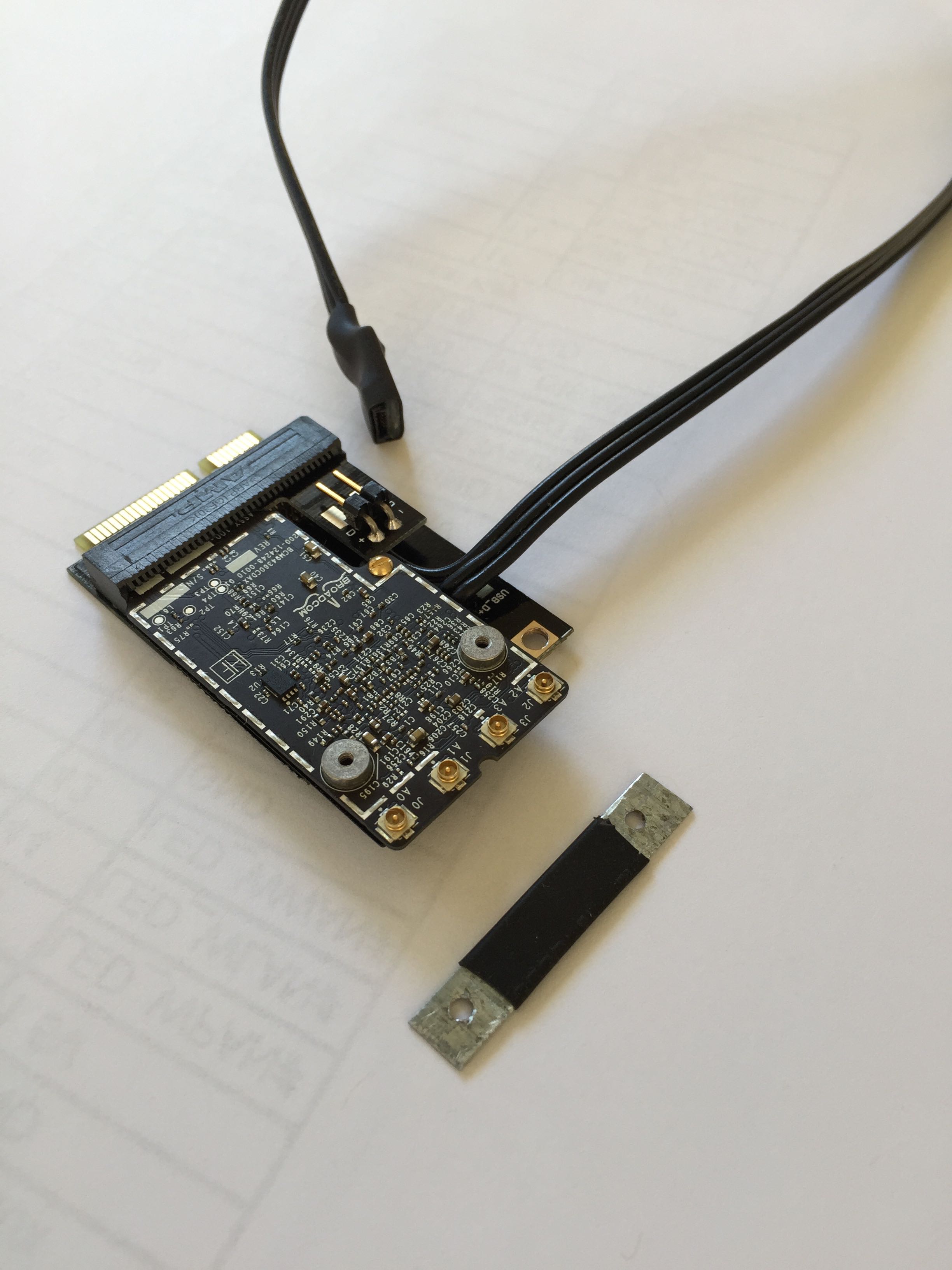

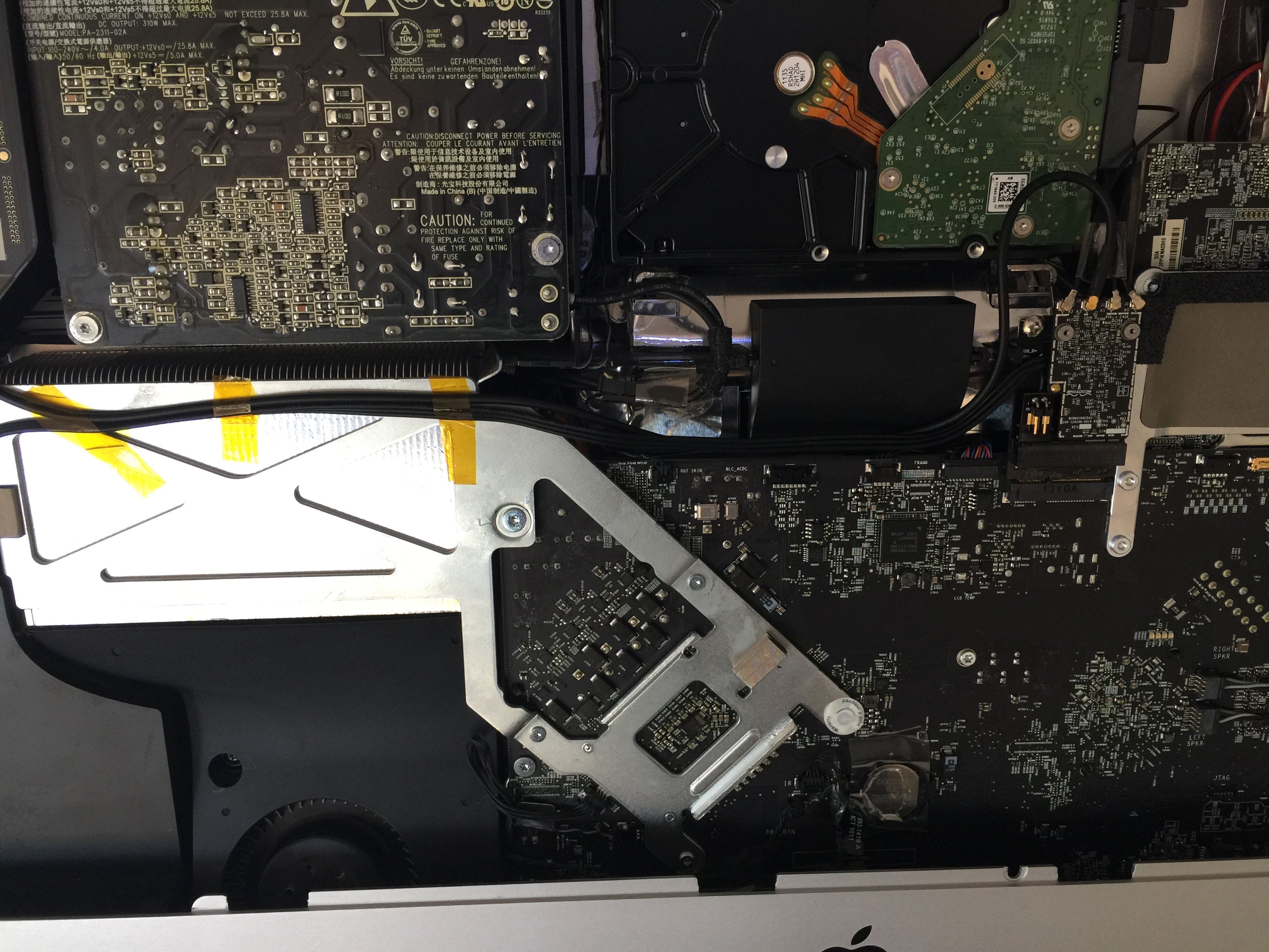

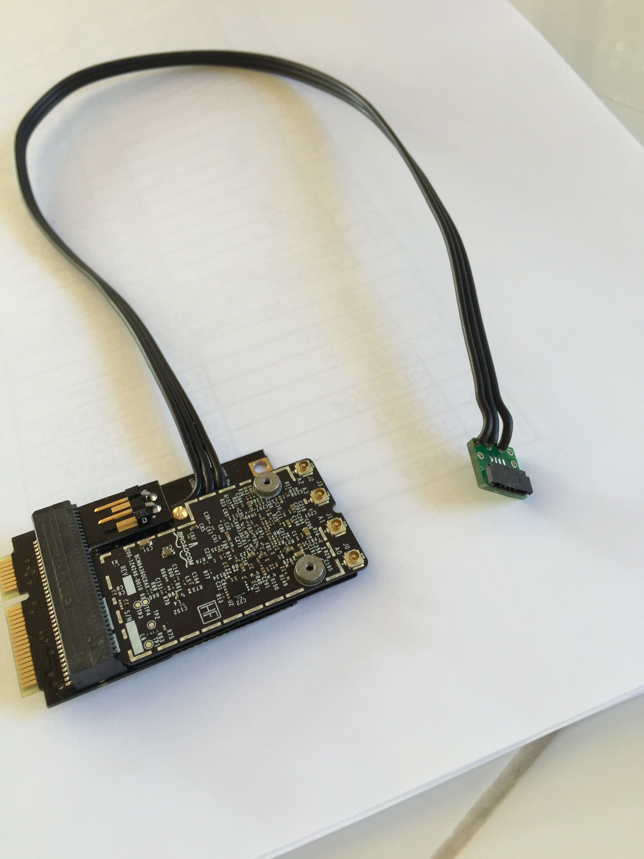

Hello.
I just wanted to thank everyone that has posted their ideas in upgrading the bluetooth card / wireless adapter. I have completed my upgrade without cutting the connector off the original bluetooth adapter. It has taken me a bit of research but I wanted to share with everyone the components I used and some pictures of the completed product.
I purchased a couple of original iMac bluetooth cards from ebay for around $5.00 each to see if I could get the connector off the bluetooth card to wire up to the OSXWifi adapter. The best way I found to get the connector off was to use this ChipQuick SMD kit.
http://www.amazon.com/gp/product/B0019UZP7I/ref=oh_aui_detailpage_o06_s00?ie=UTF8&psc=1
Using this makes removal of the connector much easier. There are several Youtube views you can watch on how to use the product. It works great -- I destroyed two different connectors before getting this.
Next I found this PCB to mount the connector to.
http://www.schmartboard.com/index.asp?page=products_partnum&id=450
The pins on the connector will align up perfectly. Cut the board that has 8 pins in half and epoxy the bottom of the connector the circuit board to make sure it doesn't move. Then solder the pins to the traces.
I used a three conductor cable and soldered directly to the OSXWifi board for the USB +/ -Data and Vcc power connections. I cut the trace on the card going to pin 1 and connected a small wire directly to pin 1 as others have stated in-order to control the power to the WIFI card and bluetooth. I then wrapped the new connector assembly with heat shink tubing.
The OSXWifi board does not have a mounting hole to correctly mount to the right side of the iMac, so I made a small bracket with flexible metal to attach to the left side mounting hole on the OSXWifi card and this provide a secure connection without using zip ties.
Next the antenna connector - I wanted to use the original iMac antenna but on the 27" iMac the 12" antenna extension will not work. I found this 24" extension that works perfectly and is also only $6.00.
http://www.data-alliance.net/servlet/-strse-757/U.FL-I-dsh-PEX-HiRose-extension/Detail
I have been using my new card for about two days and has been working great. Thanks everyone for your posts and I hope this information will help others in the forum.
