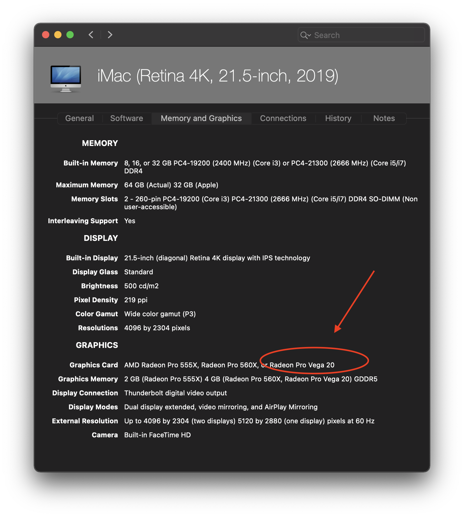

They did not. The 50% faster GPU claim was referring to the 21 inch iMacs it replaces. The Pro Vega 20 never was an option in those. Radeon 560X was the maximum you could get. And the M1 GPU is indeed roughly 50% faster.
Nope, the Vega 20 was an option for 21.5" iMacs and wasn't available for 27" iMacs.
