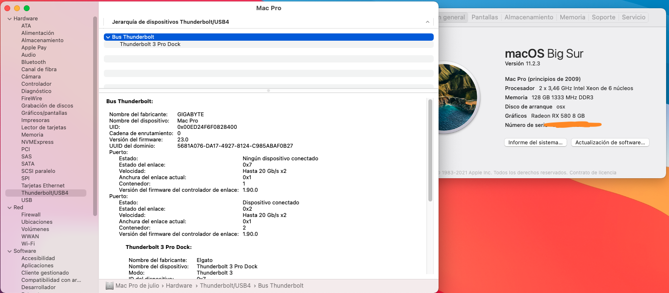

Hello guys, i have a problem installing and config my Titan Ridge 2
I follow all those videos (4)
parte 0:
parte 1:
parte 2:
parte 3:

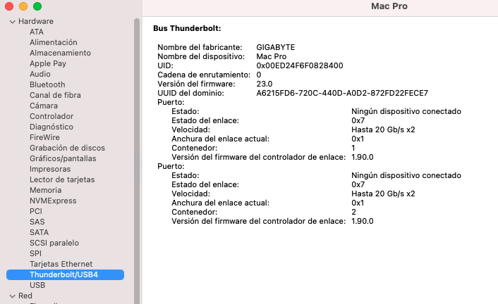

And this is how my Titan Ridge looks like on my Mac settings (see image attached)
I'm using opencore 0.6.8
and my config file looks like (attached file)
Now i'm trying to connect an USB using apple connector (link product) and also trying to connect ElGato Thunderbolt 3 Pro but doesn't recognize.
What could be wrong?
Regards

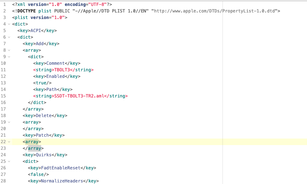

Did you enable the TB3 SSDT?
Hello @h9826790 yes my card is enable , if you see my config.plist file attached, you can see that is TRUE the corresponding tag.
But after restart 3 times today, it doesn't work, my mac pro 5.1 doesn't recognize. Yesterday at nigth it works, i don't know how, but it works and my ElGato dock also works. But today nothing
I was on mobile device, and haven't check your config. But the screen capture doesn't looks right to me. Your card still recognize as a Gigabyte device, but not an Apple device.
Reactions: pwillis
How config apple device?
I modify the config file again today, just how you see on the image attached
I don't how about Apple device, how should i do this?
I found this link : https://zephyrsmarket.com/collectio...titan-ridge-thunderbolt-3-flashed-for-mac-pro
and I follow all again, but my mac pro 5.1 doesn't recognize

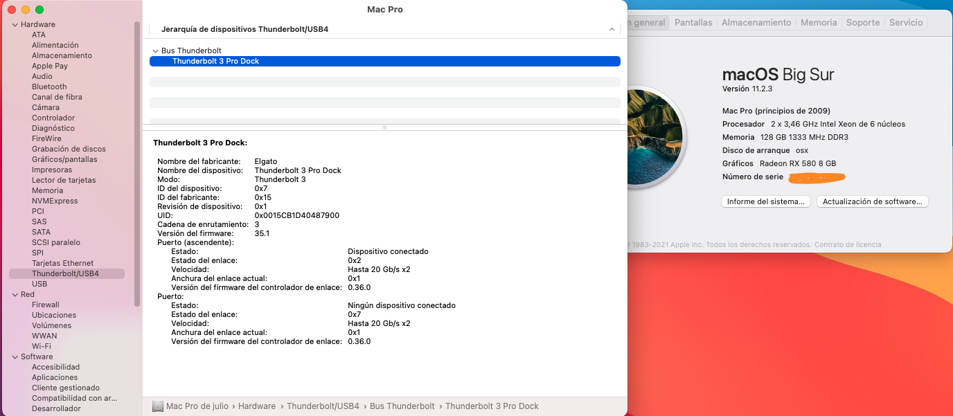

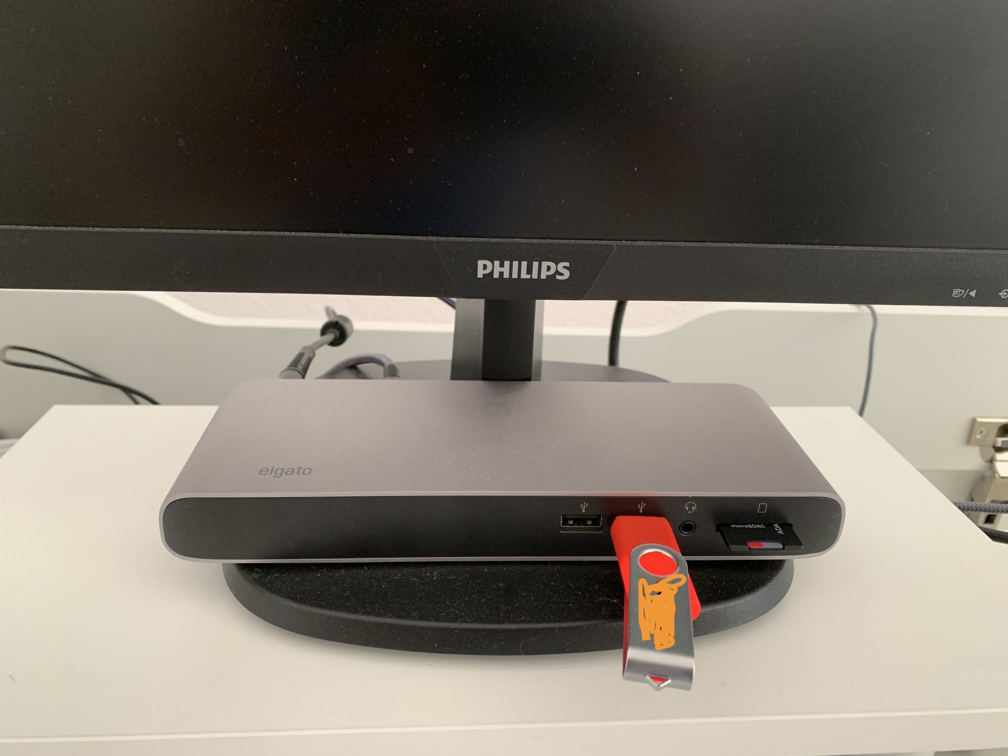

Hello everybody
After a lot of time and several clean install .... I GOT
And this is how it looks
Thanks for all guys
Regards

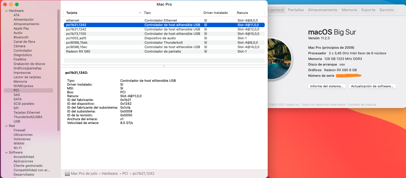

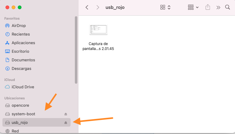

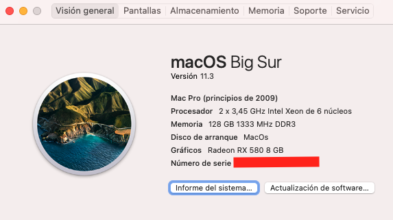

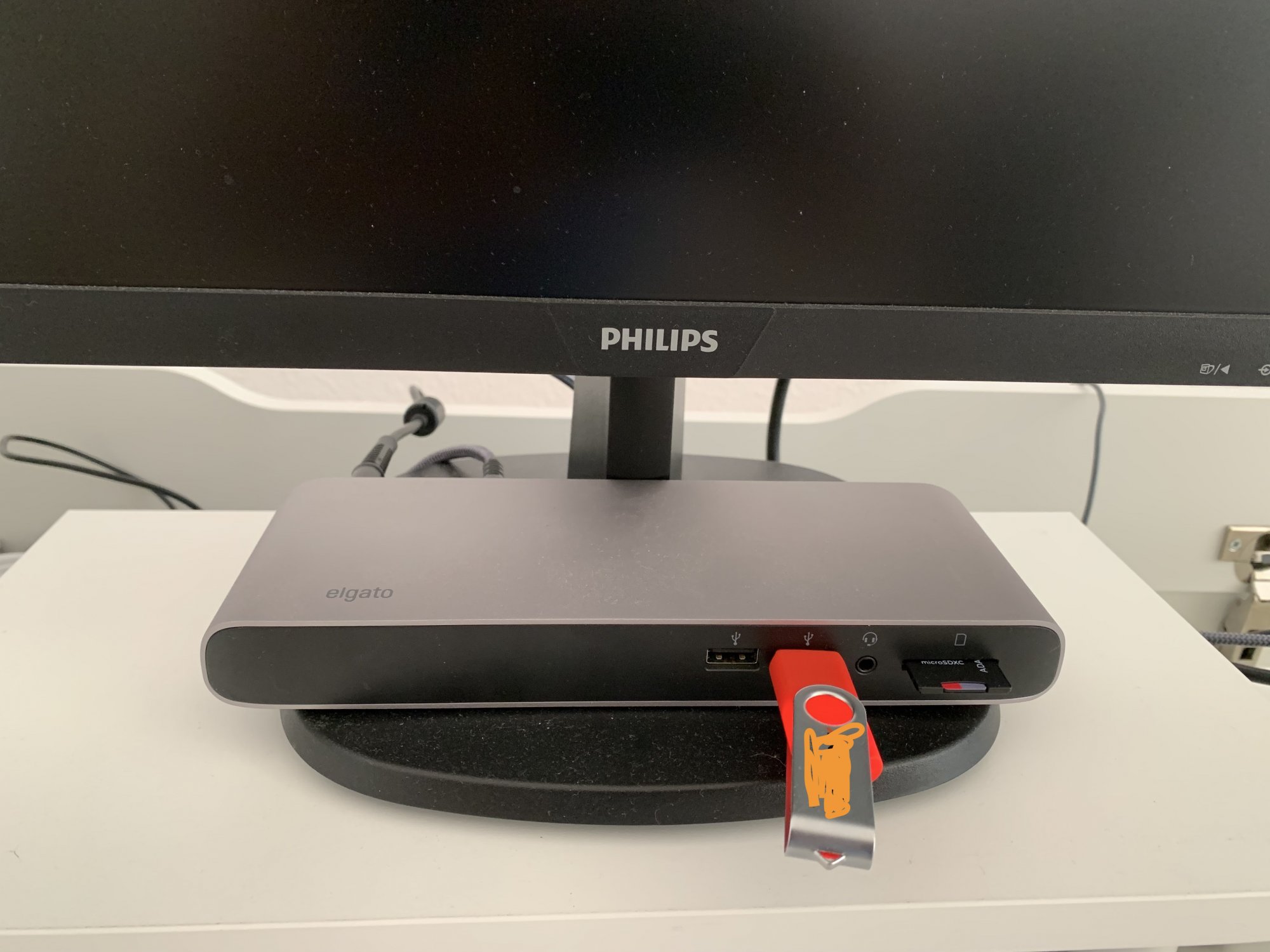

With my case and G-DRIVE Hard Drives. I need to boot up a second time for my Mac Pro to notice G-DRIVER. If you only start it once, you will not notice the Hard Driver from the Finder. You try to boot again when at the Login screen
