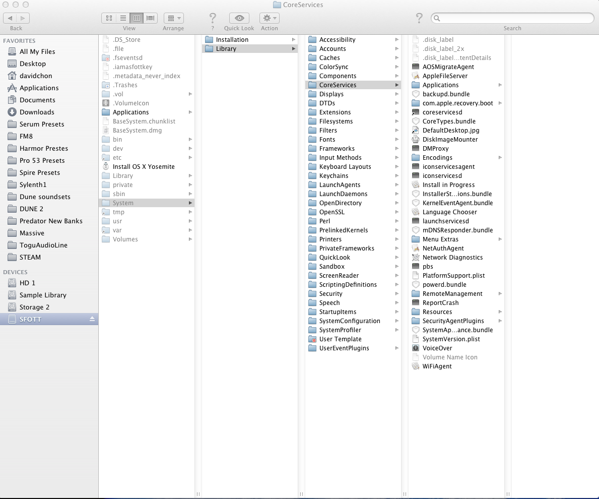

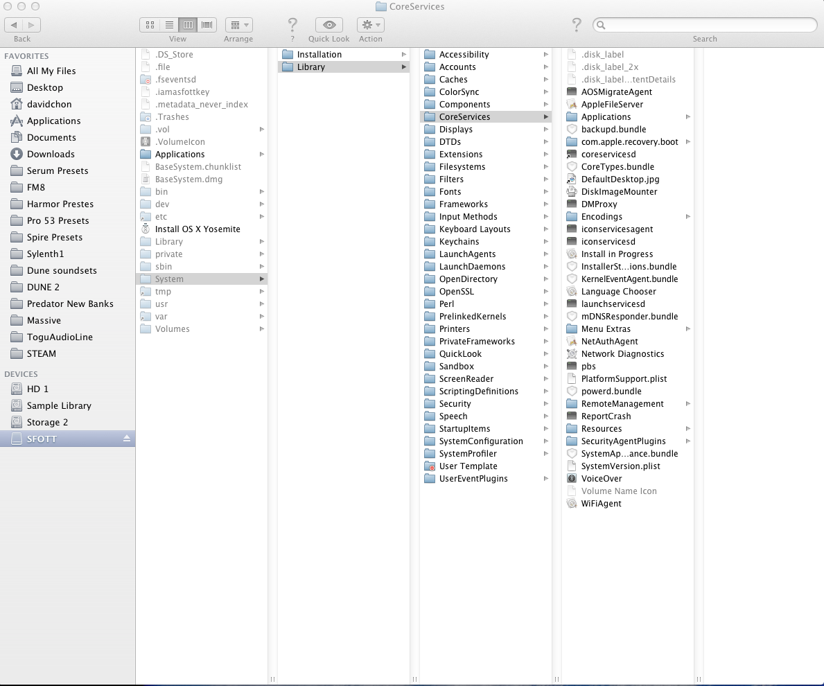

Hi wolwerine I was able to find the hidden files on the STOFF key but I don't see the "boot.efi" file
This is far as I got. What am I supposed to replace?
