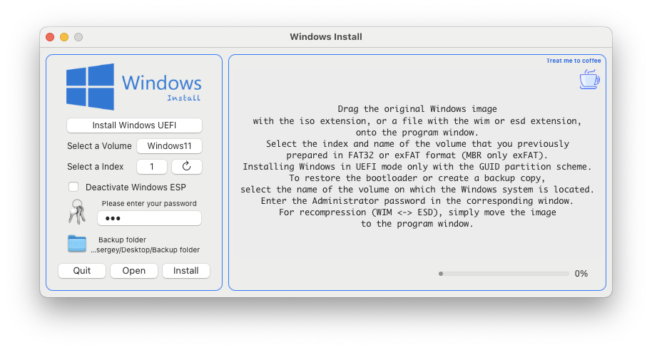

Unfortunately this is more common than you think. Having autounattended.xml inserted will help a lot for any system admin that can't have a MDM to do the job.
Added the option "Copy file to an NTFS volume". It will be possible to add any file to the NTFS volume, for example, Bootcamp drivers, this allows you not to use a flash drive to transfer drivers. This is also the second way to copy unattend.xml.

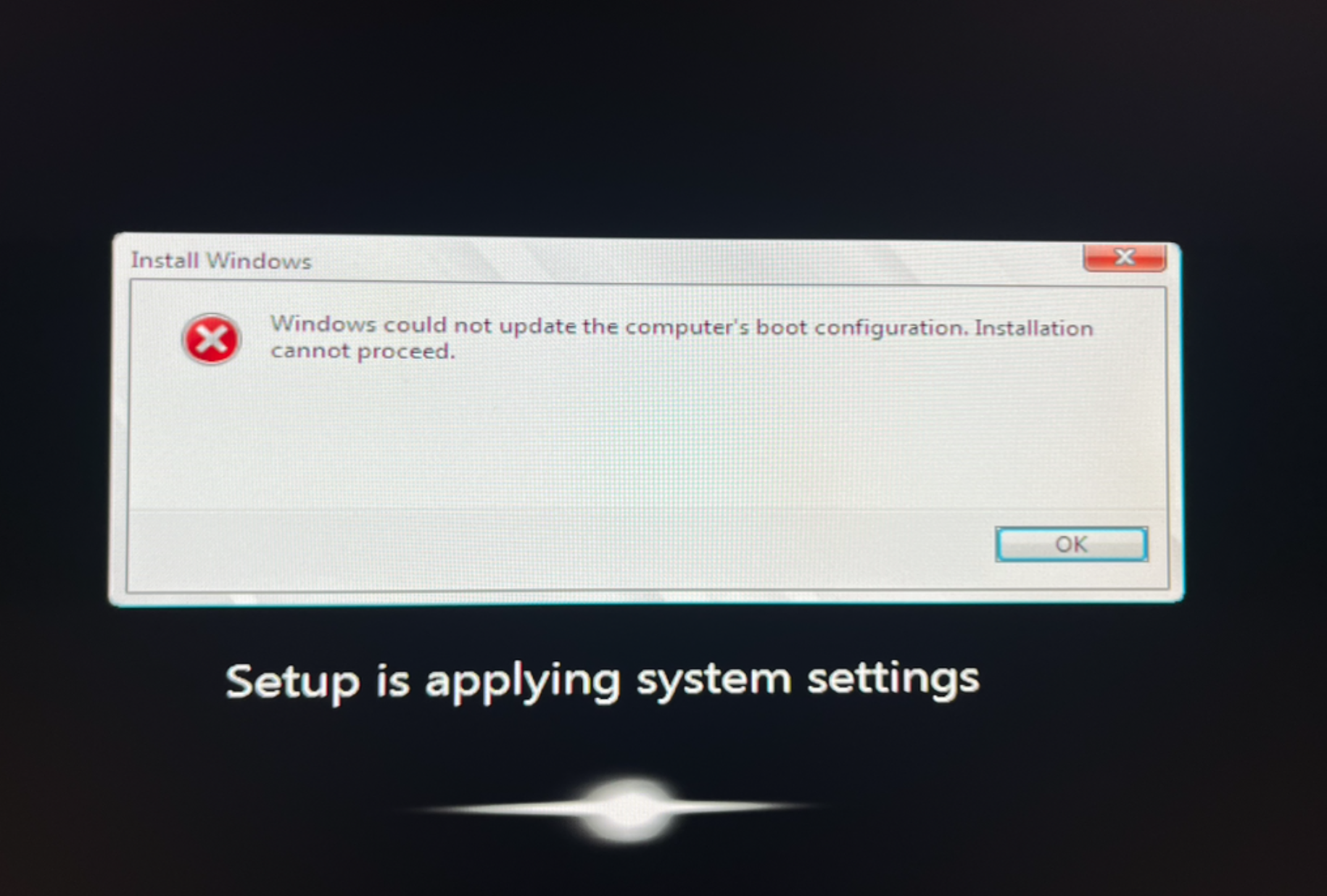

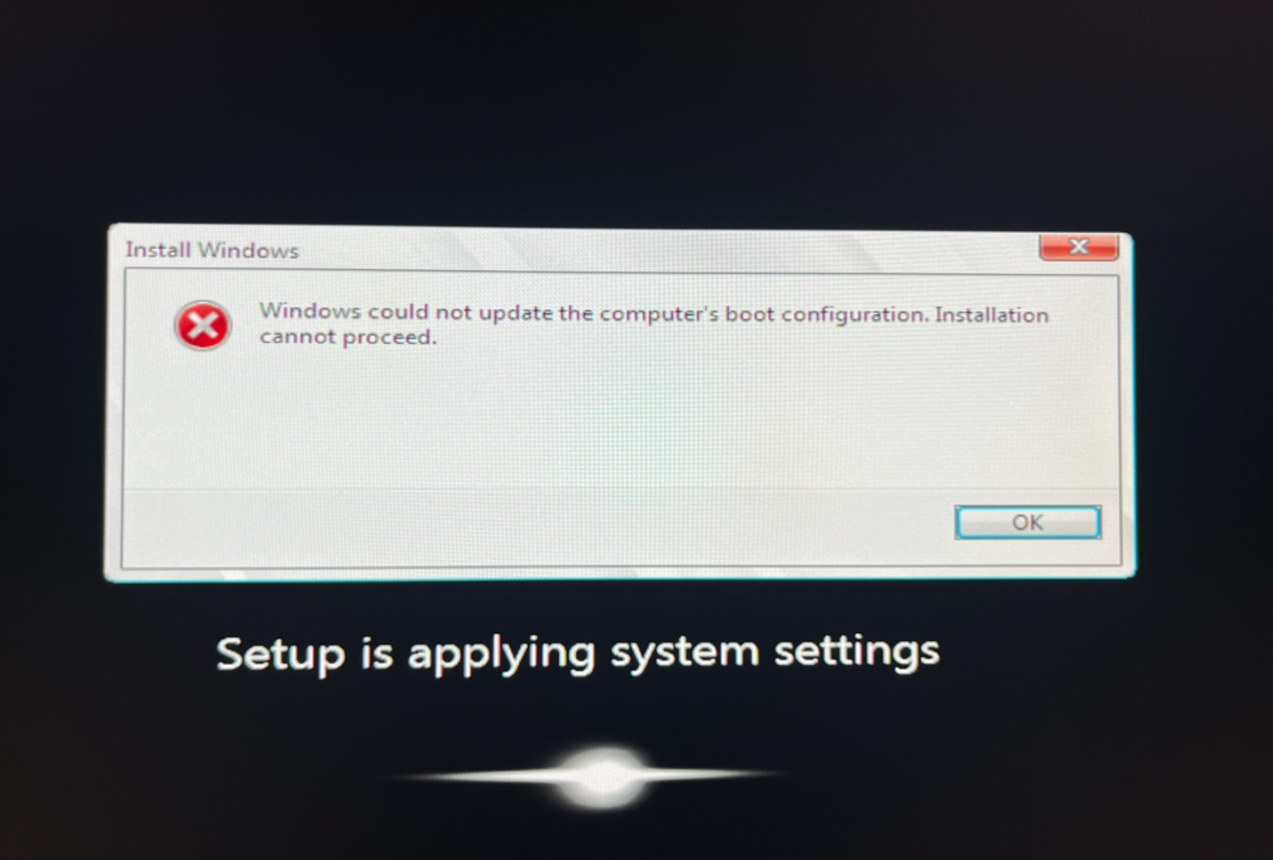

I'm trying to figure how to use the Windows Install tool with a Win7 ISO on my Sequoia install.
I've tried a Legacy Boot Install, then copied over the Legacy boot folder to the root of Windows Drive.
This is eventually my error after booting the Windows install partition...
Do I need to copy the BC drivers to the Windows partition before first boot? I have the 5.1.5621 Bootcamp Driver pack downloaded.
Happy to start over and post a log to see where I'm getting goofed. I can make a Sierra or High Sierra Installer to help format any disks, but I'd prefer not to make a full HS install.
This is a log from install today on freshly-erased MBR disk.
Everything look ok from an install standpoint?
I can rsync the Legacy Boot folder on the desktop over to the Root of the Windows partition and attempt to boot?

You mentioned previously that you got that boot configuration error on an install. Do you recall how it was resolved?
No. Another error was "Failed to install hardware", but sometimes after installing Windows 7 it was gone and I could get to the desktop. Maybe I needed to disconnect the SSD drive with Mac OS, I don't know what the problem was.
I went the DVD install route, works as intended. Not sure why I couldn't get the install with the app to work.
Perhaps the bootloader for Windows 7 is missing something. If it is not difficult for you, take a screenshot of the folders and files of the root volume, having made the system files visible before. And please upload the Boot folder here.

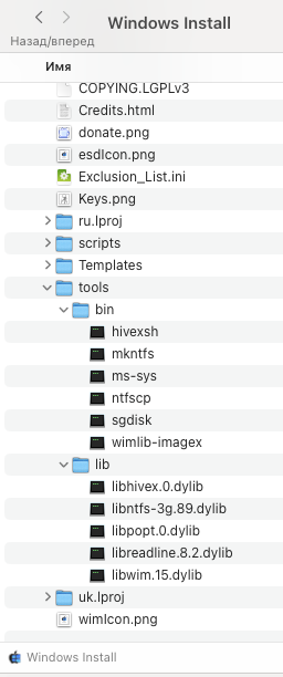

I use libraries and utilities inside the program, I made them dynamic. Wimlib works with an unmounted NTFS volume and cannot transfer attributes if I install them in MacOS. In systems up to MacOS 12 I use Apple's own NTFS driver was available and the SetupComplete.cmd file with these commands was copied, and this solved the problem.
Change in the program menu: Do not set the disk and partition number, but select the volume name. The "Update volume list" button. In the "Restore EFI bootloader" mode, the "OpenEFI" button appears, which allows you to open a hidden EFI partition to check or delete the Windows bootloader.
