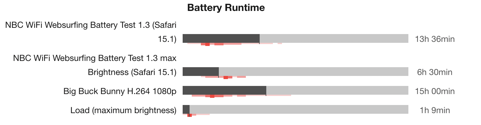

In my uneducated opinion These are the first consumer chips that can give both. Sure scaling and cores matter but M1 series is the first where you can have very high performance and at the same time have very high efficiency and thermal profiles. So now you can do serious tasks for a long time on a battery which before these chips was simply not really possible.
I like the design of the M1 Pro and Max because they are suited perfectly for the use of each. M1 Max gives about 50-80% worse battery life than the M1 Pro under heavy load but makes sense because of higher bandwidth, more memory and more GPU. Both give huge battery life considering the performance.
Intel doesn't have any faster CPU's at the moment. Certainly not in the mobile space. And while their cpu's are not faster they are much LESS power efficient. No matter the metric Intel cpu's lose. Alder Lake is not out yet. Once it is and it is implemented in real devices we will see. One thing is for sure the M1 Pro and Max out perform on both performance and power and heat efficiency. Intel Alder Lake which is not out for consumer products yet under very specific conditions using desktop processors probably water cooled beat the M1 Pro and Max. That really doesn't bode well for Intel. At least for right now...
Here are notebookcheck's battery tests on the m1 pro. Definitely more efficient than say a similarly powered gaming laptop unless under load
