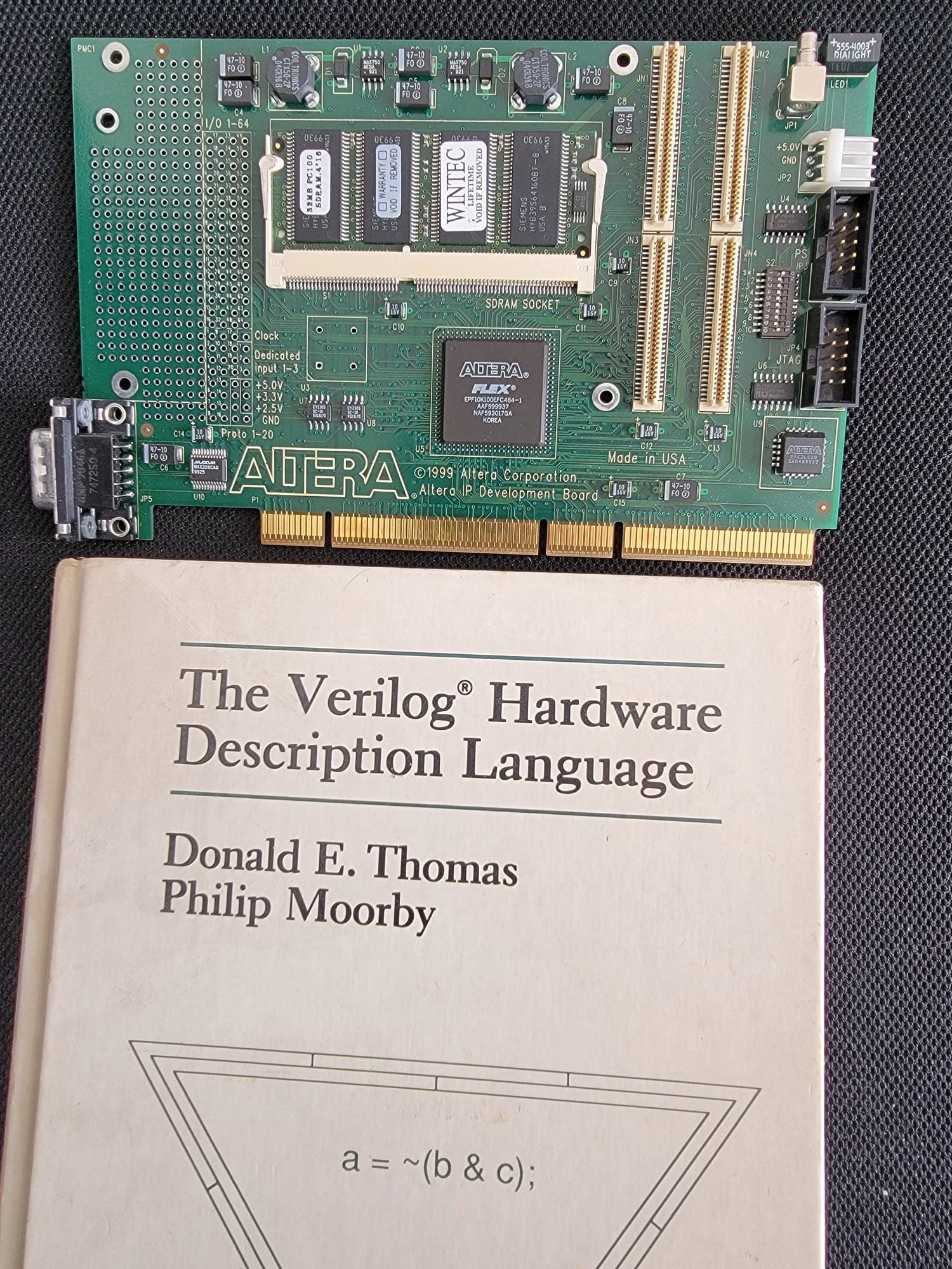

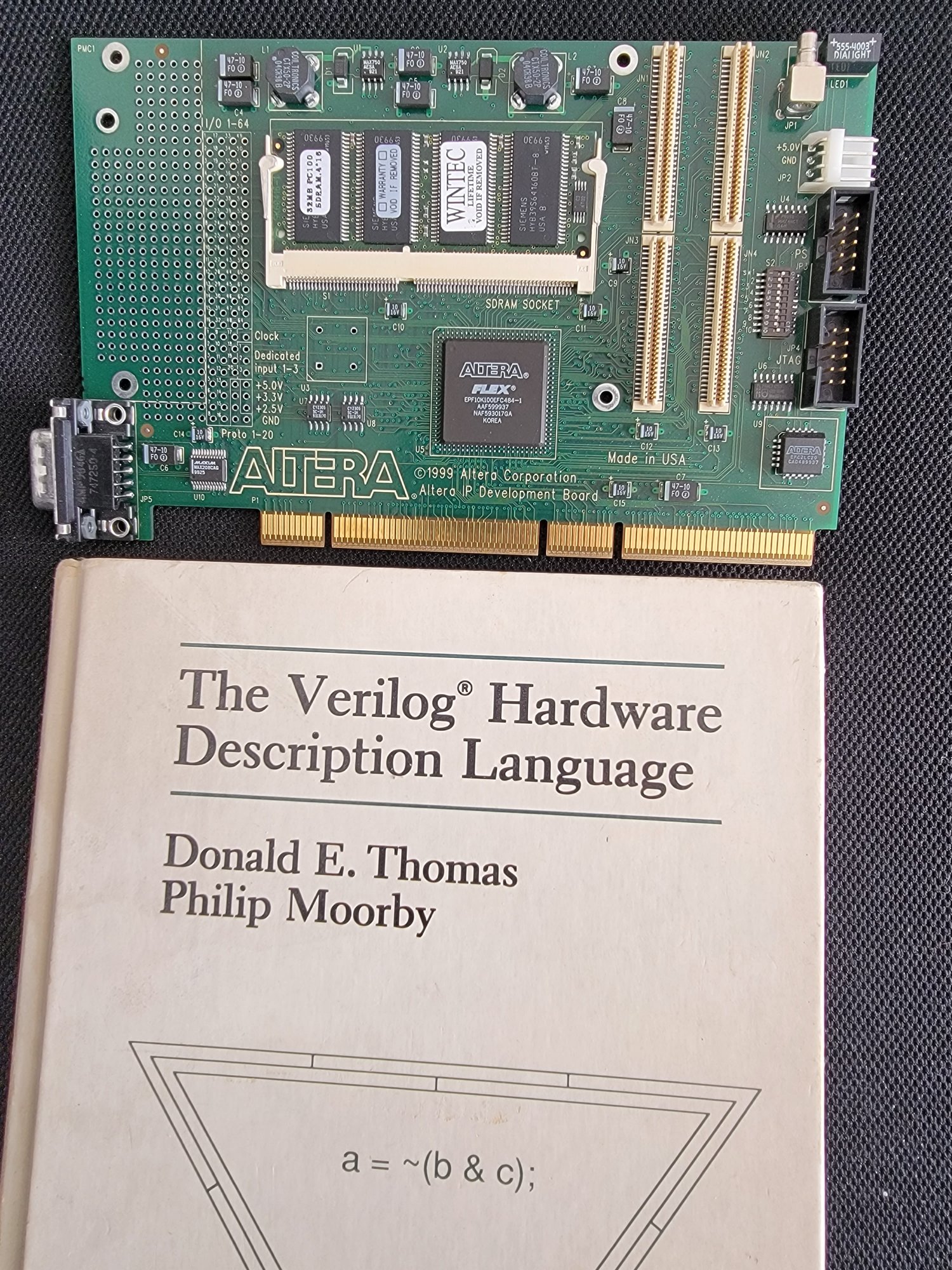

Not everyone is a first time user. Add-on board is archaic though so prefer on-chip plus near future is speech to code.
