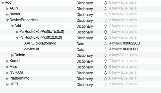

use opencore to spoof the Device ID of the intel HD 4000 to intel HD 3000's device ID
while messing around with an old Acer laptop I had some limited sucess in doing this
(in that for Hackintoshes not even HD 3000 ever worked in Snow Leopard, but, in spoofing HD 4000 like 3000 I was able to get the same failure symptoms, so on a real Mac it might just work)

@LightBulbFun What platform-id/device-id did you use in your opencore config? I've tried a few different combinations and it does change the device ID under System Preferences but I haven't been able to get any further support yet.
