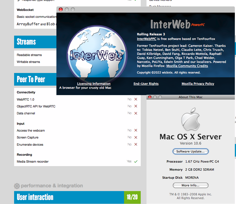

I got a notice saying that WebRTC is not supported. I'm on a G4. Is this correct?
Yes. I think @wicknix made mention of this earlier in the thread.
For the latest Interweb-PPC on my PowerBook G4 SL-PPC test mule, html5test-dot-com reports the following:
Noted. Is there a way to re-enable that? This may be a fast fix to restoring video chat.
I had a quick look at the last TFF 7400 build, and it reports the same. However, "access the webcam" is permitted.
Sure. If you want to do it for yourself. ;)
It's disabled for a reason, but if you really want it enabled grab this package and install it. From there you could just build TFF with the latest patches as it has webrtc enabled by default. Or build IWPPC, but you'll have to wait until the toolkit extracts IWPPC, then ctrl+c to kill the script. Then go in to the build directory and edit the appropriate mozconfig (g3/g4/5) and change the line that says "--disable-webrtc" to "--enable-webrtc". Then restart the build script and wait a few hours.
